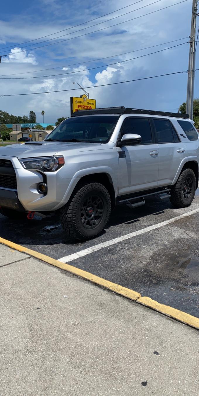

I also have some questions on the KDSS system and what y'all would recommend in my situation. I'm not sure where the right place to post this is but it is pertaining to KDSS specific 4R's.
I have a 2018 TRD OFP I got with 20k miles on it - came with the TRD Bisteins on it - I wanted to get a lift without replacing the whole system for now. I ordered the ToyTec +2 kit specific for the TRD Pro Suspension system. Curious if I will encounter any issues once it's installed being that it's a full on + 2 for the rear on the KDSS.
I also was curious if I could use a slightly larger spacer than is included with the Toytec Kit (order their 1/2 inch spacer instead) would I be OK doing that in the front considering the Bilsteins give me +1 over factory in the front or would that be too much considering I would be adding around 2.5 total on top of what I have currently. I did just add a Lo Pro bumper / winch / light bar and noticed the front came down a tad bit more (I need to get updated pics haha).
I have my lift scheduled for later this month so I still have time to order either the spacer or maybe just a full on new coil over for the front lift. Open to suggestions and any feed back would be greatly appreciated - last thing I wanna do is regret not asking y'all now. I'm new here but have been hounding the forums ever since I picked this up a few months back. Thanks for any help, y'all rock!
