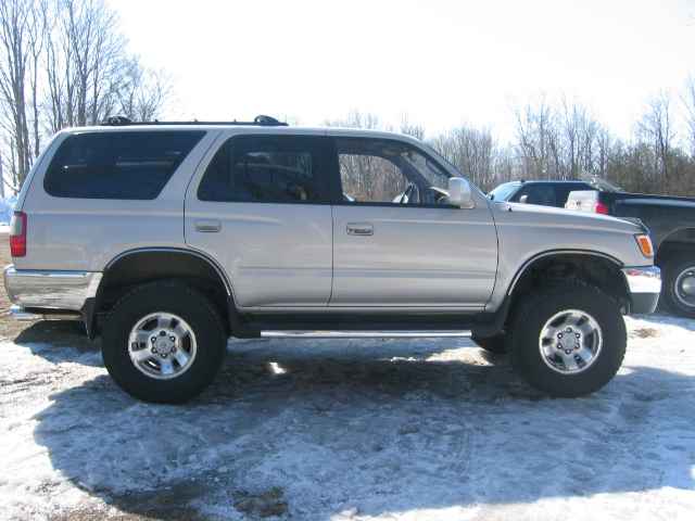

Are you installing it yourself? Take some pictures before and after.
I have the daystar spacers right now, and I have had zero problems. I live in colorado as well, and in the summer i'm on 4x4 trails every other day riding my bike and camping and they've done well. The front end is much stiffer and doesn't give as much articulation but that's what you get when you go the spacer route. If your looking to stiffen up your rear you may want to just buy the front end lift kit and then buy stiff rear coils from ome. I believe the 892 is their tow/heavy load coil and it also provide approx. 2.5in. That's the route I wish I had taken in the first place.
