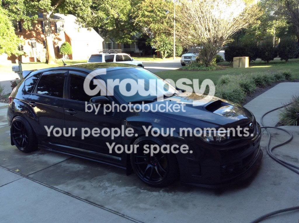

I am the proud owner of a 2005 Limited. I purchased this around the end of February after a month long search after my 3rd Gen was totaled on Xmas eve. :sad: I come from a long background of modifying imports and this will be my first 4x4 project. Here is a picture of my previous ride:
2010 DGM STI Hatch - Stage 2 :cheers:
you can see my 3rd gen in the background... ;(
