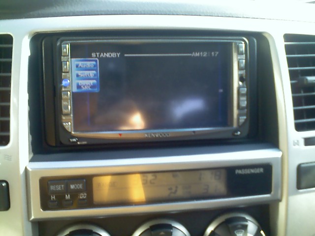

I already install Kenwood DDX-7017.
It`s extremely nice, fit perfect in 2003-2005 4Runners, sound it`s Great.
Honestly it`s a Good Buy.

When you say perfect fit do you mean there is a kit designed for the ddx series? I ask because I have my 4r down at Audio Excellence in Orlando now for 2 days for a 5 hour install (that is what they first told me). Now they say it is taking so long because there is no 2din kit for my DDX8017 and they are having to build a 2 din kit out of a single din kit. I think they might be b.s.ing me because the 4r is already designed for 2din radios. Any thoughts?

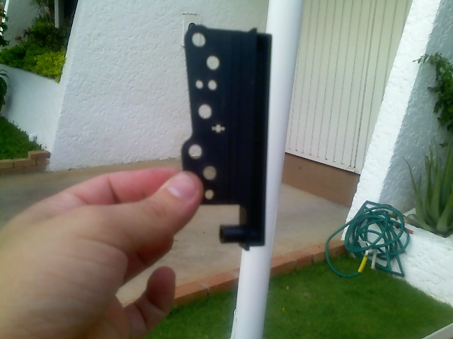

Your Headunit is a 2 Din so you dont have any problems to install and it fits perfectly.
The only problem that you may have is if your HeadUnit doesn`t have the plastic bases in the sides you will need to buy in the Toyota Dealer or take them out from an Universal Installation Kit.
In my Country the 2003-2005 4 Runners comes with this bases but the 2006 come with a Headunit thats wider so you need to put the plastic bases if you replace the OEM Headunit.
The Japanese Cars usually comes with 2 Din Headunits.
The DDX-8017 its the Top of The Line for our Trucks so you made a Good Choice.

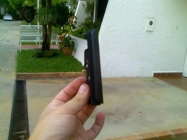

I took the pic with my cellphone , if you want a better pic please let me know........
Trim pieces Numbers:
86221-52050
86221-52060
Remenber my car is a Japanese Version, so i suggest that you check the part numbers
Good Luck !!!
