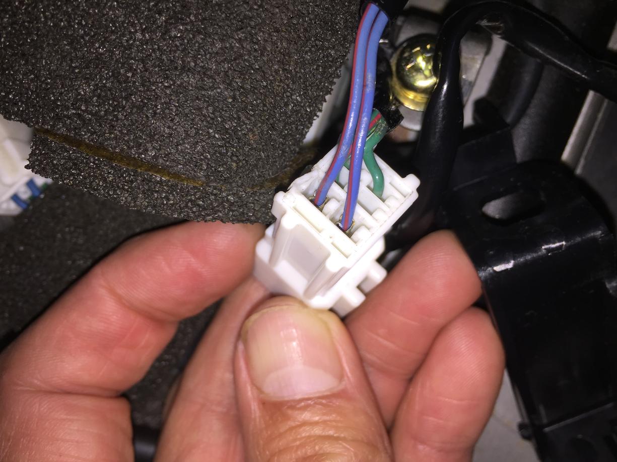

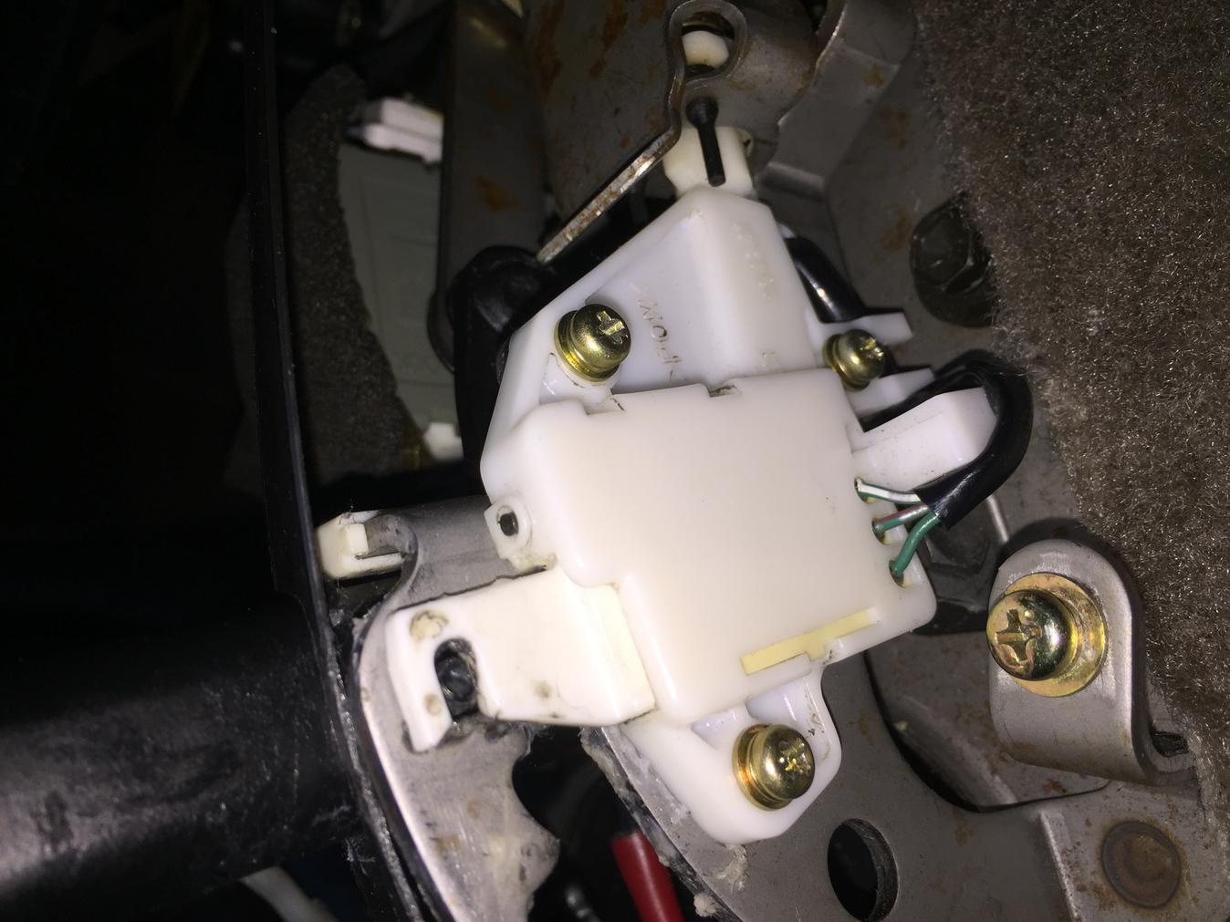

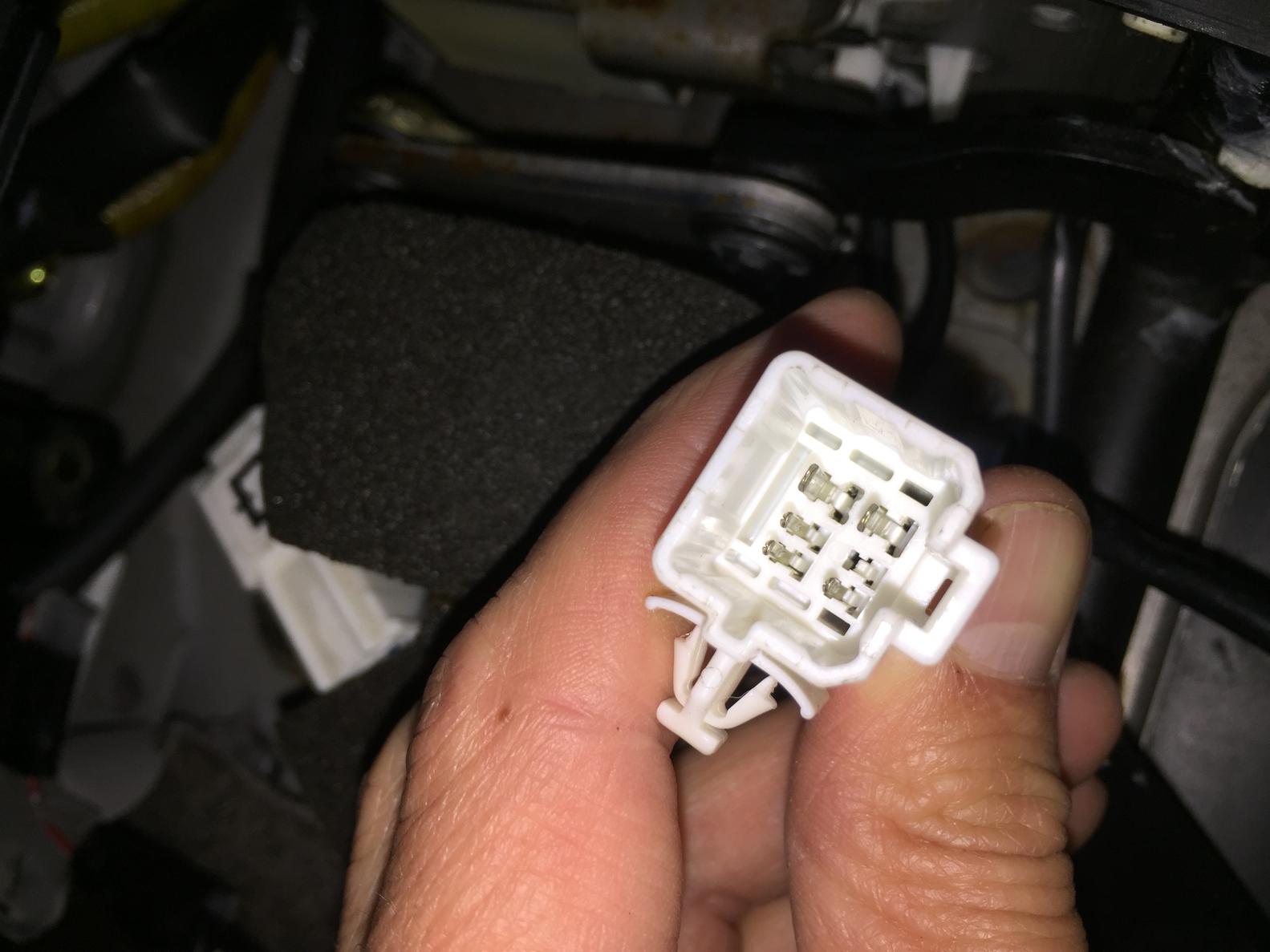

Hi guys. I have all the parts I need and was in the process of replacing the shift interlock switch. My problem should be simple. There are 2 wires that are connected to the old connector that must be removed and reinserted into the new connector. They are the blue/red wires. Normally you would use some type of extraction tool to bypass the locking tab to slide the wires out the back. I have tried and have had no luck. Is there a specific extraction tool for this connector? I can't find any help on this. Thanks. See the pictures for greater clarification.
