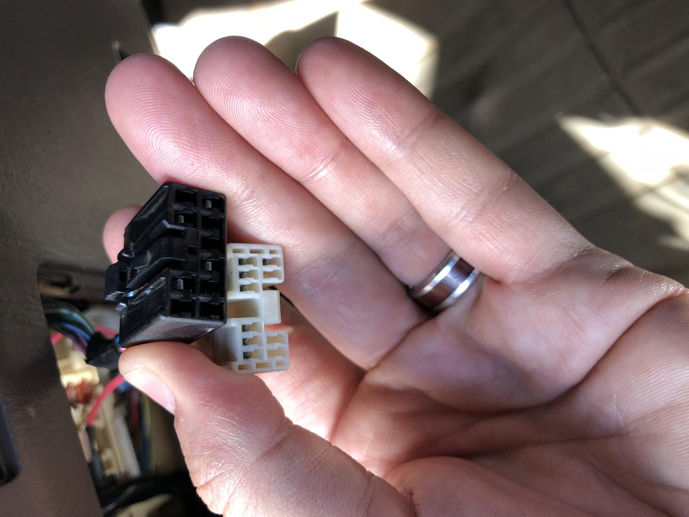

Sorry I am reviving this but I just found the chirper on my 2000, bout to order these fobs https://www.amazon.com/gp/product/B00KTHYCEO/ref=oh_aui_detailpage_o00_s00?ie=UTF8&psc=1 (2 for $20 seems like a great deal) but was wanting the full “look”. Do you happen to know if having the chirper means you have the factory installed option or the rs3000? I want to get the right security light showing it’s active when active or would either work? I did notice under the fuse panel in the cab there is a pig tail or 2 just sitting there waiting to be plugged into something!
Having the chirper just means you have wireless door locks; it says nothing about security. If you have a chirper but no light, odds are you have wireless locks but no security system so just adding the light will be no help.

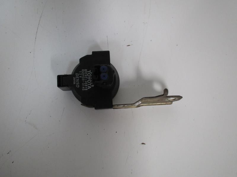

i have a 1999 limited. i have the chirper and on toyota.com the stuff listed that came with the truck was a convenience package that says wireless entry. I dont have a security light. i have tried million times manual and just the button i can never get into programming mode.
i replaced the driver actuator because it was slow. the other doors stop working after two or three unlocks. would they matter?
also when i first bought it there was a code for incorrect code on body ecu or something but i forgot what it actually said as i cleared it. i have what looks like an original key. clear title.
i then looked in the back and the orange box in the door and it was there but missing the bracket that holds it to the door? could this have been replaced and wont communicate with something to get into programming mode, this whole keyfob thing is pissing me off and i cannot find anybody with a similar problem.
So I would need to source a RS3000 and the light and make sure I have the wiring in place? I got the remote the other day and was able to program them so I have lock, unlock and window roll down now!
