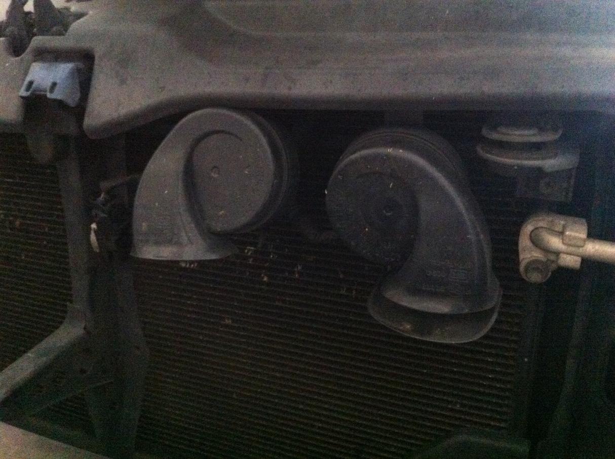

Like the OP, my used 4Runner honks any time I lock or unlock it. I looked under the hood and didn't see anything out of the ordinary (not that i'm real familiar with 4Runners) except there were what looks like 2 separate horns, and I didn't know if that's normal or not. Is one factory and one aftermarket? The only difference I saw was that one had a 400 on it while the other said 500.

My Runner did this from factory and I wish I could find a detailed wright up on disabling the horn honk. I read people saying how to do it but they are extremely vague. The most I got was "with the key in the ignition and the door open, flip the switch on and off 3 times." ..... right witch switch???
