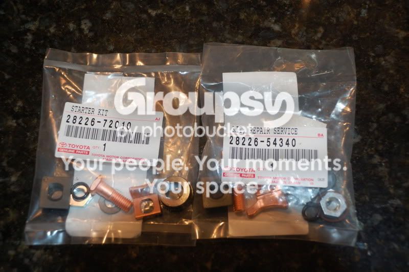

I'd give the starter contacts a try. The parts are very cheap right from the Toyota parts counter. I only did the contacts and just filed the plunger smooth. Works perfectly. I just removed the starter and replaced the contacts while it was still in the engine bay. Took about a half hour if I recall correctly.
Here's the parts I used:

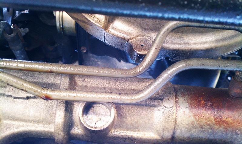

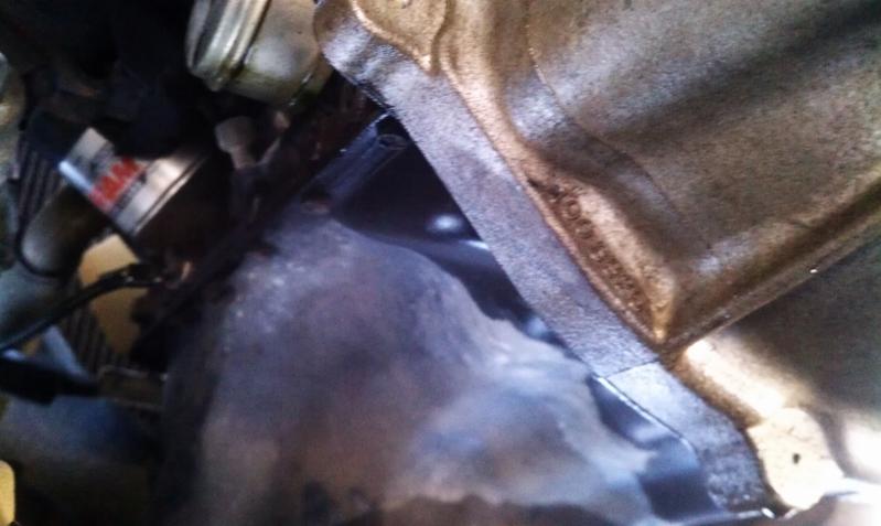

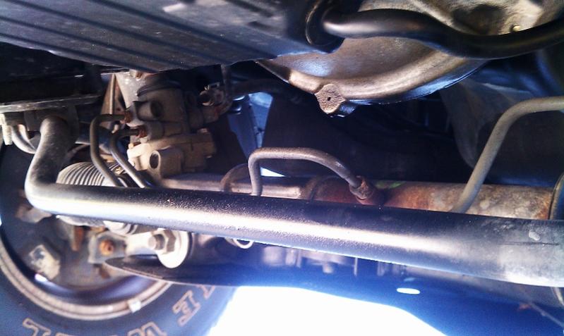

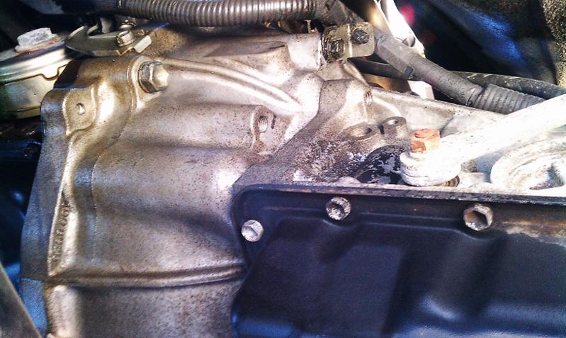

Hey guys its been quite awhile since I have done anything to the truck and I finally took a trip to Toyota for parts. I picked up a water pump, timing belt, coolant, and starter contacts. I crawled under the truck to plan out the starter contact swap and noticed a leak. My first thought was rear main seal. I thought I would post up some pictures and get some of your thoughts.
Anyway..here are some pictures of the leak

I just had my valve covers done about 2,000 mi ago. I will start high and work my way down the engine to see where I end up. Thanks
So I followed your suggestion Kball and started from the top, down. From what I could see of the valve covers looked clean with no leaking, but when I reached around the back of the motor I found the leak. The back of the driver-side valve cover is leaking. I had the valve cover gaskets replaced not too long ago but I am having trouble finding my receipt for the work. Hopefully the repair is still within warranty...but then again maybe it is a sign that I should do this one myself.
Does anyone know how long of a repair this would take, ballpark for someone with medium mechanical skills?
