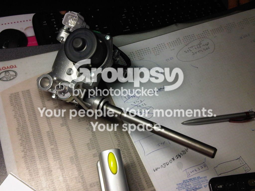

First mod came quickly...4WD stuck in 2H...so i made PhD in 4x4... on these 4 runner and get it started working:)
TCASEmotorfor96TOYOTA4WDSR5.jpg~original

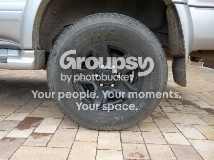

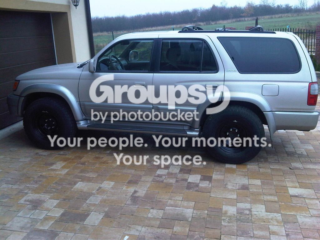

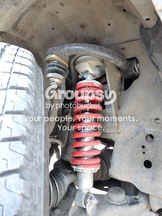

Soon with a help from my friend from this board - Tucson4Runner - I was able to buy from US some parts like suspension and other. Mounted it...
toyota1004.jpg~original

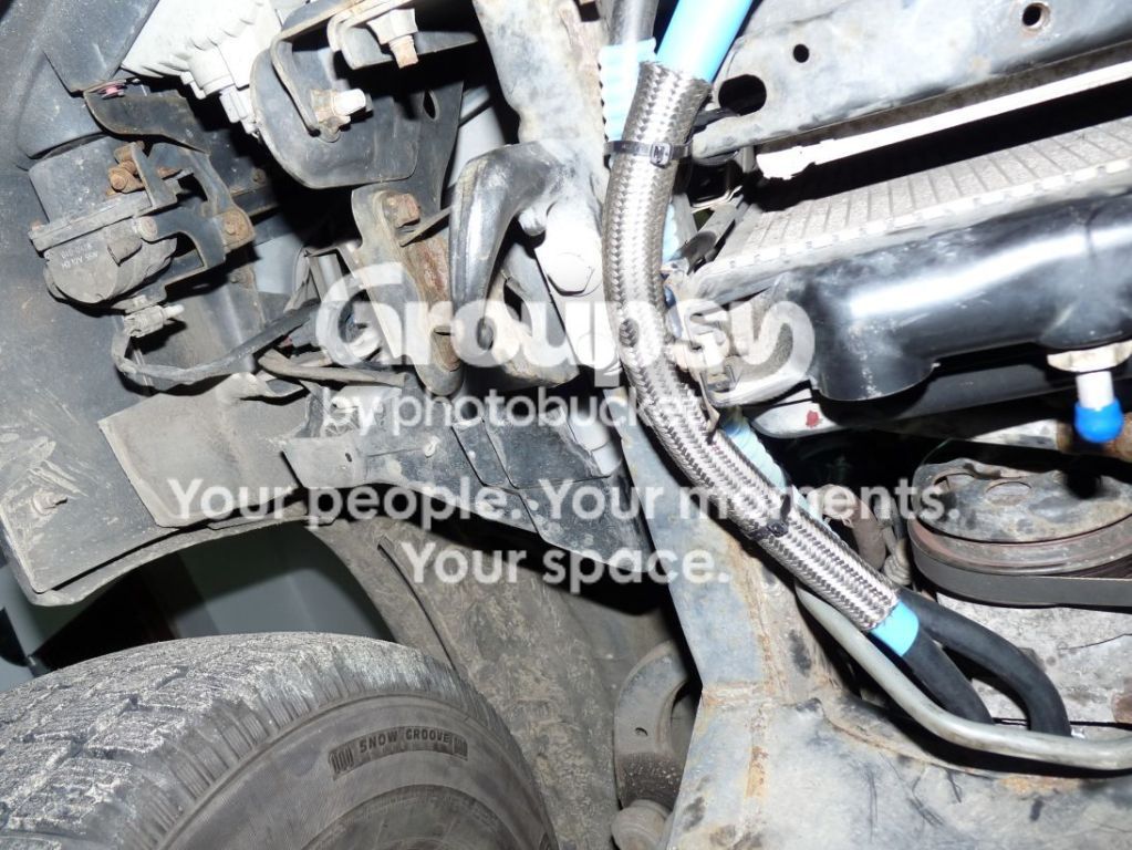

...and of course tranny cooler from B&M
coll4.jpg~original
coll2.jpg~original

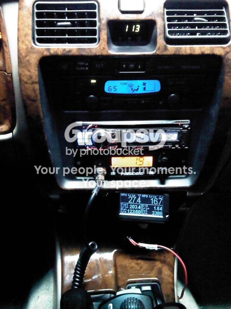

Next move was interior: dash light were not working so I ordered leds from one of the suppliers - and result is niece and bright:)
toyotamainconsole2.jpg~original
Buying ScanGauge is a good money spending - used several times to cancel check engine (LPG installation makes computer stupid)

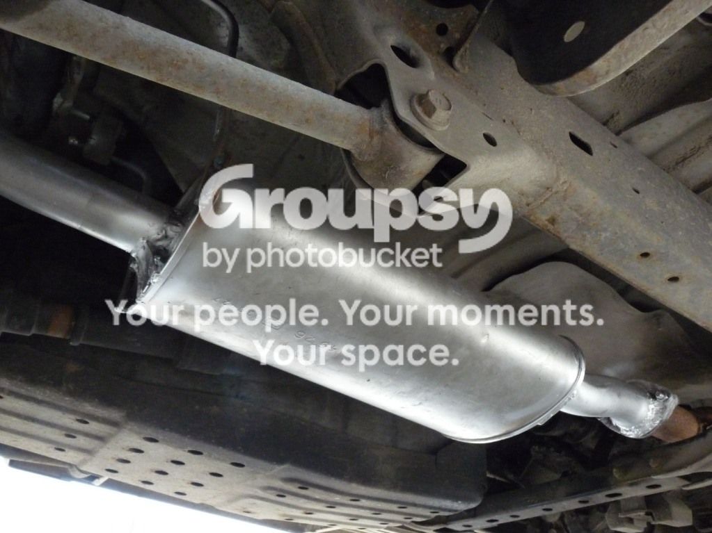

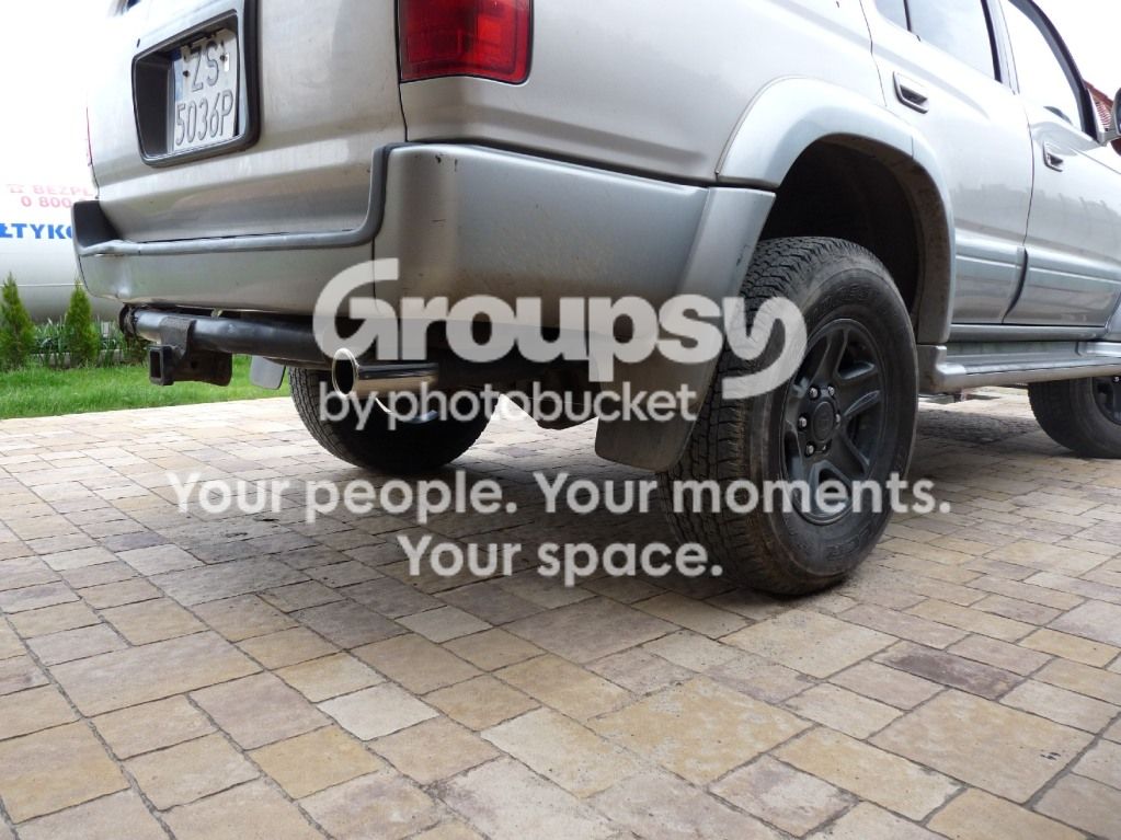

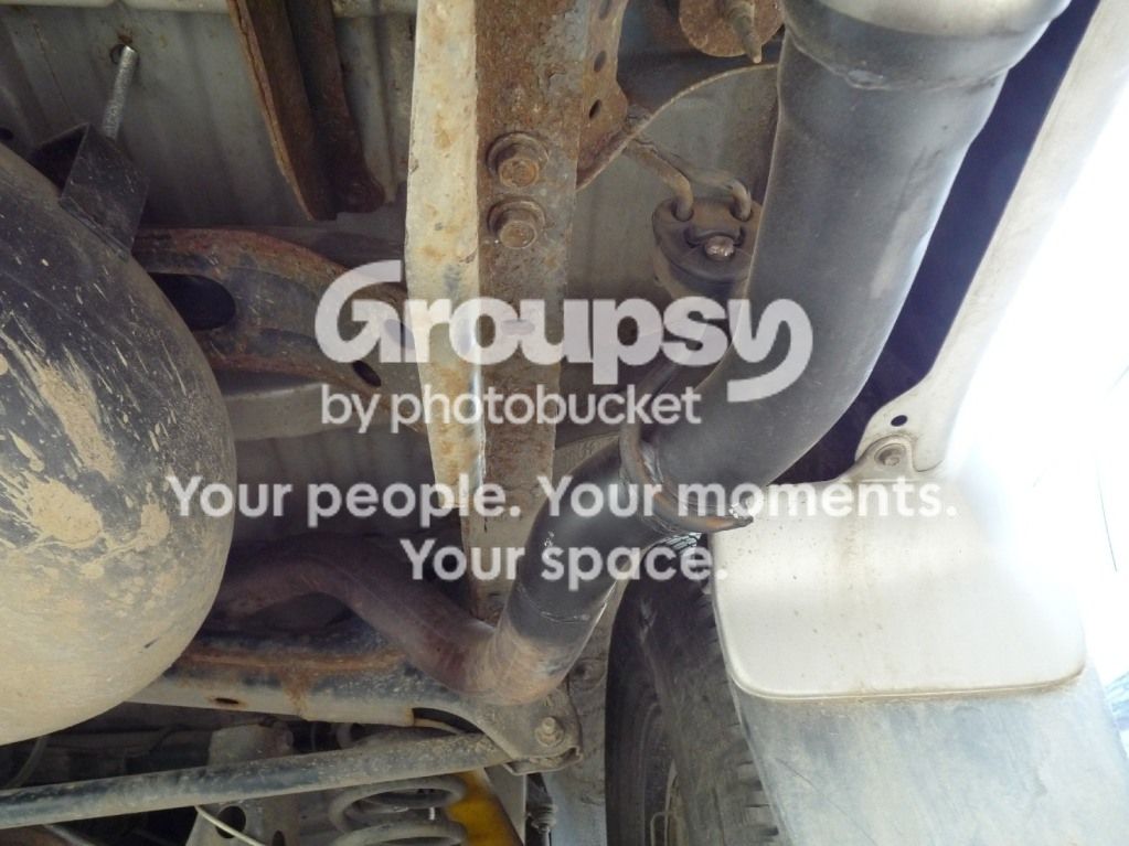

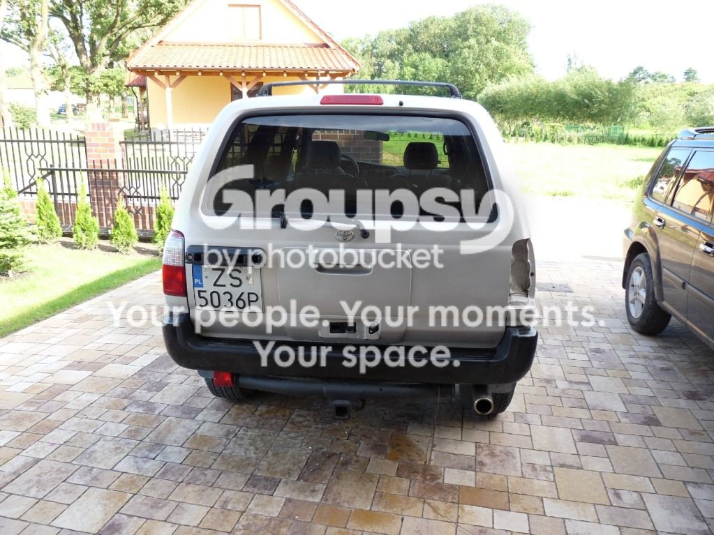

Exhaust was over (was it original? - dont think so) and in Europe its prohibited to have outlet on right side - so this change was necessary.
toyota1012.jpg~original
toyota1011.jpg~original
toyota1010.jpg~original

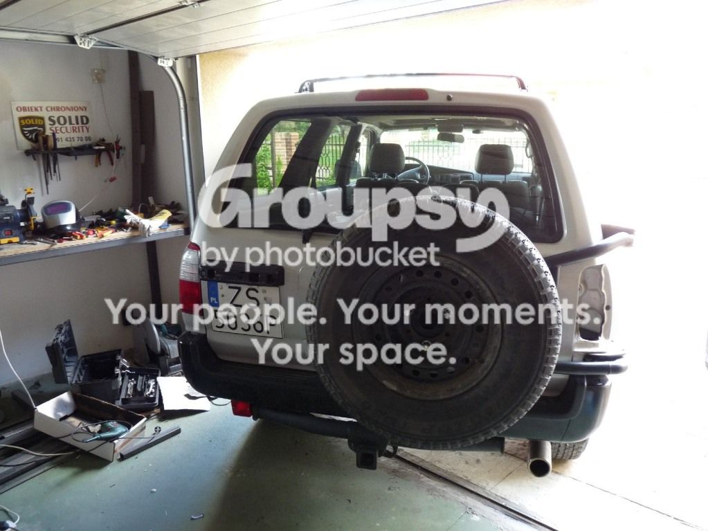

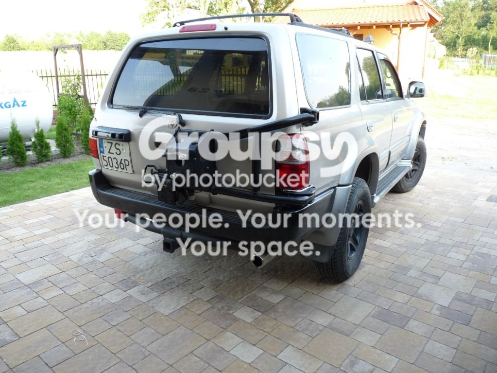

In UK and Japan it was possible to buy HiluxSURF (i.e. 4Runner) with the wheel hanger on the rear. Looking like that. So its my last mod...
images

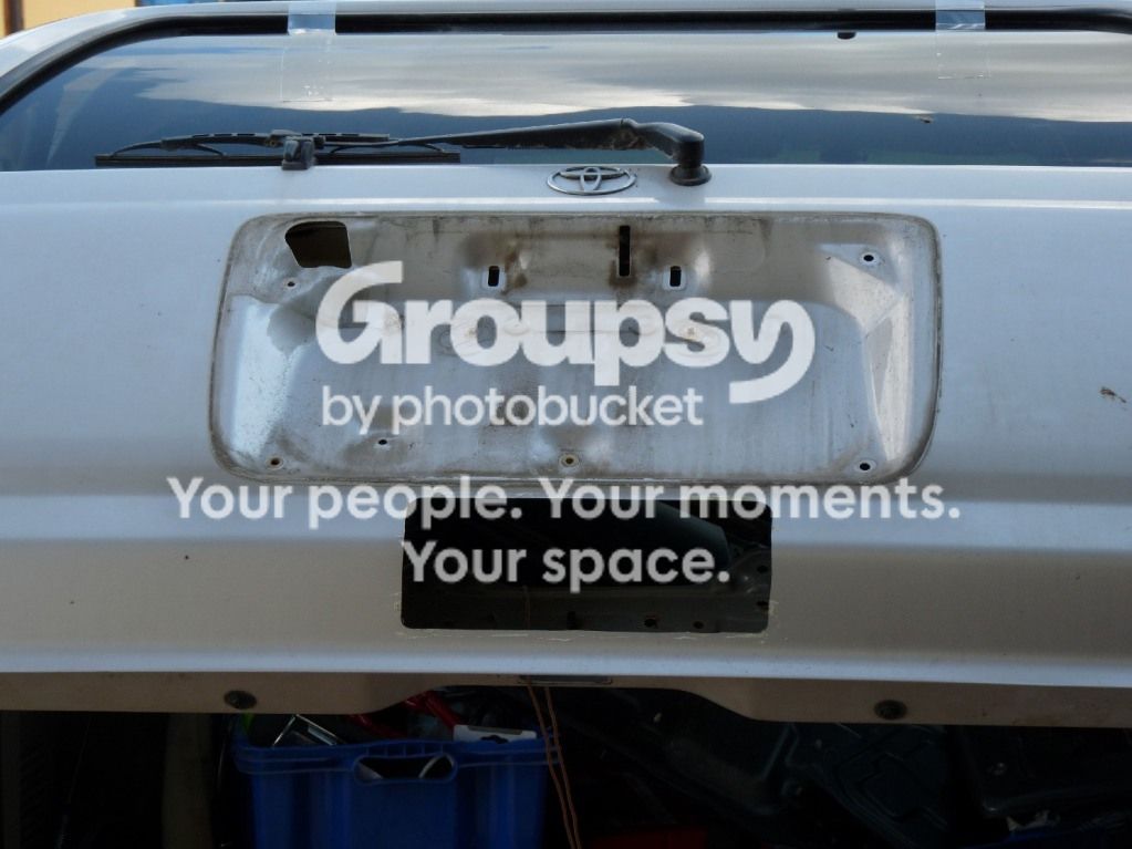

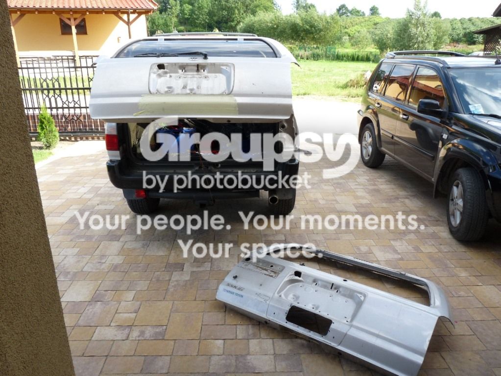

Unfortunately 4R doesn't have proper support on back and rear to hang it. I bought rear doors from English 4R with supports inside and build right ones by myself.
toyota011.jpg~original
next part of this crazy work soon!

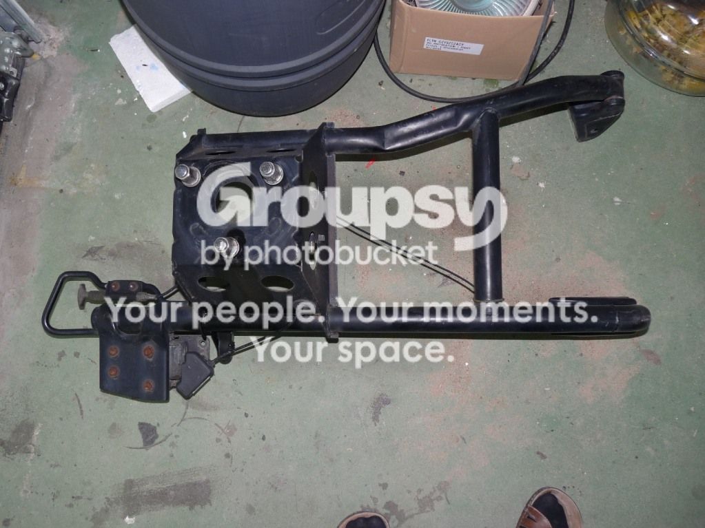

Spare tyre carrier as a whole part.
toyota1009.jpg~original
And final look
toyota038.jpg~original

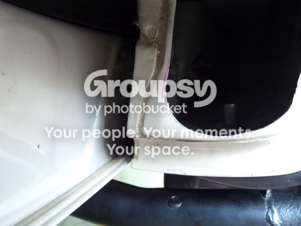

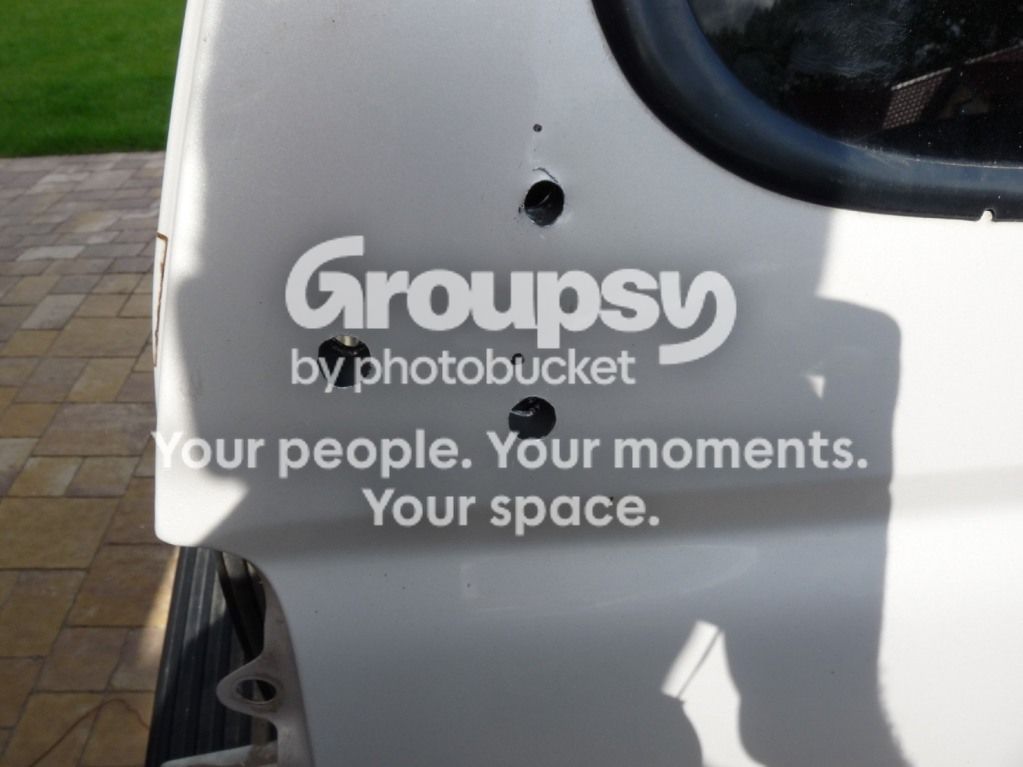

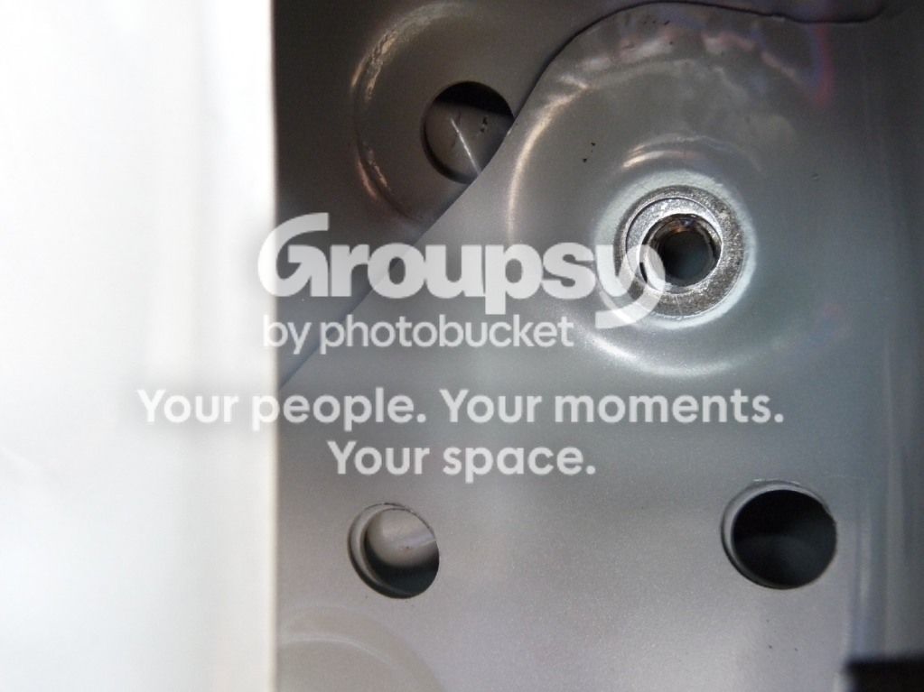

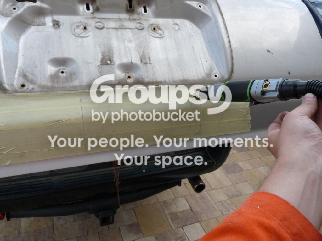

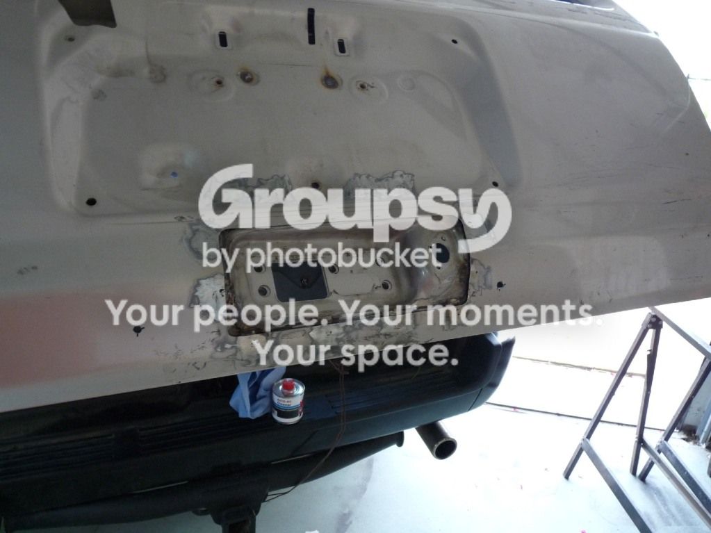

In my car (96 Lim 3.4) Toyota left some stiffner constr. in the body (upper) for this carrier and 3 holes to make life easier
toyota019.jpg~original
toyota029.jpg~original

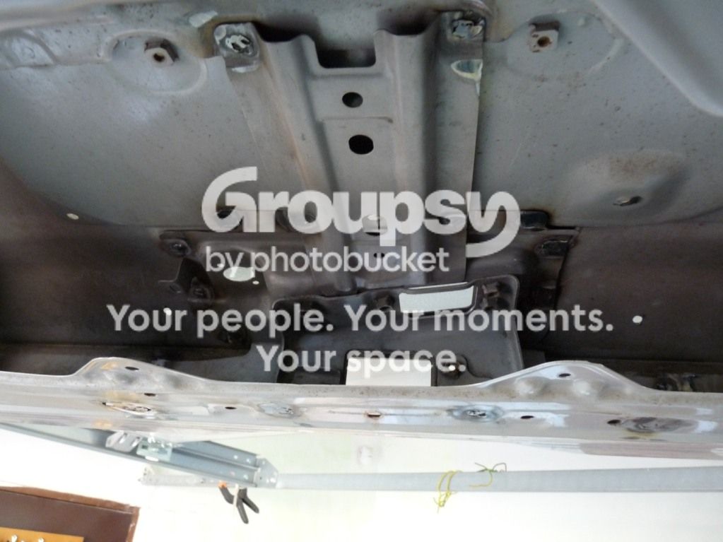

and lower must be done from scratch
toyota031.jpg~original
toyota1032.jpg~original

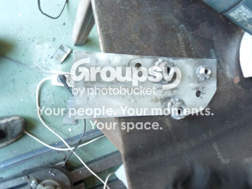

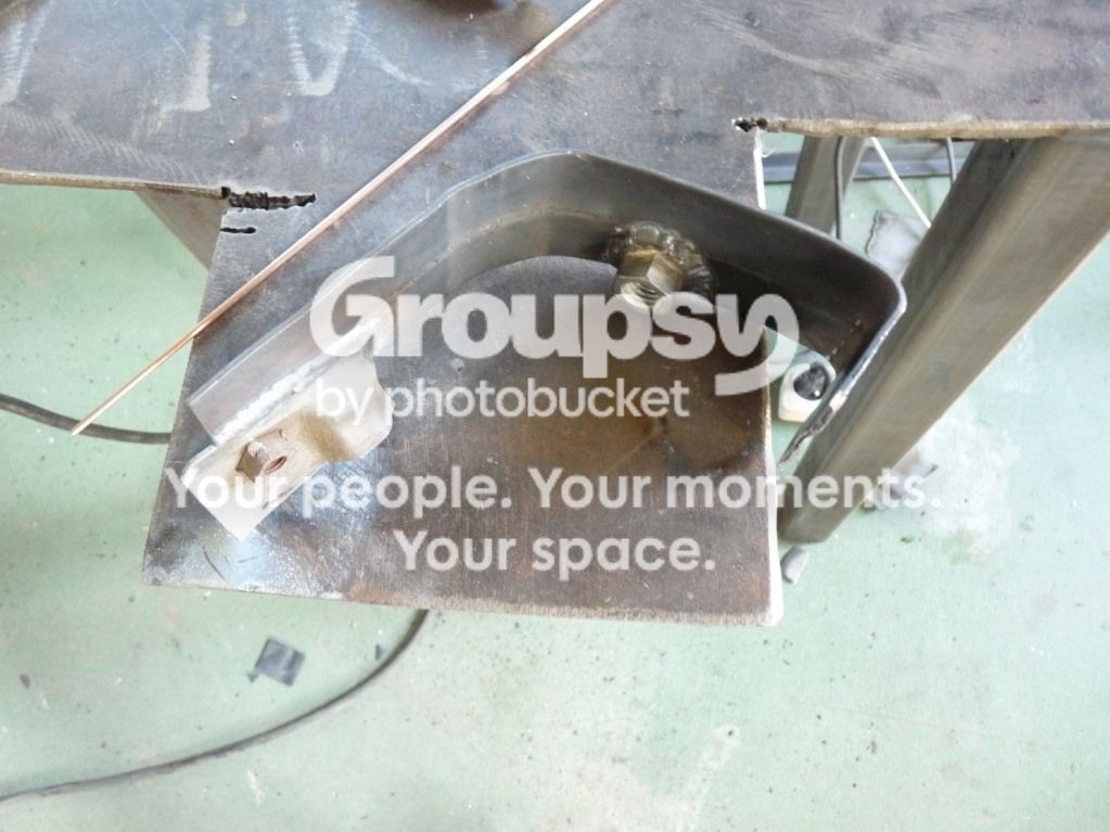

some cutting and drilling and welding:
toyota1036.jpg~original
toyota013.jpg~original
toyota014.jpg~original
toyota015.jpg~original
toyota016.jpg~original
fitting and refitting...

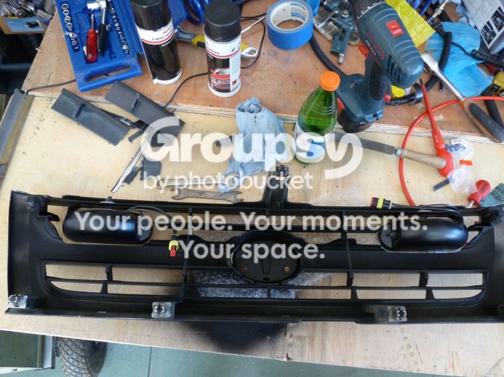

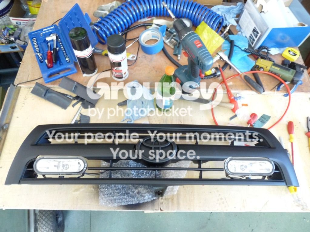

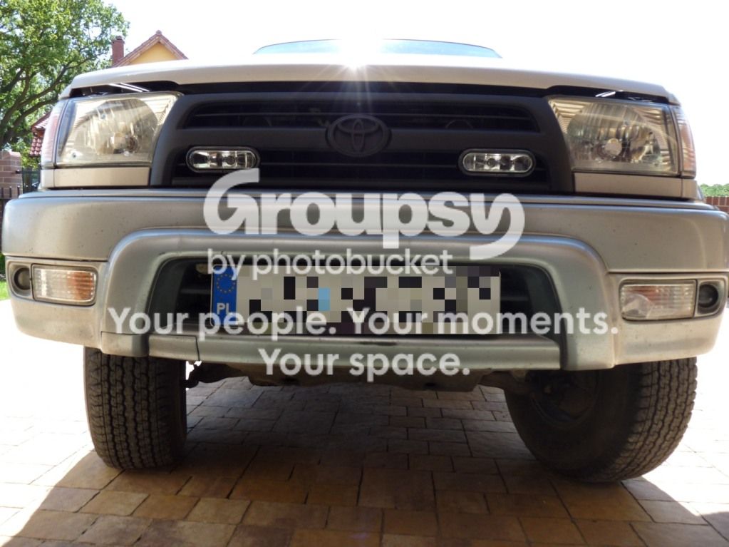

So bein bored of lazy sunday removed grille and paint it a bit, addin extra highbeam lights Hella FF 75.
front1.jpg~original
front2.jpg~original
So the final work is...
front3.jpg~original

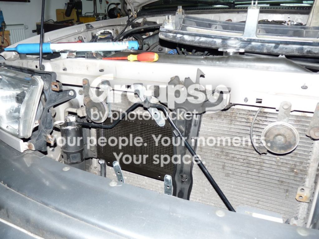

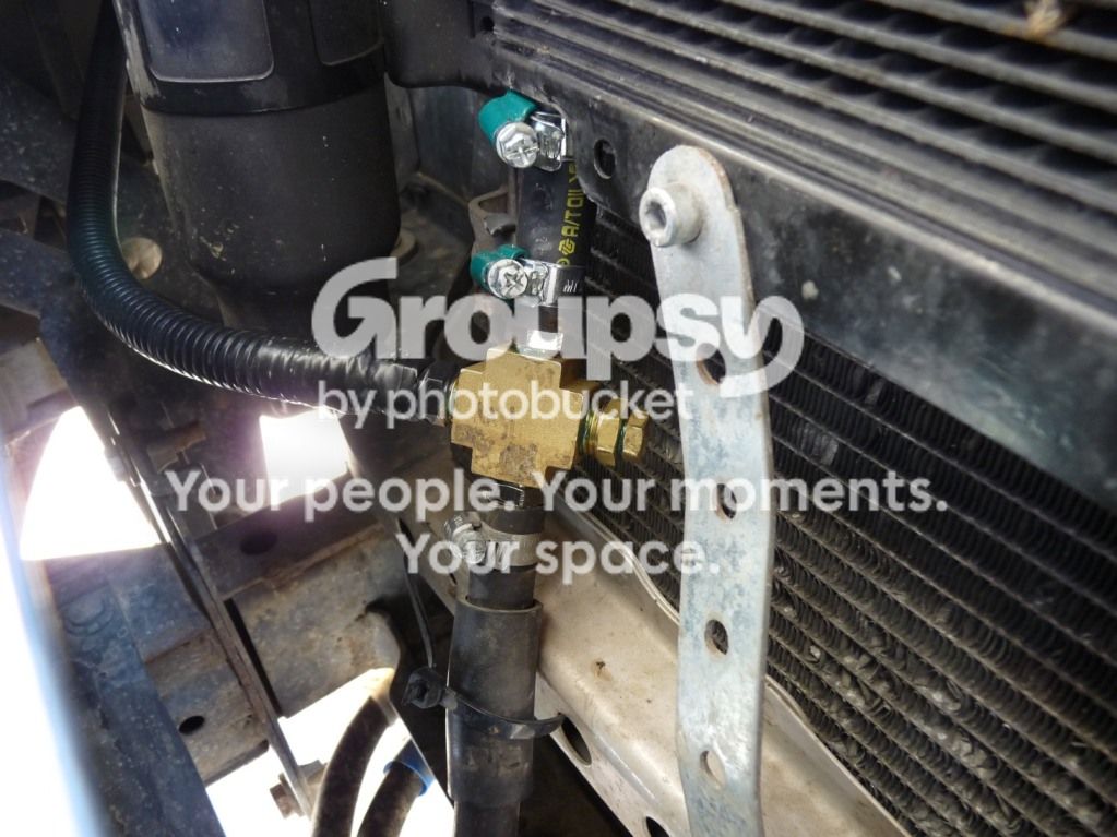

Being a scientist is sometimes a curse...I want to know what is inlet and outlet tranny oil cooler temperature. Not to make it too complicated i mounted one sensor (in time I will change sides and compare) - its indirect method (worser than direct but still offers good statistical comparison) - results for BM cooler soon.
sens1.jpg~original

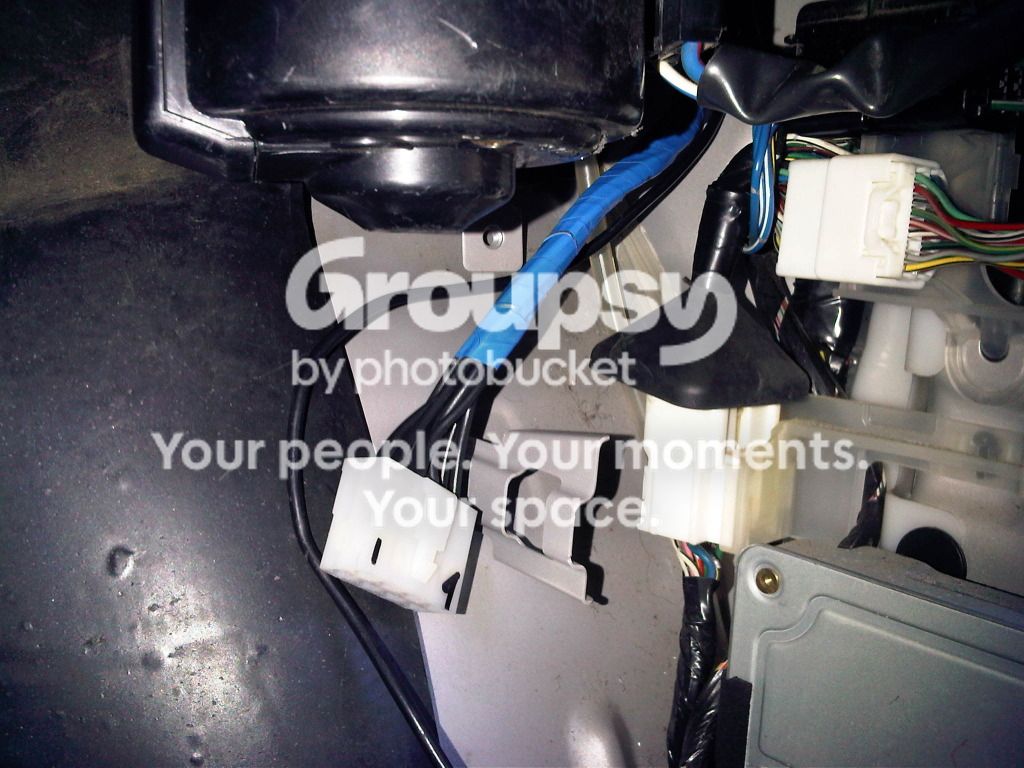

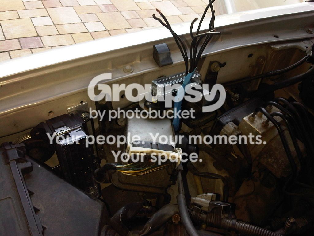

By the way I made my new mod electrical - added 8 wires to connect inside with the electric inst. I added also new fuse and relay box to handle big currents for upcoming lights and potential other issues.
Kobaskowo-20120813-00261.jpg~original
and in right coming to:
Kobaskowo-20120813-00260.jpg~original
