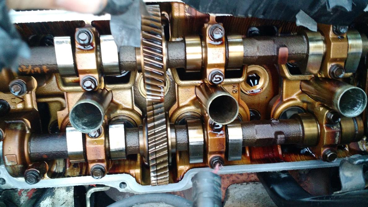

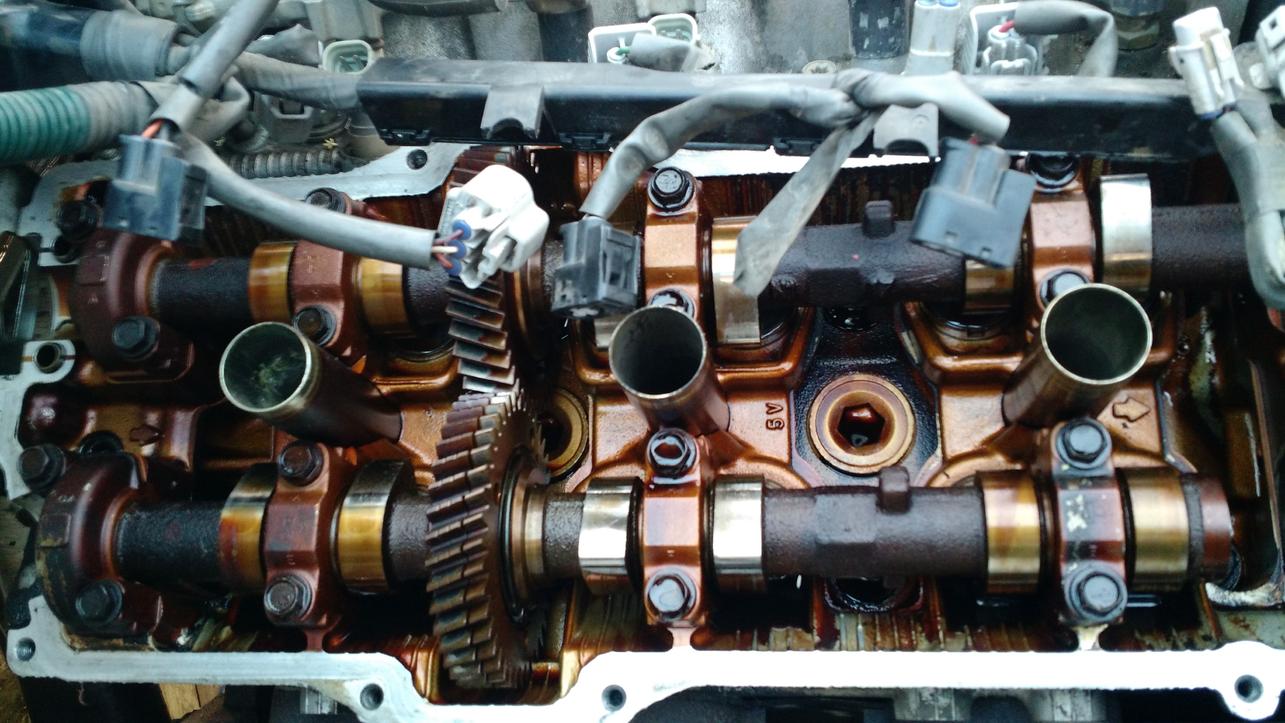

Is it stupid of me to think I can blast the valve/cam area with some degreaser since I have it open. Engine has 230k, and is kinda dirty:
I wouldn't. Just keep running synthetic and it'll clean itself.
Too much risk of destroying something in the head. You'll never get all the degreaser out. To do it right, you should pull the heads.
That's some nice looking valve train for 230k. Leave it alone
I concur with the others that said leave it alone. You should see some of the pics of sludge build-up some have posted on this forum. Your's is in great shape.
Yeah you wouldn't really want to "degrease" these components that are high friction and typically have a nice coating of oil on them. Not to mention a lot of it would drain back into the engine anyways. It looks fine and its typical for high mileage engines to look brown like that on the inside. As others have said before, just keep changing your oil regularly with high quality oil and it will be okay.
Thanks all! I will stay the course and NOT degrease a thing. I definitely appreciate the argument about existing oil coatings on the components already. Good looking out. Thanks again!
