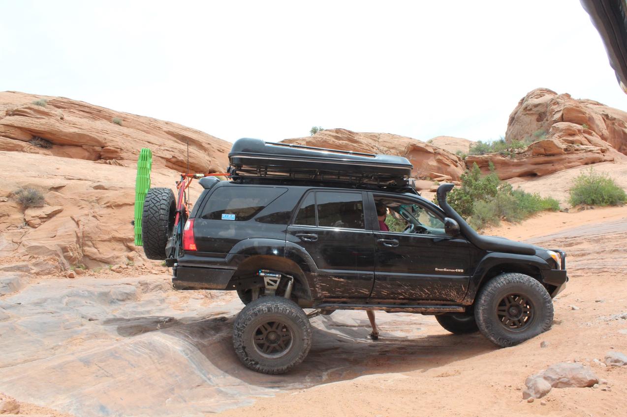

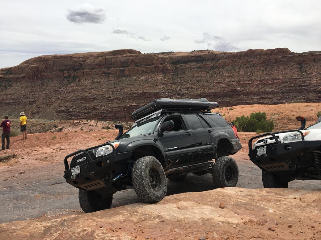

Well here are a few photos of some recent trips to Moab. Super happy with the travel. Yes with any mod there is almost always a downside.
I'm not running sway bars and must say it drives terribly. Need to look into some aftermarket deal for the rear at the minimum. My driveshaft hits my RCI gas tank skid pretty badly even after modifying it for more clearance. Other than that the thing rides like butter on those faster trails. I personally love the adjustability in the resi's. I use them every single time I go wheeling.
