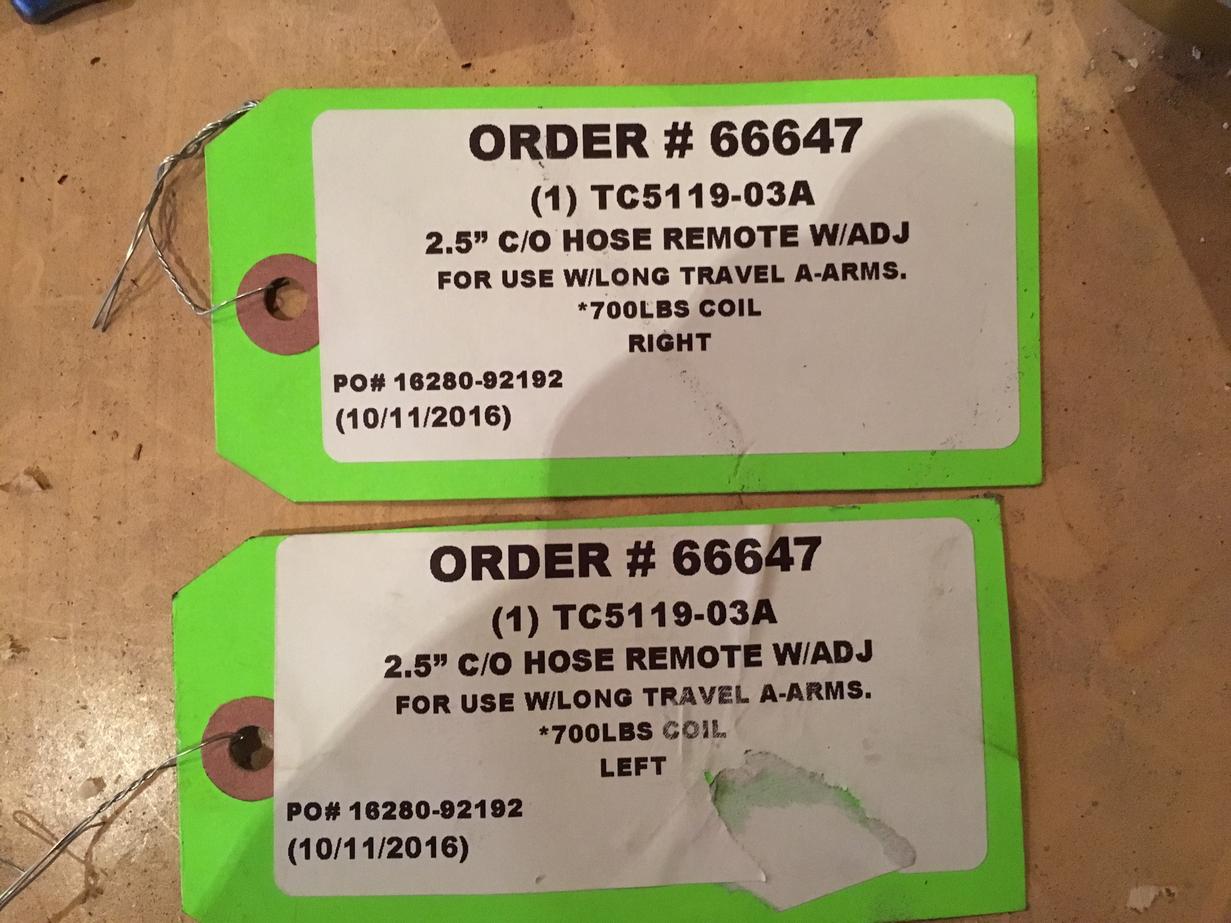

Was there ever a part number released for the MT length rear Kings? Or is it custom order only through TAP? I was one of of the ones who had a rough experience with the group buy, left a bad taste in my mouth with them but still wanting to piece together my own non-icon LT rear.

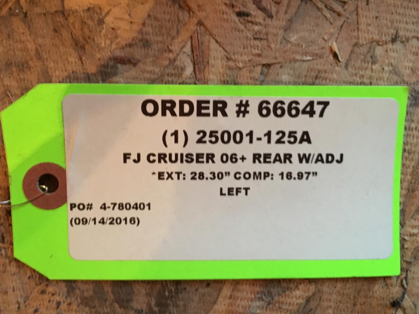

Here ya go! These are the tags for the front shocks and rear shocks (obviously the 700lb coil tag are the fronts).
And yes these are 100% custom for king so get ready for the wait.

King website show that part number with the standard travel so looks to be custom order only, however.....there's some LC80 and Tundra rear shocks that might fit the bill depending on valving.
25001-125A 4Runner 2003-2009 Rear Shocks Compression Adjuster 16.022 24.614
These might be a good "off the shelf" compromise
25001-144A Tundra 07+ Rear Shocks Compression Adjuster 15.831 26.028

VA4Runner09, that part number for the rear shock is the exact same part number as the King rear shock OEM performance replacement which has a length of 16.022" and 24.614".
So just so everyone understands, these are custom. They may be the part number for the OEM's but the lengths should be different. If you ran these with OEM parts you would blow up your rear suspension. My recommendation is to call King/TAP and tell them you want the lengths that are mentioned on my ticket or reference my order number. Hopefully this helps.
