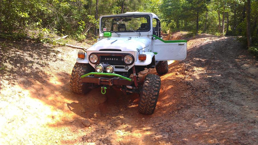

Probably not going to do a lot of offroading with it. Maybe one day but for now it is my daily driver. I forgot to mention in my original post I have a 1976 FJ40, that my Grandpa built, I I use to go offroading. One of the reasons I wanted some towing capacity was to haul my FJ to the trails. There is not a lot of good places to offroad here in Texas so I need to trailer it at least 80 miles to the closest park.

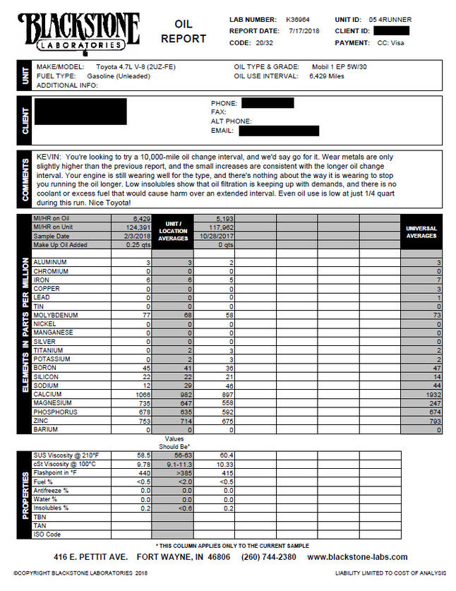

Uoa - 2018-07-17
I just got my UOA back. This is from a couple oil changes ago. I forgot to send it in. I am currently at about 4,500 miles on my current oil and I am going for 10,000 miles. Ill send in a sample of this to to make sure 10,000 is not too much.

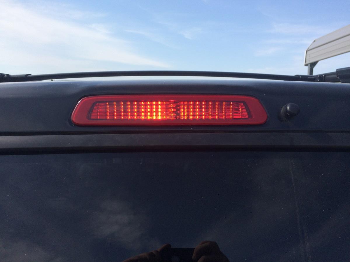

Not a whole lot to do this weekend. Its has been 108°F here. I did install an LED light into my third brake light. I also polished the lens with meguiar's Plastx. It looks a whole lot better and made it easier to see the LED light.

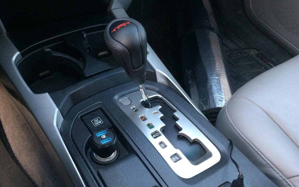

Over the weekend I did a couple of things. I changed the fluid in my front and rear diffs and my transfer case. I used 75w-90 Amsoil severe gear. I also installed my Energy suspension rear sway bar bushing kit. Lastly I installed BEAMTECH 9005 LED high beams. I haven't driven with them at night yet, Ill add some pictures when I get a chance.
