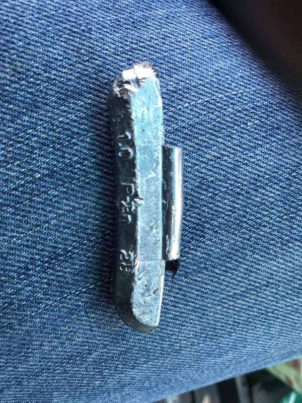

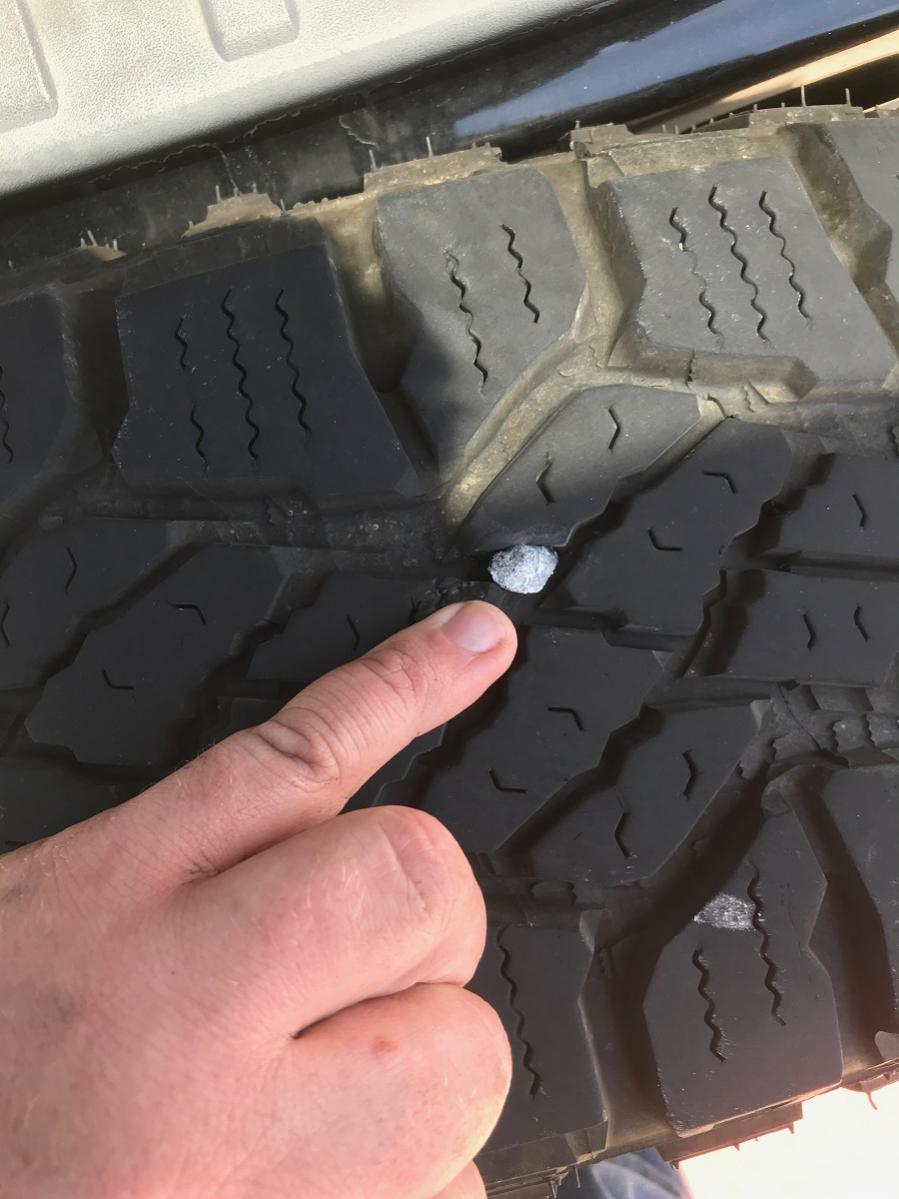

I haven't really done much to my 4runner lately other than fix 2 flat tires. I had a tire weight go through one of my tires and then 2 weeks later a roofing screw went through another. I was surprised that the tire that the tire weight went through was able to be patched but it is holding air. I have not detected any air pressure loss. Sucks because I have never had a flat tire before in my life. My tire jack was barely able to get the tire off the ground. I now keep a block of wood in the truck.

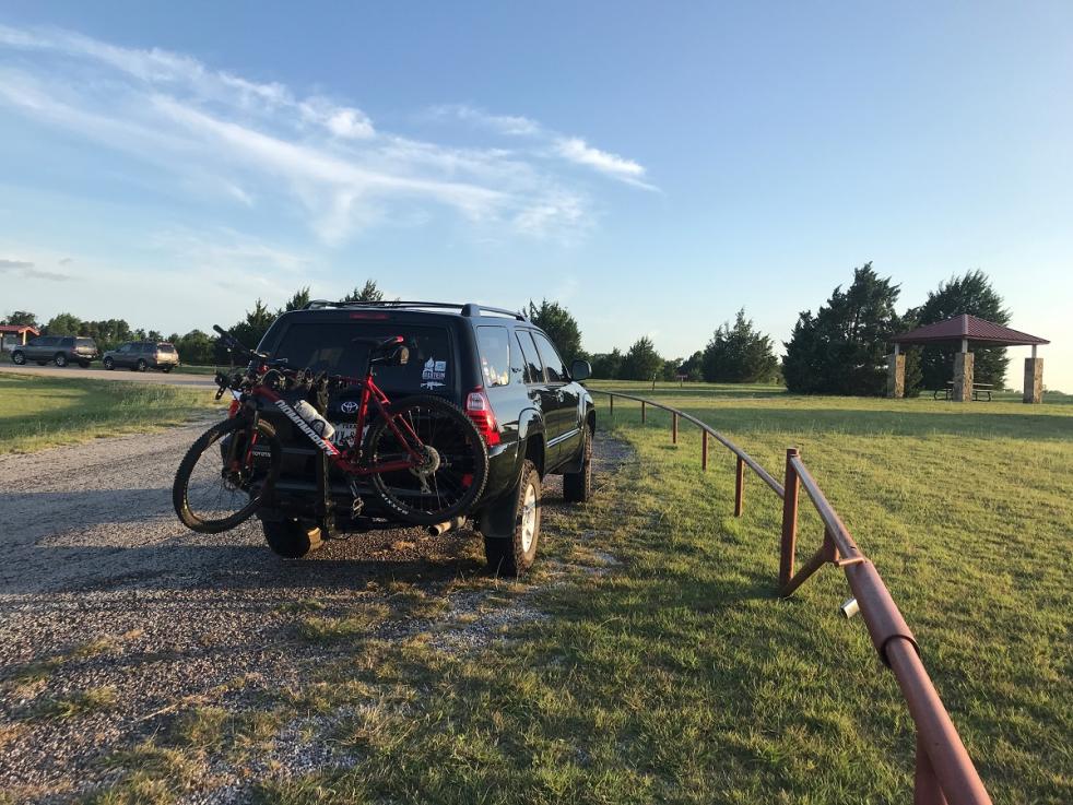

Lately I have been using my 4runner to get to the local MTB trails. Im using my brothers thule rack but I am planning on getting a better rack for my 4runner. Thinking of a kuat NV 2.0 base. Not sure yet.
Kuat's are nice, but $$$. Personally if I had the budget for that I'd pick a 1UP.
I purchased a Yakima holdup for a steal and ended up with the 2+ as well. It's a bit heavy, but it's awesome to put 4 bikes off the back! Really love any of the 'tray' styles though. So easy to put on and take off.
If I can find a similar platform rack that holds 2 bikes I would go for it. The thing I dont like about the 1up is that it does not use a hitch pin. I just dont trust their method of attaching the rack to your hitch. Plus I have a fancy hitch pin that is keyed to my 4runner keys.
