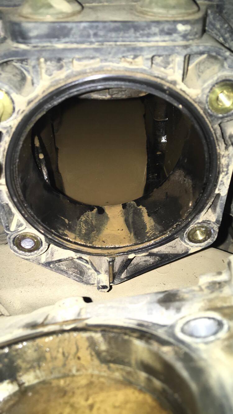

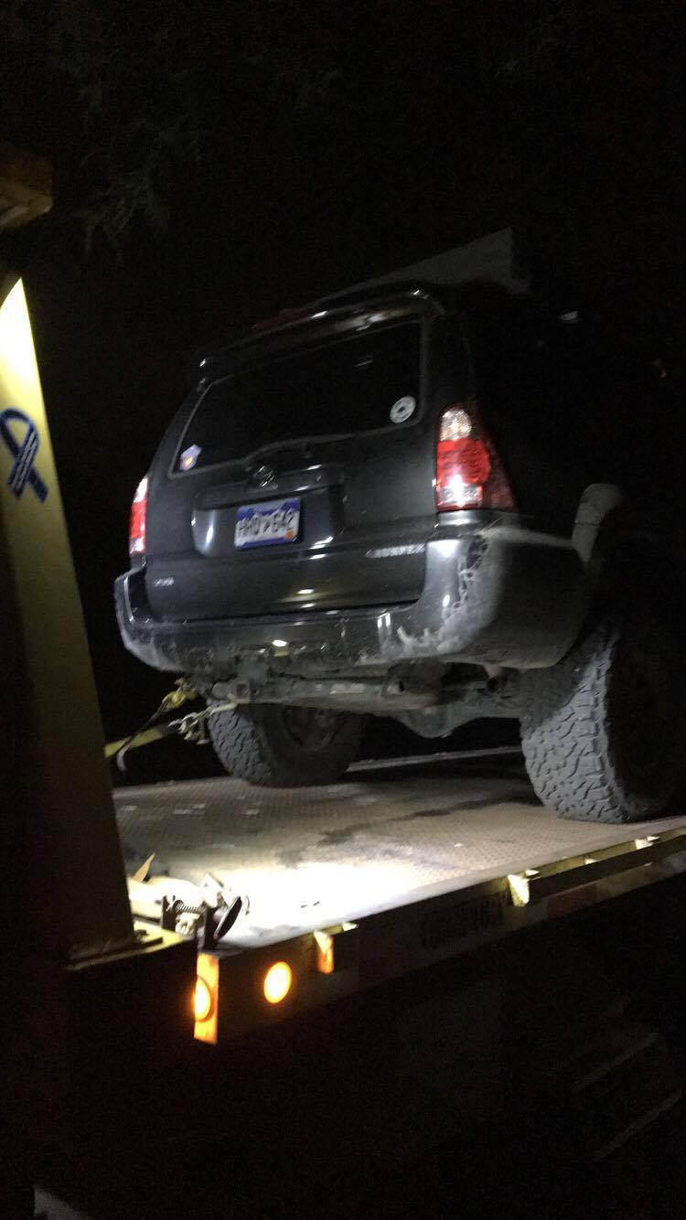

This last weekend I managed to hydrolock my engine on Jenny Creek. The fender lining was missing and I sucked up a lot of water that was flicking up from my tires. I was towed home. The motor doesn't seem to be seized as I can crank crank it by hand, but the starter is not attempting to turn at all. Not sure why.
Tonight will be this T4R's first trip to the doctor, besides an alignment.

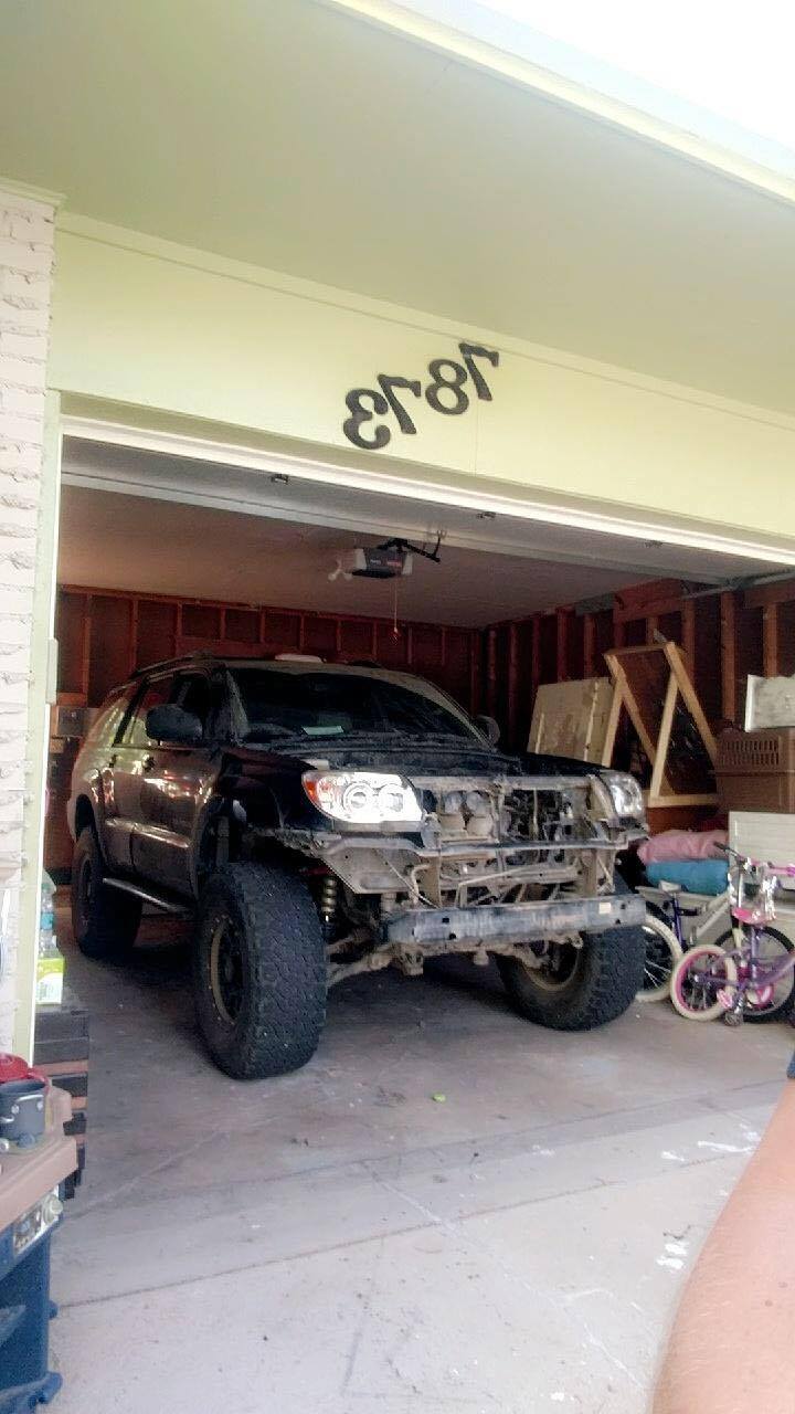

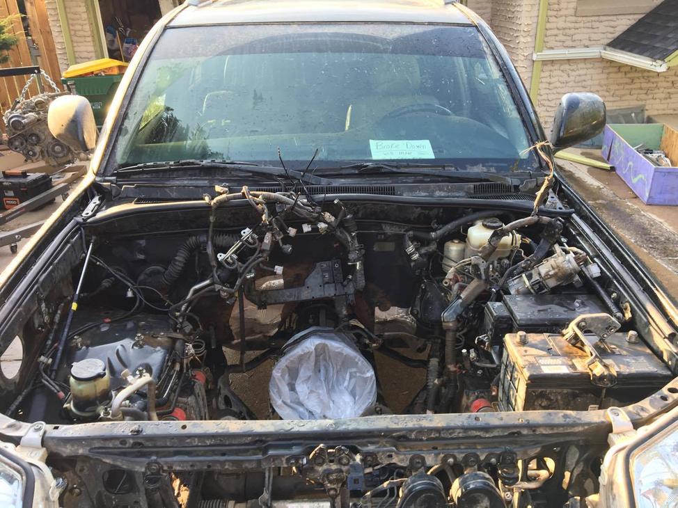

Pulled apart the motor, found one of the rod's bent and possible bent crank shaft. New/used motor is on its way. Got the truck into a buddies shop and was able to get a lot of the underside bolts taken apart while I had access to a lift. Flat towed the truck to another buddies garage where the motor will be coming put completely today.
New motor will start going in this weekend!
Time to open and a Ace card, because ill probably be replacing ever bolt due to loss

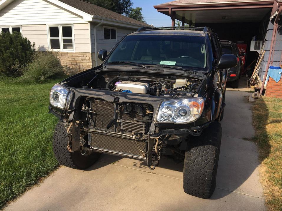

Well some how some way I actually pulled off yanking and replacing a modern engine! Took about two weeks of getting off of work and weekends to complete. Got the engine on Ebay from New York with 120k miles (40k less then mine). Changed the plugs, timing belt and all that good stuff while I had it on the hoist.
