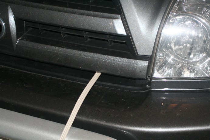

Finally found time to complete this mod.

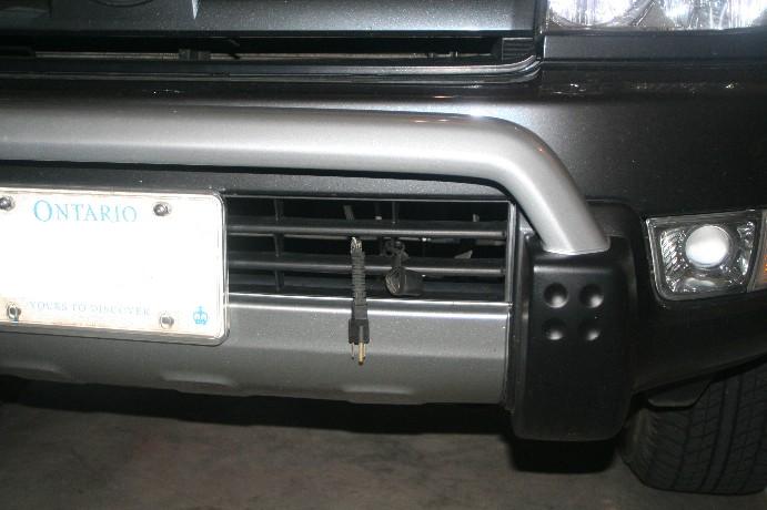

Here is the cheesey OEM (stealer) installed plug that I wanted to clean up:

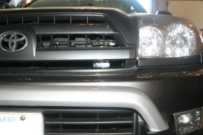

Now you don't...
Cleaned it up using "Bulldog" parts. My first piece of chrome on the front other than the emblem:

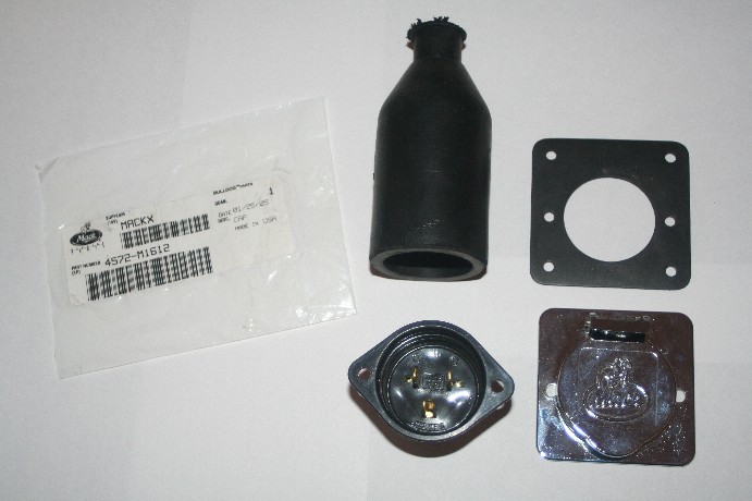

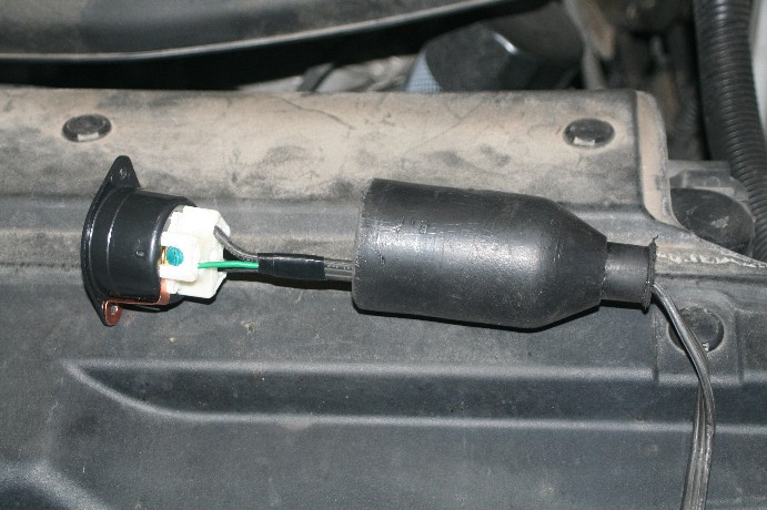

Bought a Mack Truck cap and plug set:

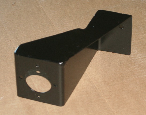

Fabricated and painted a custom bracket:
Cut existing plug off the block heater wire.
Attached the new plug and boot:

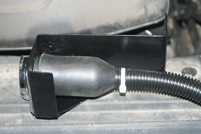

Attached the plug to the bracket with stainless bolts and covered the wire end with protective wire loom:

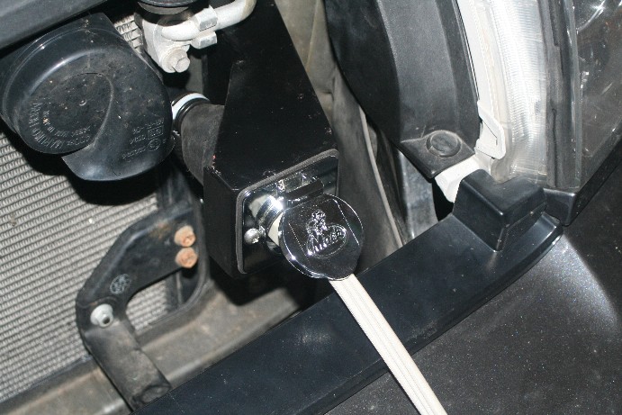

Attached the bracket with a stainless M6 bolt in an existing unused rivnut on the right side of the radiator. Pictured with the extension cord in place:

Total cost ~ C$33. I can use it with the hood closed so they can't rip off my extension cord (they could always cut it though.)
Neat and clean and a stealth look to it. I'm set for winter.

Great work. I'd do it in a second except you had to go and fabricate your own mount. Rats! Was it difficult? Will it be hard to access behind ice & snow?
Does that "hatch" work on a spring basis, or does it friction fit closed? I ask because my similar mod uses a marine plug, which closes by friction.

Thanks.
Not sure how to rate the difficulty of the fab work. This involved metal cutting, bending, welding and drilling. It is a spring loaded hatch with a weather seal (common item on all big rigs.) I don't expect any access problems. Just pop the hood open (I take time too clean all the snow off especially on the hood and front for better visibility.)
So do you need to pop the hood each time for access?
J
J
Yes. That was one of the questions I had about locating the plug there but I still opted for it. Minor inconvenience (a few days a year) for the sealth look.
