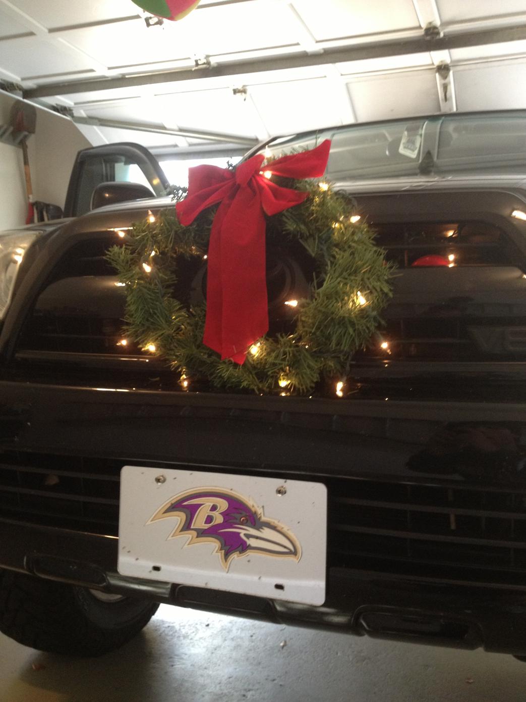

Well it's been a while that I've done anything on my truck. Just lack of money and motivation has slowed things down a bit. But when I saw Alex56s idea for a lighted christmas wreath I had to do it, so I did. Happy Holidays everyone

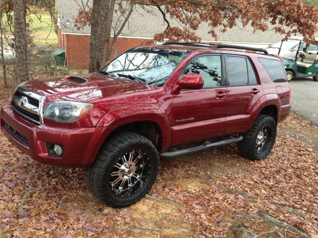

Nice runner man. I'm running a similar set up on mine. Bilstein 5100's all around set at .85" in the front, Toytec 2" coils in the front with 2"superflex in the rear. I managed to put 33x12.50 20's on mine though which is a tight fit! Slowly modding as I can, which is kind of tough since I just turned 16 and only have a part time job. I like the stance of yours and want mine up a little bit more in the front because I still have a little rake. Gotta do HID's and next on my list is an aFe cold air intake and muffler. The mods never end! Here's mine as it is now, not quite as tall as yours though.

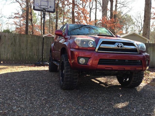

Well it has been a while since I updated my build thread, so here it is. Suspension is OME 885s + 3/4" spacer in the front and Icon 2.0" coils in the back with a toytec trim packer. Along with the 1" body lift as well of course. And before someone asks, yes I'm going to Florida State. Go noles!!

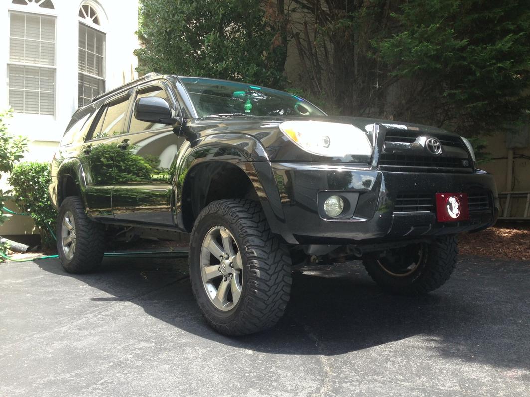

Over the past 7 or 8 months hadn't done much to my runner until last month when I put the spoiler back on, removed the rain guards, had a CV boot rip on me, and a piece of metal in one of my tires. I'm about to have my LCA bushings replaced as well. I got a set of 275/65/18 Goodyear Kevlar MT-Rs but after driving on them and looking at them I decided they were too small so I went 275/70/18 Cooper STTs which will be on it tomorrow. Pictured is my truck as it sits with the MT-Rs and also the set of Coopers that are going on tomorrow.
