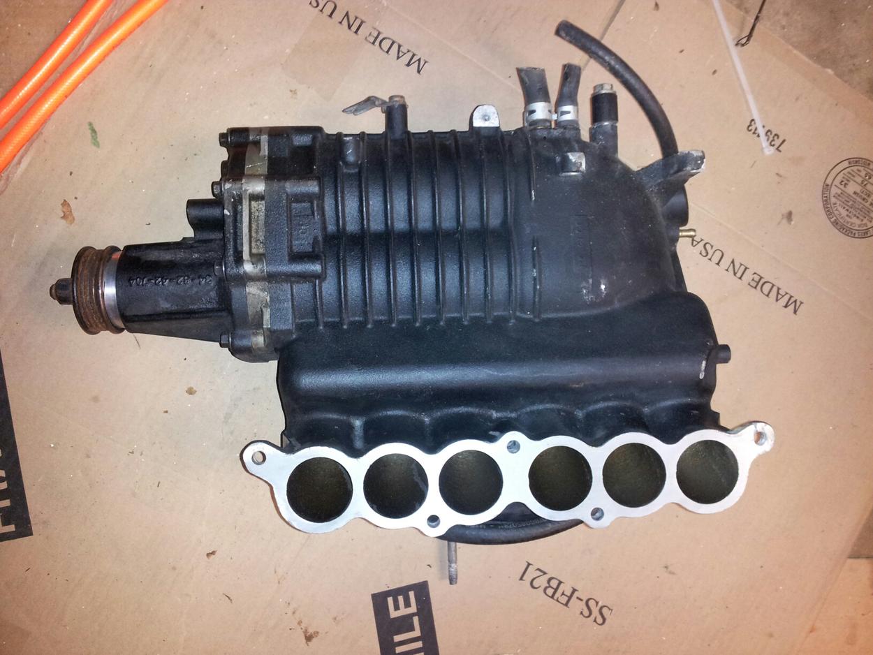

I don't feel comfortable reusing old gaskets. Especially in a boosted scenario. I'd rather do it once, and do it right. The supercharger bolts to the lower manifold assembly, so it still requires a gasket. It doesn't require the injectors to be removed to replace the knock sensors, but as cheap as the o-rings are, I will probably go ahead and change them. Valve cover gaskets aren't leaking, so I'll leave those alone for now.
Having done the job twice, the fuel rails need to be removed, hence the o-rings.
The gasket is a metallic gasket - not the typical rubber one you'd expect.
You have to forgive me, I misread another post with detailed pics showing how to replace them. He said that removing the injectors from the plenum wasn't necessary. His upper intake gasket didn't look metallic. I would rather order them and have them, just in case the factory gasket gets damaged. If I don't use it, I can always return it!! Thanks for the info!
