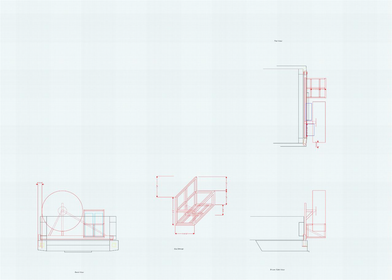

But anyways I'll upload my drawings I hope tomorrow and if anyone wants to critique, critique away ;)

Preliminary design and still working on it, but I'm happy with it so far. I am finally seeing a reason to move forward after a very rough time in my life so excited to get it done and see where I can go with more fuel =)
I'll upload the final sketches tomorrow. Going to start this on Friday and work till I can't stand or worse...got a funeral on Saturday so probably won't get it completed over the weekend.

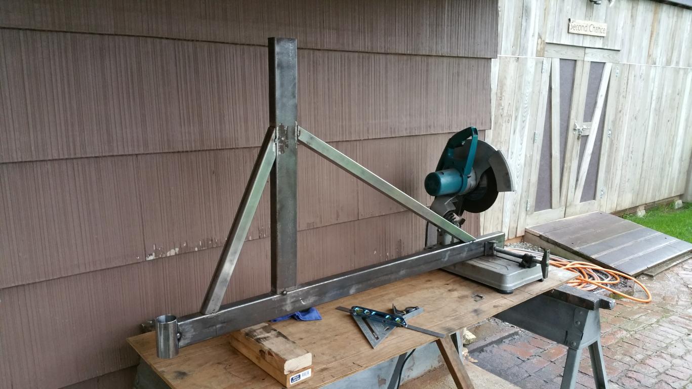

So even though I had thought it out, designed and everything for some reason my mind didn't grasp the 'bend' along the Spindle. So I started to drill for my placement and my Dad came out in time and stopped me. Glad he helped me before I screwed myself. So moved it and got my Spindle installed and the base tacked up. Proceeding to tack everything up and see how it sits. We are concerned that the tire will stick out and possibly catch things when its leaning against something. But anyways, its 7pm and i can't walk...but tired of living in a box and never going out....
Here is the 'base' and spindle installed.

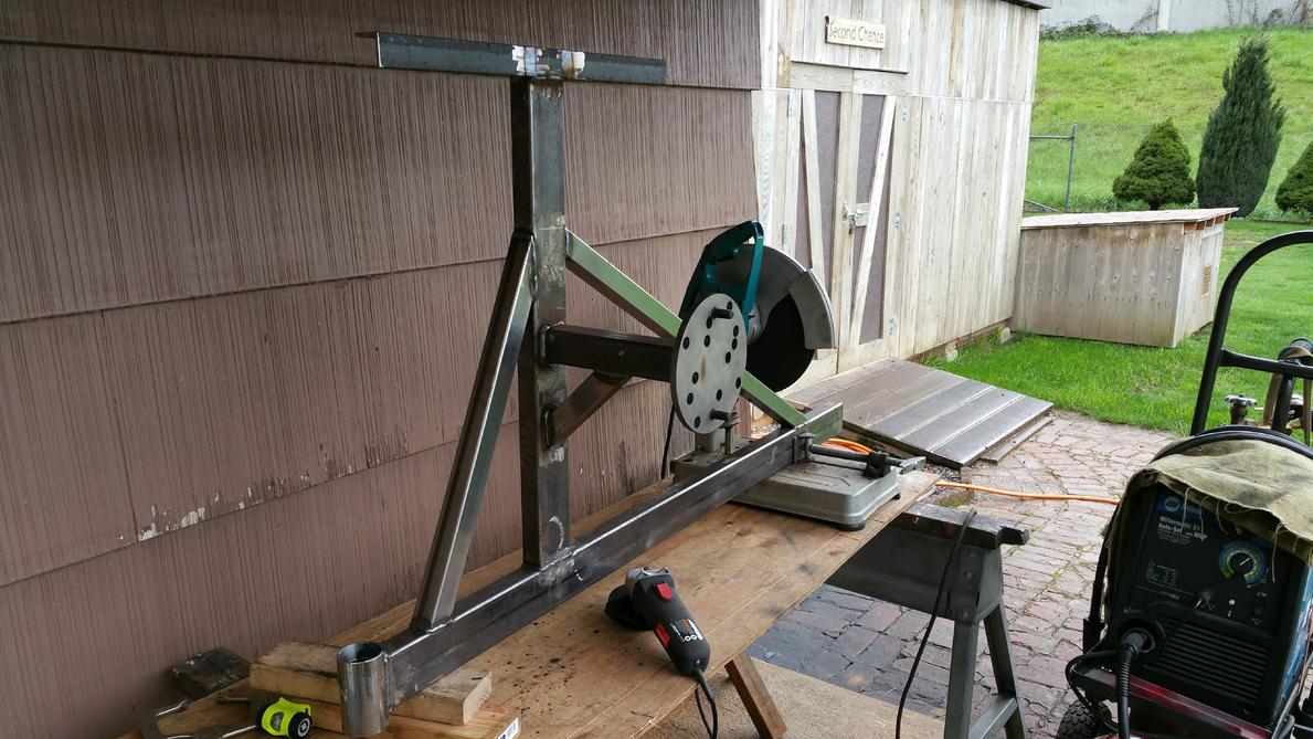

Update - Sunday
Well by just a few minutes of starting it I knew I was over my head (physically). The last few days have really taken my toll on me and I couldn't even lift my swing away due to body not working like it should...but anyways its DONE. Need to finish my Gas Can holder, weld that on and primer/black paint. Really enjoying it, but its tough work. The one benefit I like is I got all my metal and my spindle kit for a total of $193.45. It will be about 2 weeks before I get another update since its spring break and my son and I will be trying to enjoy it :)
Thanks for the read!

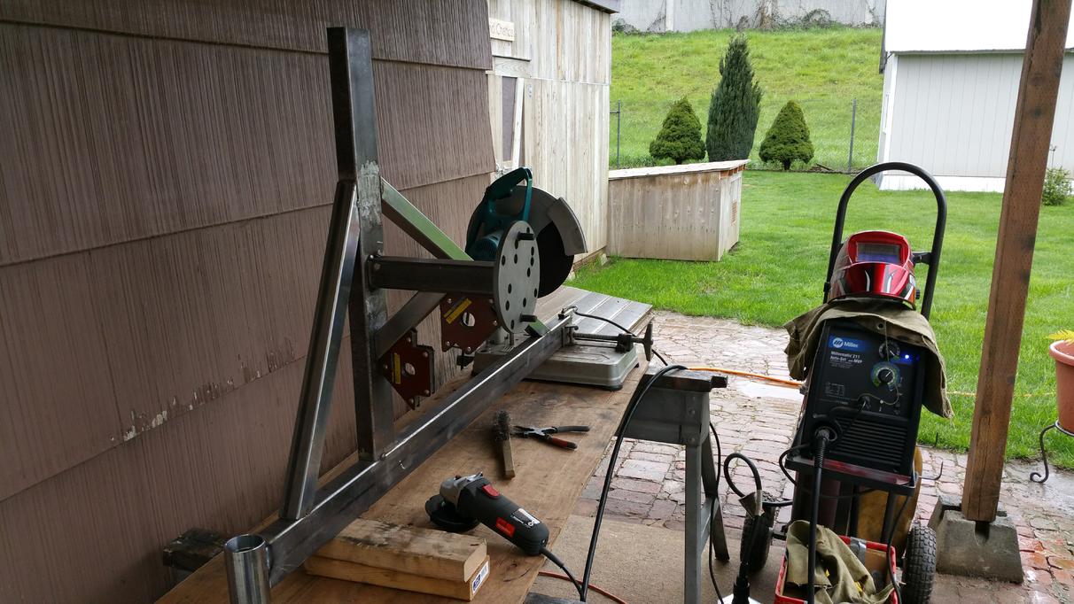

Here is the test fit to see where the Jerry Can will be attached.

And its done, welding is 99.9% done minus the attachment to the truck to keep it closed. I got one coat of primer on but didn't take a picture of that.
20170408_143841.jpg~original
I'm VERY happy with how it turned out and can't wait to finish it and go on a trip :)

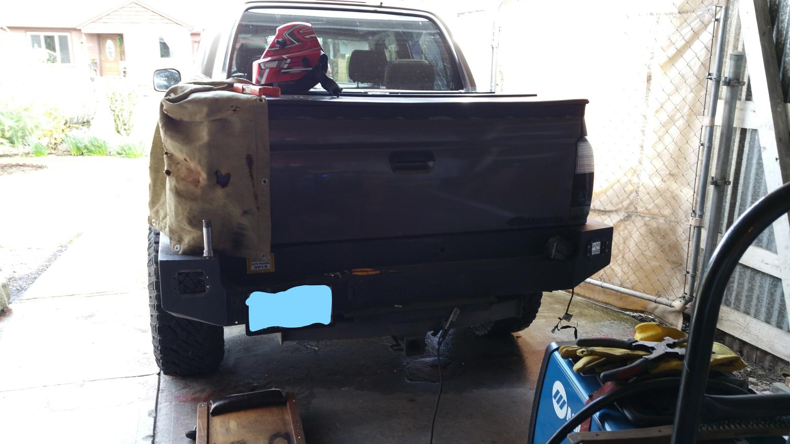

It's Finished!!
So I was able to get my dad to assist me for 5 hours on Wednesday in the final installation. Glad I had his assistance as we ran into a few 'bumps' in the overall thought design. So pictures i'll try to snag today when I'm going to get my son from school.
So first the bumps, my tire blocks my turn signal some (already ordered 9.99 small led turn signal lights i'll install and post afterwards). Second, my entire swing away (no tire/gas cans just the metal) only weight's in at 95lbs, I had re-enforced the current bumper, but see that I have to add ANOTHER cantilever to support it again (dad's recommendations, I feel its fine, but dad wants this so he could 'winch' off of it(being sarcastic, just wants it bullet proof). Third, during my gas can build I fell into the common complacent weld not tack it all and tweaked it. I'm okay with it and once it gets damaged i'll fix it right, but for less than 200.00 i'm super happy! The Last issue was that things aren't square. This is being polite, during the install of the attachment to the swing away we had to do some, interesting welding. Thankfully I'm a grandmaster and can weld anything that doesn't require me to bend =)...but seriously we used a washer, I welded it and built it up. Unless I point it out, you can't tell now =)
