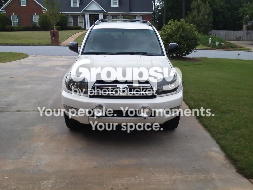

I bought my 2004 4runner in June of this year after rolling and totaling my TRD FJ Cruiser.
My 4runner started its life as a bone-stock grocery grabber owned by my next door neighbor. I wanted to go into this build using only quality parts and keeping everything as stealth and OEM looking as possible. I have done all installation myself.
Day 1:

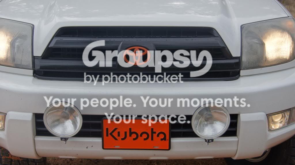

[MENTION=165]momo.75[/MENTION] floating Hella mount and blacked out headlight bezels

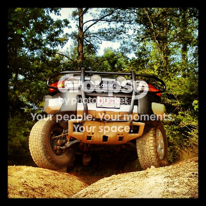

I have to ask,..... how you like wheeling the FJ compared to the 4runnner?
Miss your FJ?
Welcome and good lookin truck.
Miss your FJ?
gotta say, the 4runner is nowhere close haha. but much smoother on the road which is cool with me. and hell yes I miss it, it was a TRD edition loaded to the max. That thing took me anywhere

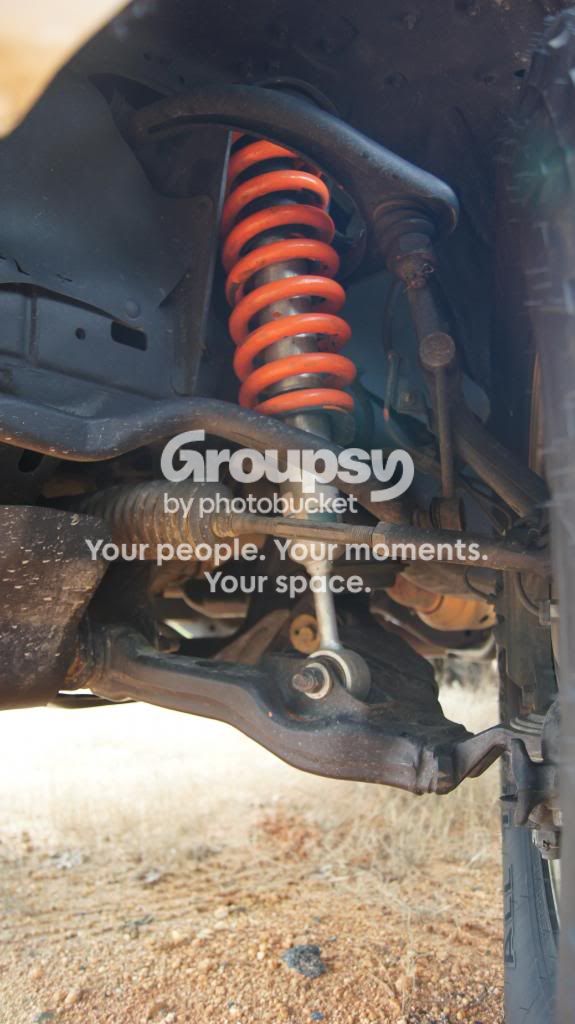

Next I installed Bilsteins with OME springs up front with a daystar 1.5 spacer in the back. I painted the springs orange to keep with my theme.

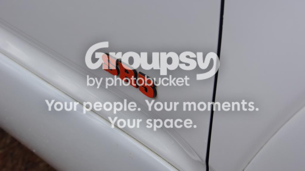

Then I decided to try something unique and paint the badges all two tone orange on black

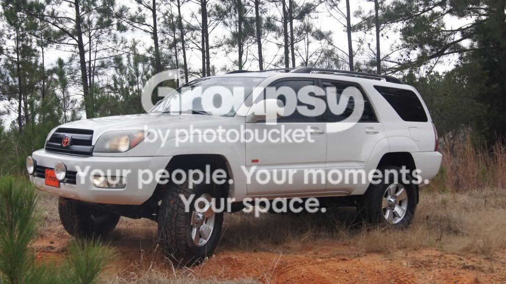

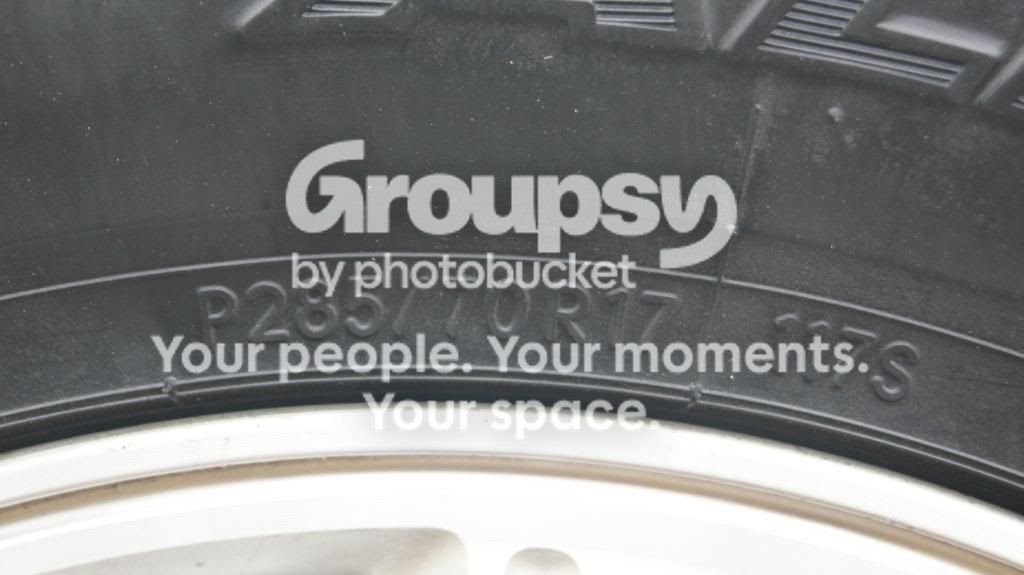

Next were the all pro 1.5" wheel spacers and new tires. Went with nitto terra grapplers

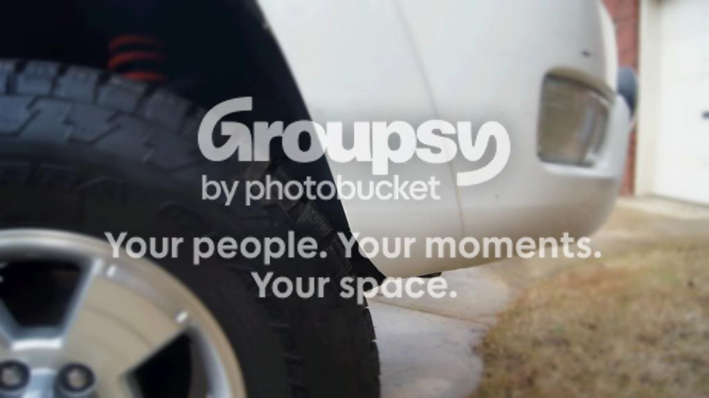

How much trimming did you do in the front to fit the 285's?
Looks great. The orange on white looks really cool.
thanks, I like it to be unique. I had to remove the mud flaps up front, trim about 3 inches of inner fender and about an inch on the bottom corner of the actual fender, and push the inner fender forward about an inch. About 20 minutes worth of work, not too bad at all. I can post a pic if anybody needs it.
Please post a pic of the trimming. It will help folks in the future.

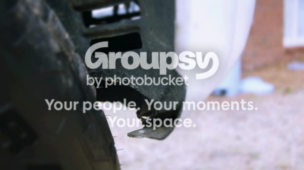

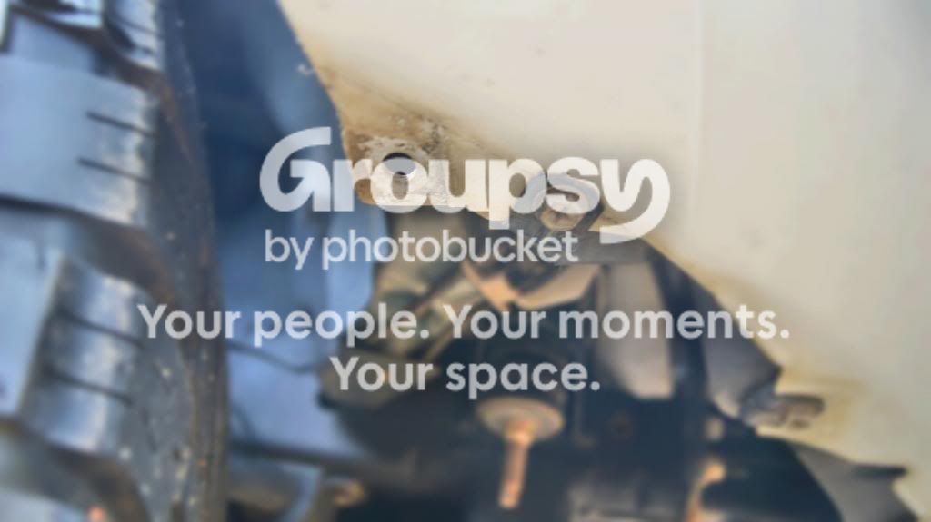

Here ya go.
Unbolted this screw and pushed the inner fender forward about an inch, checked my clearance, re-drilled and re-installed.
Then trimmed 2-3 inches off the bottom of the inner fender

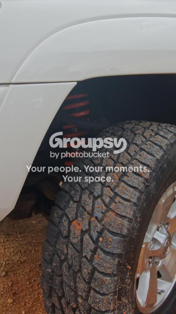

It was still rubbing in reverse at full turn so I trimmed about an inch off f the bottom corner of the outer fender (white part)
And now no scrub at all! Seriously took me all of 15 minutes by myself.

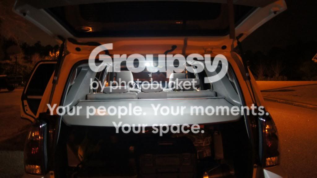

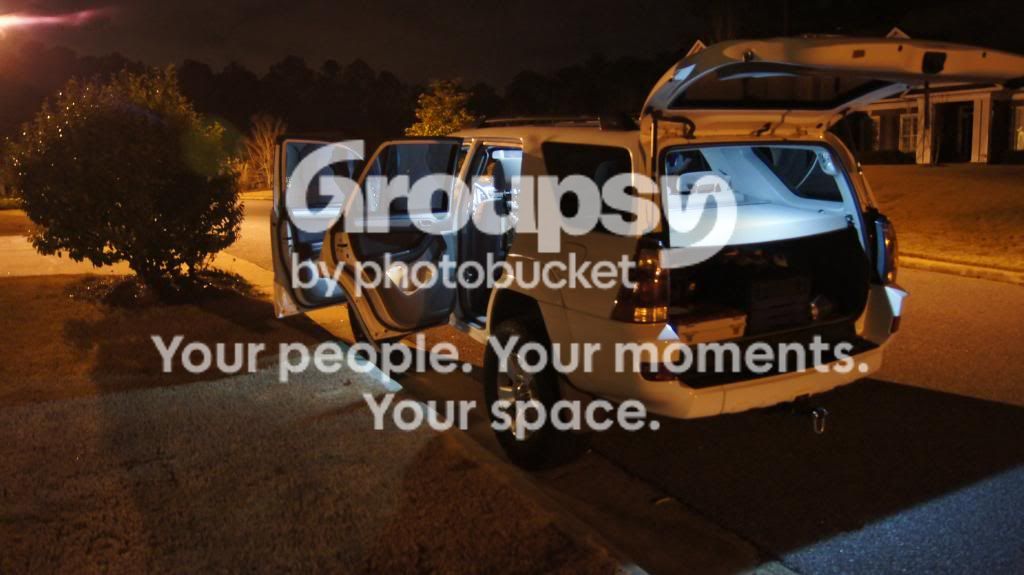

Led Interior lights. I got them from superbrightleds.com and bought the brightest options available for all bulbs. Cool white color.

Nice LED's, how much that cost you and how long it take you? Any wiring involved?
was alignment required?
