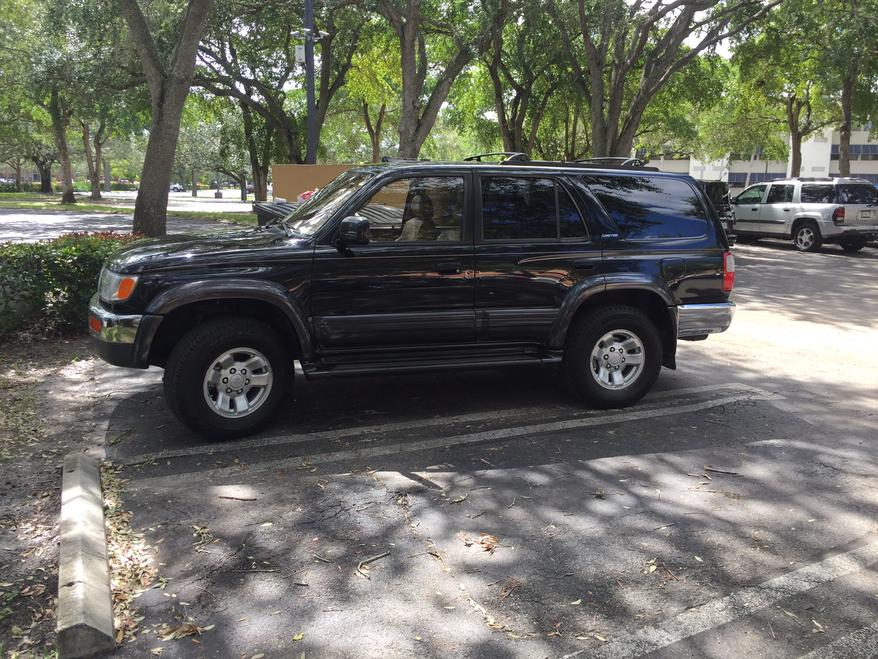

Last October I realized my childhood fantasy (not kidding) and acquired a 3rd Gen - for years I thought 3rd Gens were pretty much the most handsome SUV around, with a perfect mix of leanness and athleticisim (personification folks), and while I love my 1986 P-car on the open road, when baby number 1 came, along came the realization that a 4Runner would really fit the bill when it comes to mobility, space, and reliability at the right price.
After checking out a few, beat to hell examples with questionable maintenance, asking for crazy money, I lucked out and found a sweet, single owner, 1998 Limited 4wd, no locker, some obvious repaired passenger door damage, and an extra 4wd badge (8wd - sweet), but an immaculate interior, no rust, and dealership maintenance records going back 15 years. At 5500 bucks, and 130k miles, it was a no-brainer.
Here it is when I brought it home, in its OEM and slightly sagging glory:

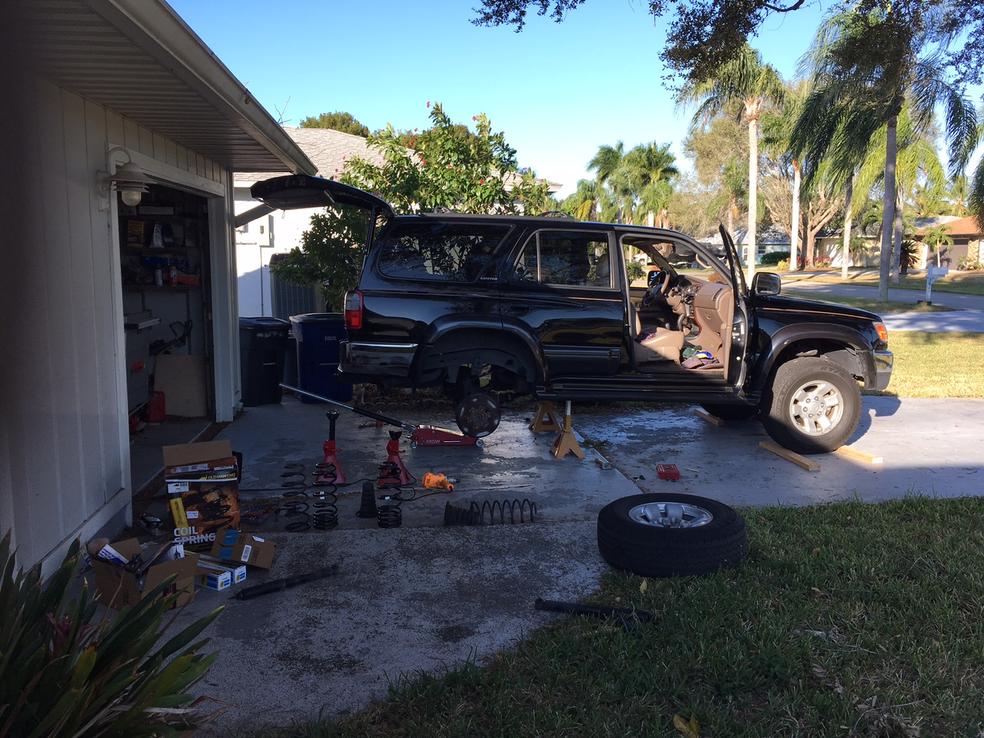

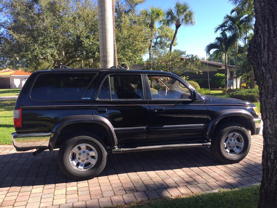

I immediately took care of the lower ball joints and tie rod ends. Timing belt had been done recently, and my first order of business was taking care of the rear sag, so I watched Tim's video and put a set of 906s and Bilsteins in the rear - hear are the during and after shots:
Wildpeak AT3W go on tonight, and the front 880s this weekend, along with a paint polish and wax.
