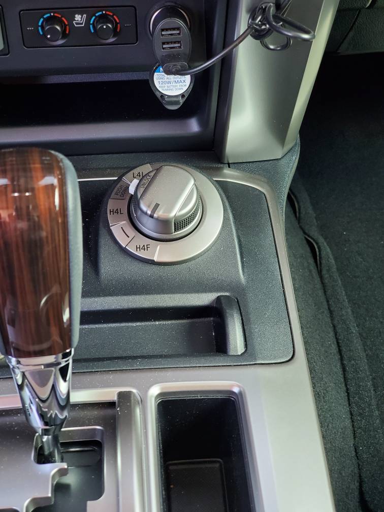

This probably a stupid nub question but my last 4Runner was a 2008 and didn't have this type of transfer case shifter. L4L and H4L I understand but H4F. What does the F stand for? :ranger:
Freedom. Freedom for the front wheels and rear wheels to do as they please independent of each other. 'Cause this is America!!
L4L - low range 4wd locked center diff
H4L - high range 4wd locked center diff
H4F - high range 4wd unlocked center diff. I'm assuming F stands for Full-time for use on any surfaces.
Thanks guys it's the 2020 Limited, magnetic grey with black interior I'm referring to. I haven't taken delivery yet so at a bit of a loss. All three of my previous 4runners had nothing like this. "and now I know the rest of the story".
