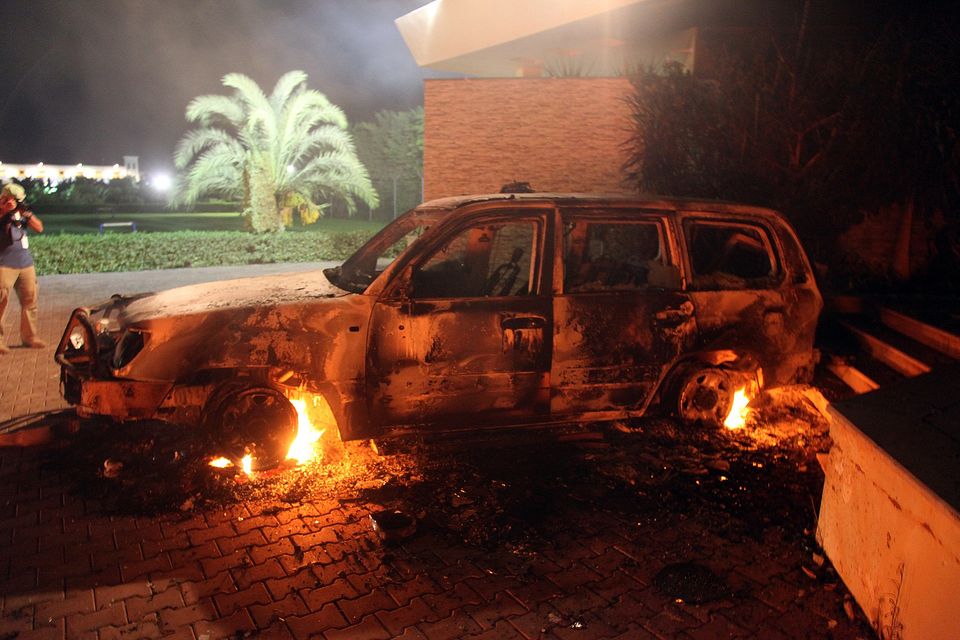

Libya Attacks on U.S. Embassy.... Landcruiser??
I saw this photo on the internet and wondered if this was a Landcruiser?? Looks like one.... ??
