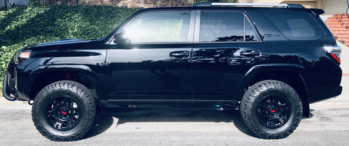

255/80R17's(33x10) with no lift. The PRO sits 1" higher than my SR5
Untitled by redrunner87, on Flickr
Here's my experience on my factory height on my TRD Off-Road Premium which sits than your TRD Pro

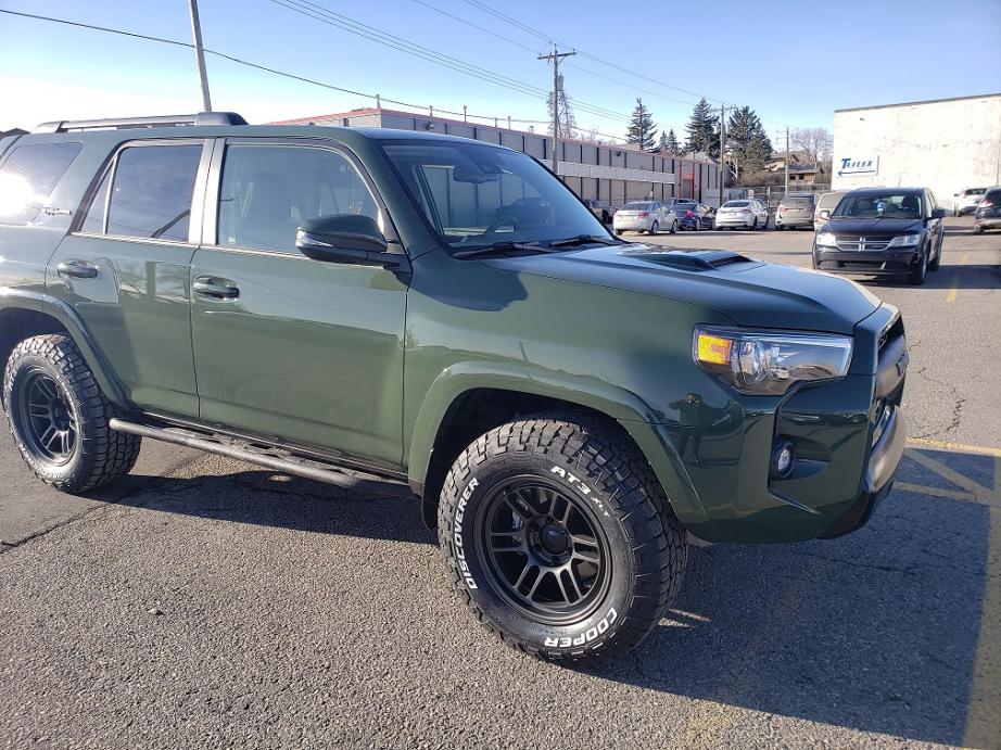

Pic 1:
Stock 2020 TRD Pro, 18x9 Enkei RPT1 wheels, 285/65/18 Cooper AT3 XLT Tires. Slight rub on mudflap at full lock, should be able to push it in.

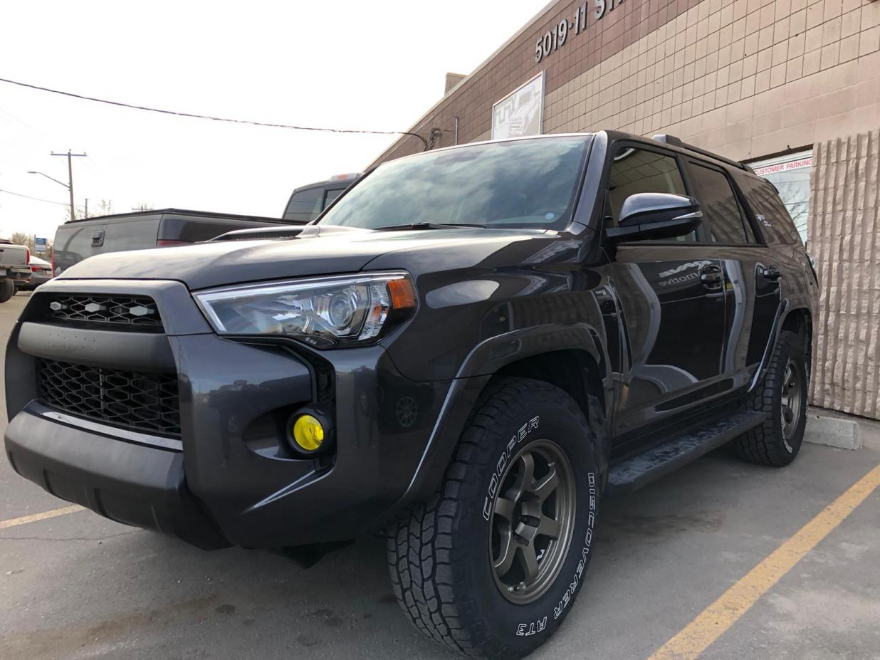

Pic 2. Stock 2019 TRD Offroad, 17x8 Konig six shooters, 275/70/17 Cooper AT3 LT.
