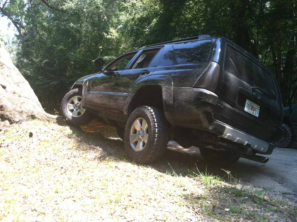

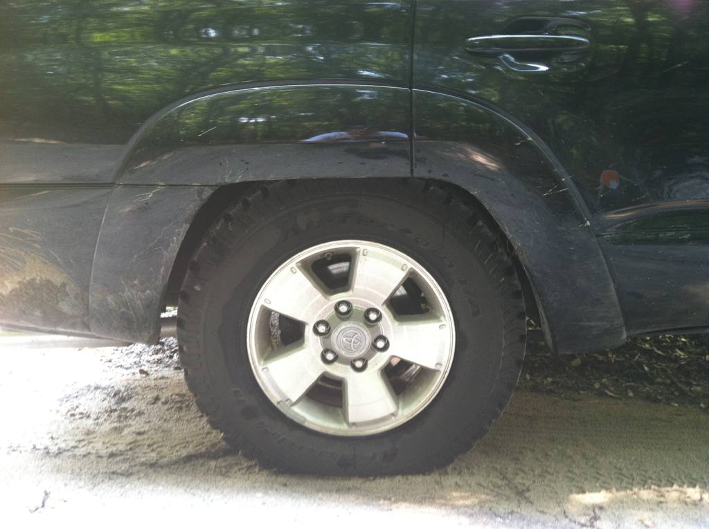

<a href="http://s1106.photobucket.com/albums/h377/Ridefast84/?action=view&current=D854812C-0D09-4F86-88FC-428FE1EF5798-4405-0000077CCEB16495.jpg" target="_blank"><img src="http://i1106.photobucket.com/albums/h377/Ridefast84/D854812C-0D09-4F86-88FC-428FE1EF5798-4405-0000077CCEB16495.jpg" border="0" alt="Uploaded from the Photobucket iPhone App"></a>
265/70/17 BFG T/A KO on my stock 4Runner and have no rubbing anywhere even when flexed
Only time I have ever had any rubbing was taking a sharp corner on a washboard dirt road and I hit a pot hole pretty hard and it rubbed something pretty gnarly but I couldn't find any damage.
