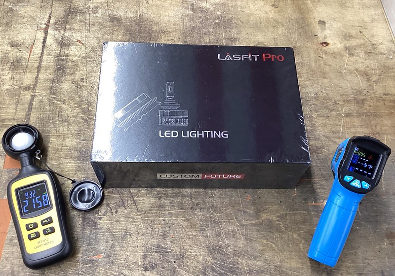

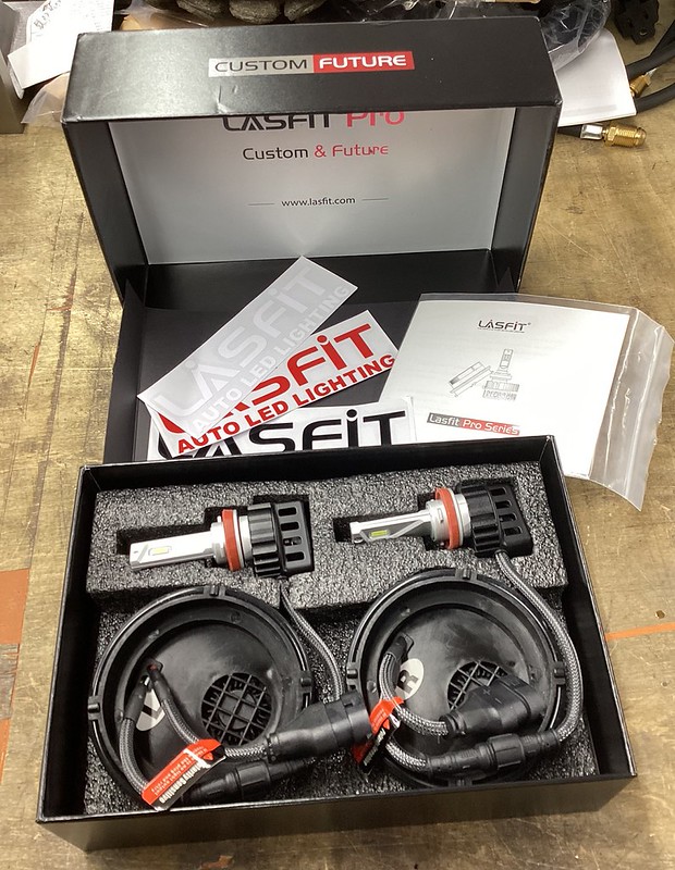

The headlights were shipped in a sealed USPS bag, mine arrived with no damage to the box whatsoever but this does seem like a bit of a gamble with the post office. The actual product packaging is very good quality and seems like it would protect the bulbs well from rough handling.
IMG_0068 by EricT4R, on Flickr
IMG_0070 by EricT4R, on Flickr

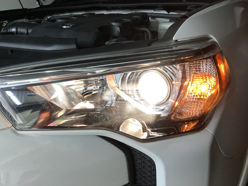

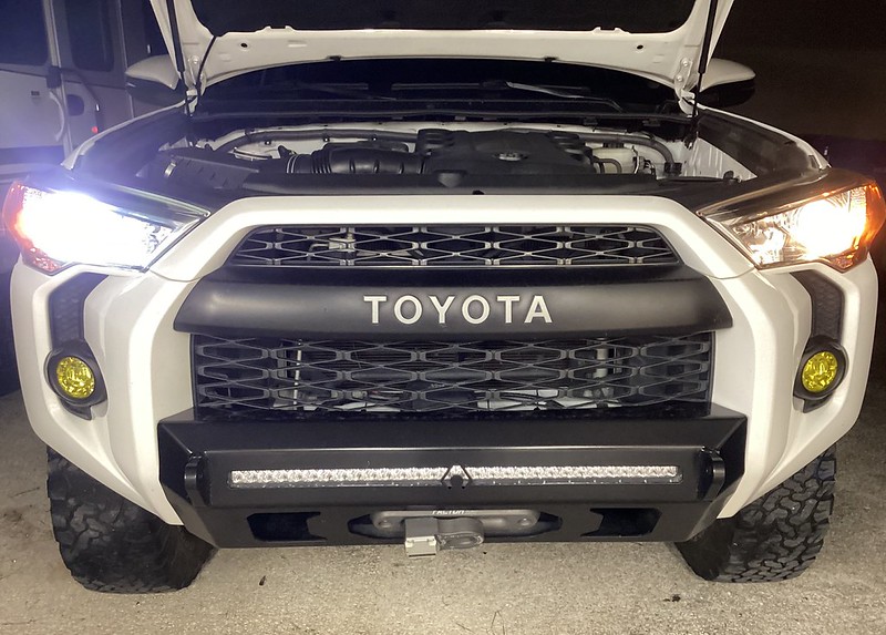

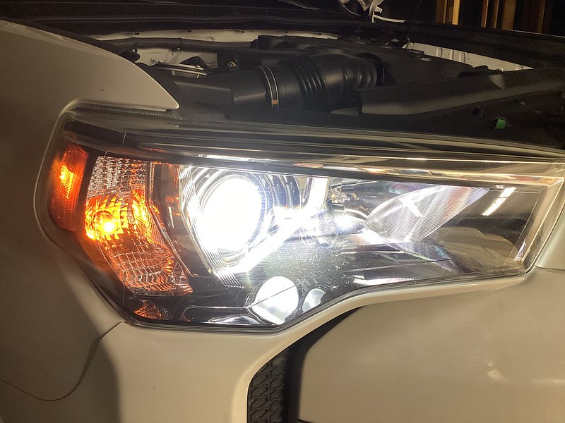

Here is a quick shot with the LASFIT installed on the passenger side with the stock halogen bulb from my 2017 4Runner still in the driver side.
IMG_0073 by EricT4R, on Flickr
Stock Halogen
IMG_0075 by EricT4R, on Flickr
LASFIT H11
IMG_0074 by EricT4R, on Flickr

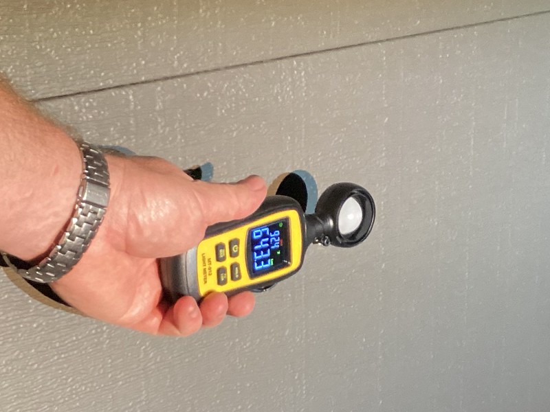

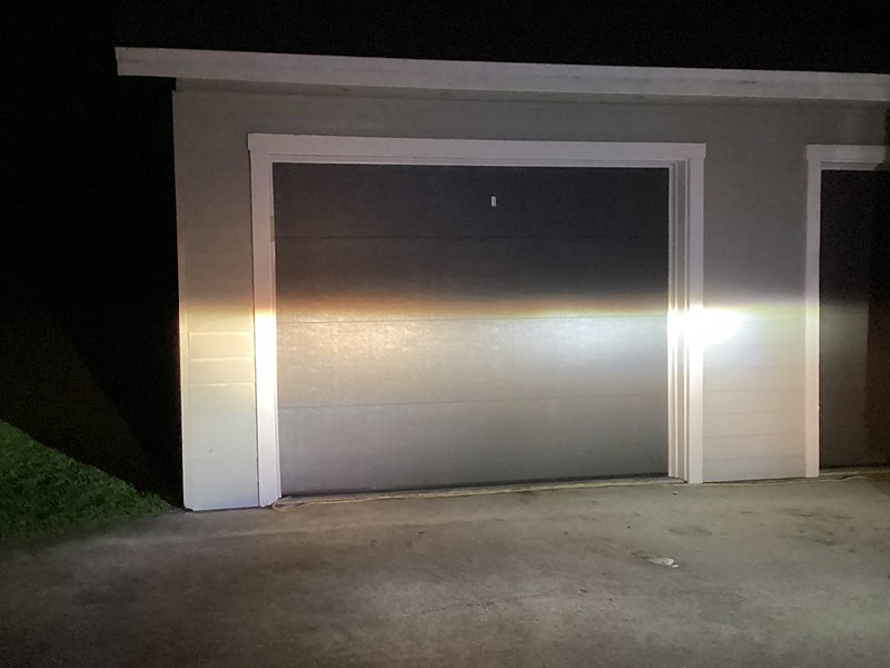

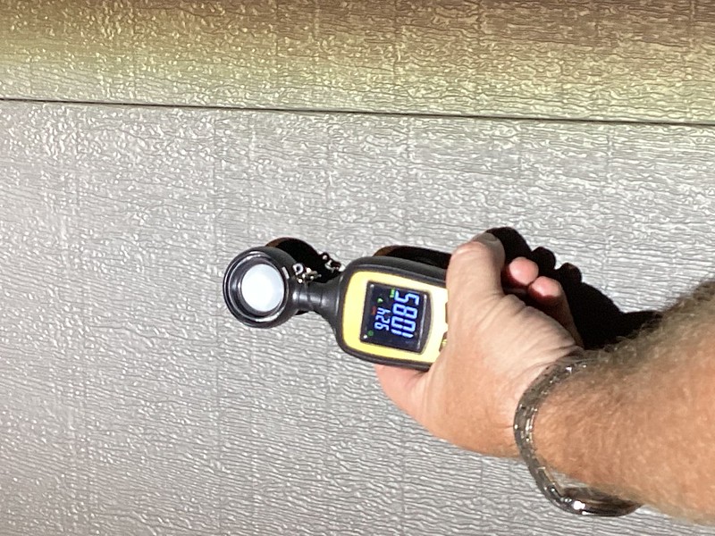

With one of each bulb still installed as above, the next two photos show the Peak Hold LUX reading from about 25 ft. away on my workshop door. I moved the meter around in the beam pattern to find the brightest area for both bulbs. The LASFIT LUX reading is 1085 compared to 643 for the factory halogen according to this Amazon lux meter I picked up for this test.
IMG_0089 by EricT4R, on Flickr
IMG_0091 by EricT4R, on Flickr
The cutoff line for both lights is very similar. I did not make any adjustments to the housing for this test.

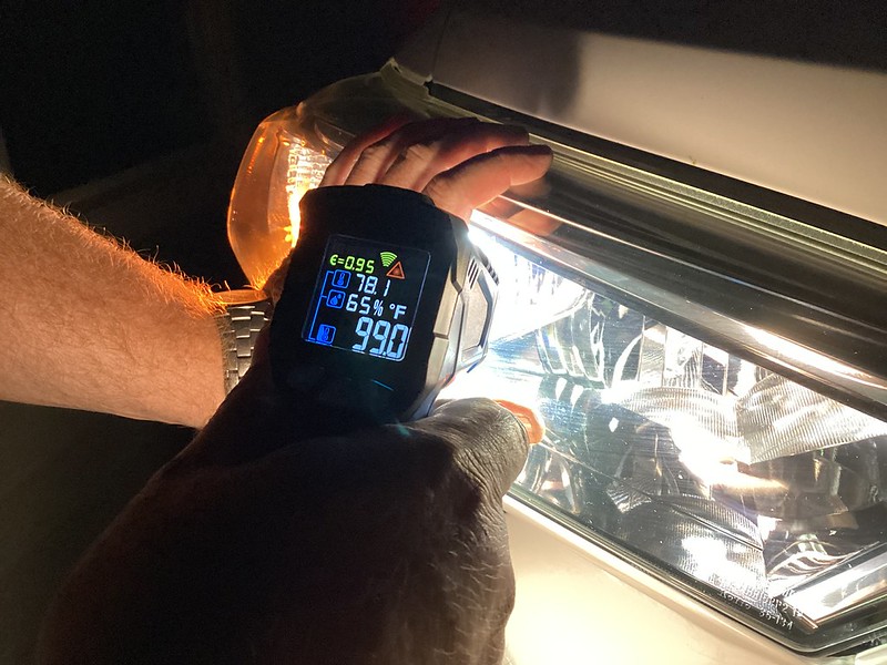

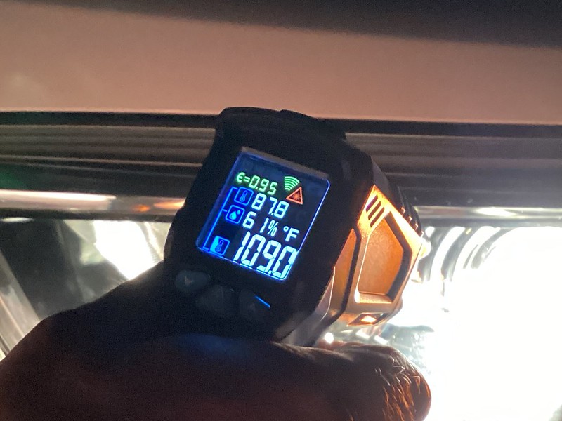

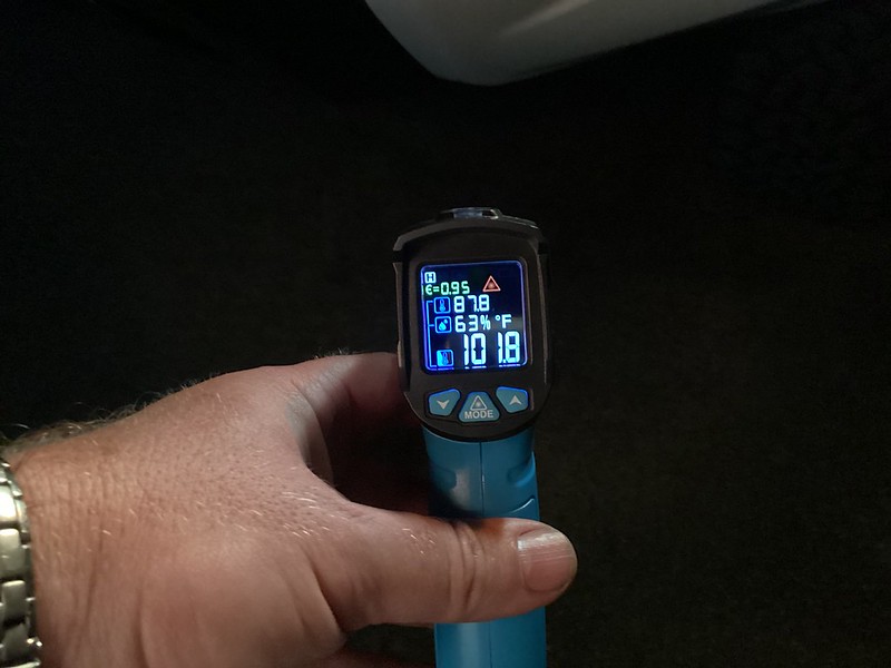

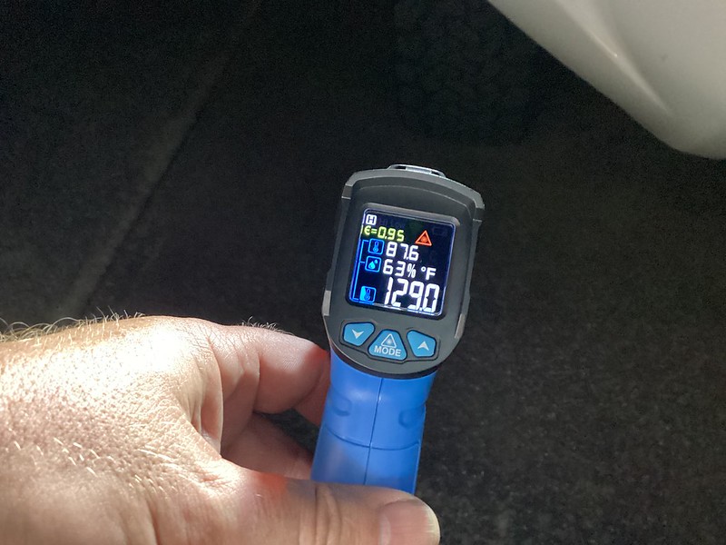

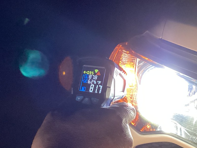

I had not driven my truck anywhere today so both housings were at the same temp when the LED was installed in the passenger side for testing. These next few photos show the temp gun readings I got right in front of the bulbs, and on the back of the dust cover. These readings were all taken back to back so the run time for both headlights was the same other than the few seconds it took between measurements. I pulled the temp gun out from under the hood after getting the dust cover readings just to make it easier to photograph.
Stock halogen front
IMG_0092 by EricT4R, on Flickr
Stock Halogen Dust Cover
IMG_0096 by EricT4R, on Flickr
LED front shown for measurement distance consistency only. My 10yo son was helping me get these pics with his Ipad and I think he deleted the photo I needed. I was getting 98°F on the front of the LED housing so the housing is staying cooler than with the Halogen.
IMG_0093 by EricT4R, on Flickr
LED Dust cover temps, you can see the bulb is running hotter than the halogen, but the fans in the dust cover are doing their job pulling the heat out of the housing.
IMG_0095 by EricT4R, on Flickr

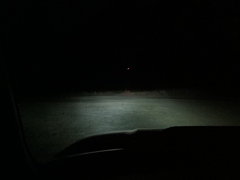

All of these driving photos are just with the LED's. I'm disappointed with the moving shots from the Ipad but I can honestly say the headlight output is drastically better than stock without being obnoxious. I drove around for about 30 minutes and did not have anyone flash their brights at me. These seem to cut through street lights better and not get washed out. They also seem to have more consistent and full beam pattern illuminating the sides of the road better. I don't feel like I'm overrunning my headlights or straining to see at night anymore.
IMG_0107 by EricT4R, on Flickr
IMG_0111 by EricT4R, on Flickr
IMG_0123 by EricT4R, on Flickr
IMG_0127 by EricT4R, on Flickr
IMG_0131 by EricT4R, on Flickr
After the drive I pulled out the temp gun again and shot the same passenger housing and it was now only reading 99°F after running around all this time. There was no issue holding my hand on the housing.

No, this is just a cheap meter I bought from Amazon for the purpose of trying to quantify the maximum output between the two lights at the same distance. This test wasn't performed to any industry standards or with calibrated equipment, it was just meant as an apples to apples comparison and not a lab grade measurement of the exact LUX output.
Amazon.com: Light Meter Digital Illuminance Meter Handheld Ambient Temperature Measurer, Range up to 200,000 Lux, Luxmeter with 4 Digit Color LCD Screen : Electronics
You can tell from the photo of the door, and referencing the panel joint of the garage door in my two meter photos the maximum light output is roughly at the same height for both bulbs.
The beam patterns on the door and the shots in my backyard are all I can offer without trying to set up some elaborate test plotting the light output at different measurements. I should have noted before that the truck did not move in the photos from my yard. I took the shot with the halogens, then R&R the bulbs with the LASFIT H11's and took a second shot within a few minutes. Both shots were with the truck running @ idle and no accessories running on so the battery voltage would be the same. I should also note that the ground in my yard is not even, what looks like a hot spot in the LED photo is where there is a high point on the ground.
