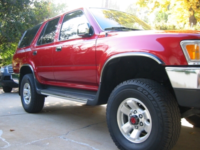

Will these fit on my second gen? (wheels)
These are from a Tacoma
The wheels are 15X7, 6 bolt. And the tires are 31X10.5
" The wheels are 15X7, 6 bolt. And the tires are 31X10.5 (shot)" quote from the seller..

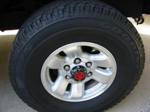

The center caps for the front wheels probably won't fit. I drilled mine out and sprayed the dust cover silver. Looks pretty good. Check out my post titled "pics of my 94...." for pictures.

Yes they will fit, they will stick in about 1/4 inch than the standard steel and al. wheels for that gen offset. You can get a spacer but you need to check the lugs every once in a while, but it will look a lot better. The oem center caps will not fit. If you have manual hubs you can hog out the middle and paint then again if you have auto hubs, you can get a T100 center cap and it will fit perfectly in the middle and you will still have the auto hubs covered with the TOY logo. If you have a man hub and want a clean OEM looking center cap made for the man hubs, call Long Beach Toyota parts dept, and tell them what you want, they sell a nice pair but they are pricey...about $25 ea. I talked them down to $30 for two. good luck...YMMV.
Got em this morning..
I think that they make my truck look better and newer. The guy paid 2000 from the dealer for them originally..
