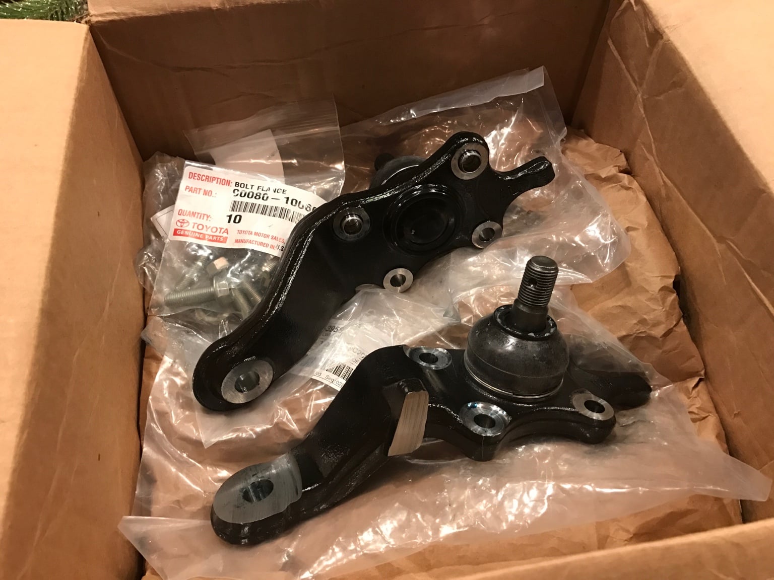

I am creating this thread as an informational "tool" for those of us who are looking to do their 4Runner's LBJ's,UBJ's,CV Boots Etc. (Most of the Exposed and aging Rubber on the front end of the 3rd Generation 4Runner)
Below is a list of Part Numbers for Ball Joints and other things that are most likely to be done while doing Ball joints.
Tell me if you have any part numbers I should add, Thanks!!

That's not an OEM LBJ, BTW [emoji6]
