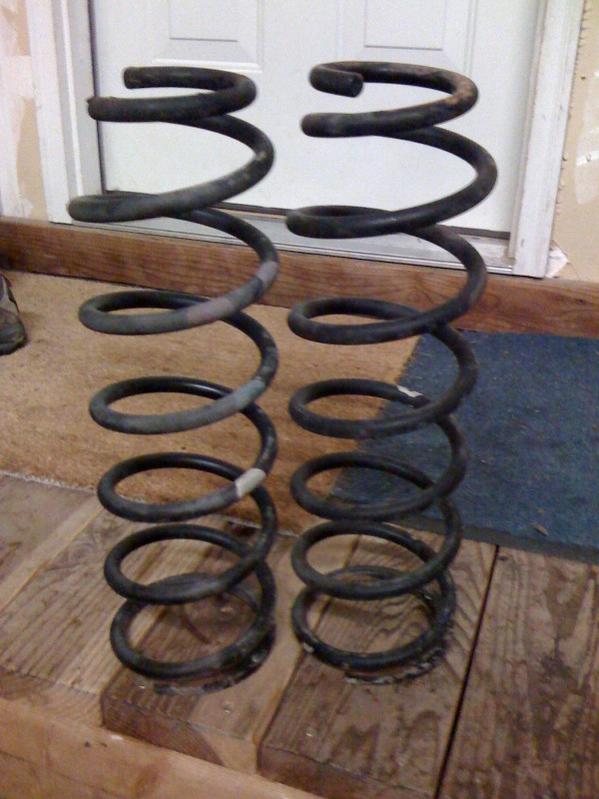

tmaxx13
Can someone tell me how many wraps these coils are, i dont know exactly how to measure them by looks, since someone sent me an email of ones they are selling, i think they are 7 wraps maybe 7.5

Height of spring/color code/wraps
* 21" Blue Pink White 9.25 wraps
* 21" Grey Orange White 9.25 wraps
* 20.25" Blue Yellow White 8.75 wraps-one of these is a confirmed LX450
* 19.5" Green Yellow White 8.25 wraps-one of these is a confirmed LX450
* 19.5" Purple Green White 8 wraps
* 19.25" Double Purple Dark Blue White 8 wraps
* 19" Double Pink Light Blue White 7.5 wraps
* 18.5" Double Pink Grey White 7.5 wraps
* 18 7/8" Orange Orange White 7.75 wraps
awesome thanks for the help, going to pick these up today and bought some Tokico GE4095 for$70 shipped, just need to find a garage to do the install my self! looks like ill have a project for myself this week!
