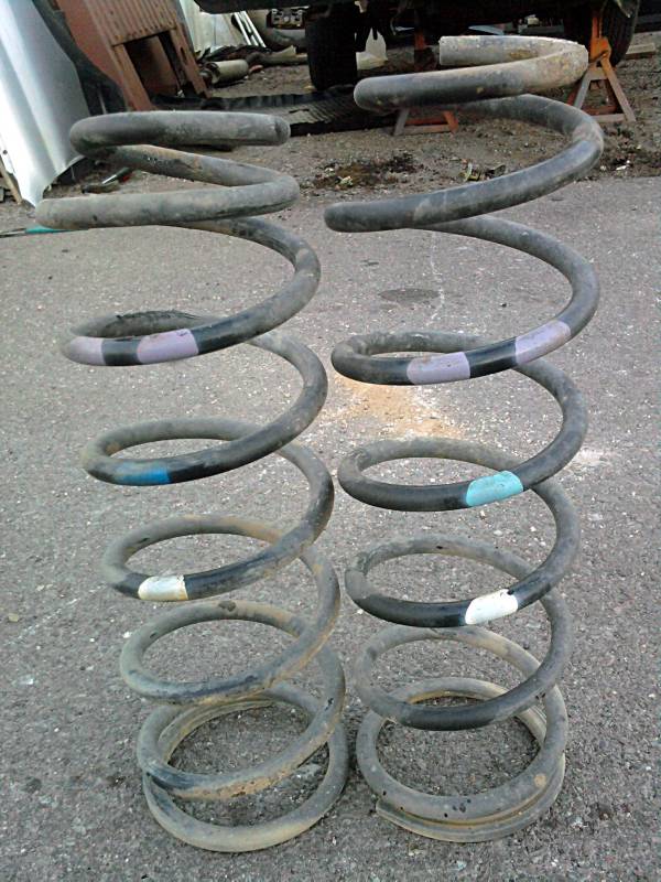

ok so im going to buy some lc coils and I looked at the chart and double purple dark blue white show something the other one is double purple light blue that is just the side it needs to go on right?

good that is what fightman said just wanted to make sure score and 35 for the pair lift coming soon

Are the ones you posted in the first pic the ones you're getting? Those are the 7.75 wraps I believe, as I just purchased a set of them from Cali, glad to know that the taller one goes on the driver's side.
19.25" Double Purple Dark Blue White 8 wraps

I don't know about you guys, but that LH coil in the picture looks bent on the top. The coils may be different lengths but the longer coil shouldn't be over 1" longer? Maybe it's an optical illusion, but the length difference isn't so dramatic on any of the coils I've seen.

Oops, well that's a nice surprise, now I'm getting 8 wraps for pretty cheap then.
I would have to agree with prospectator. The spring on the left looks bent. Look at the distance between the wraps at the top. It looks like it's collapsed. I would be careful with these.
