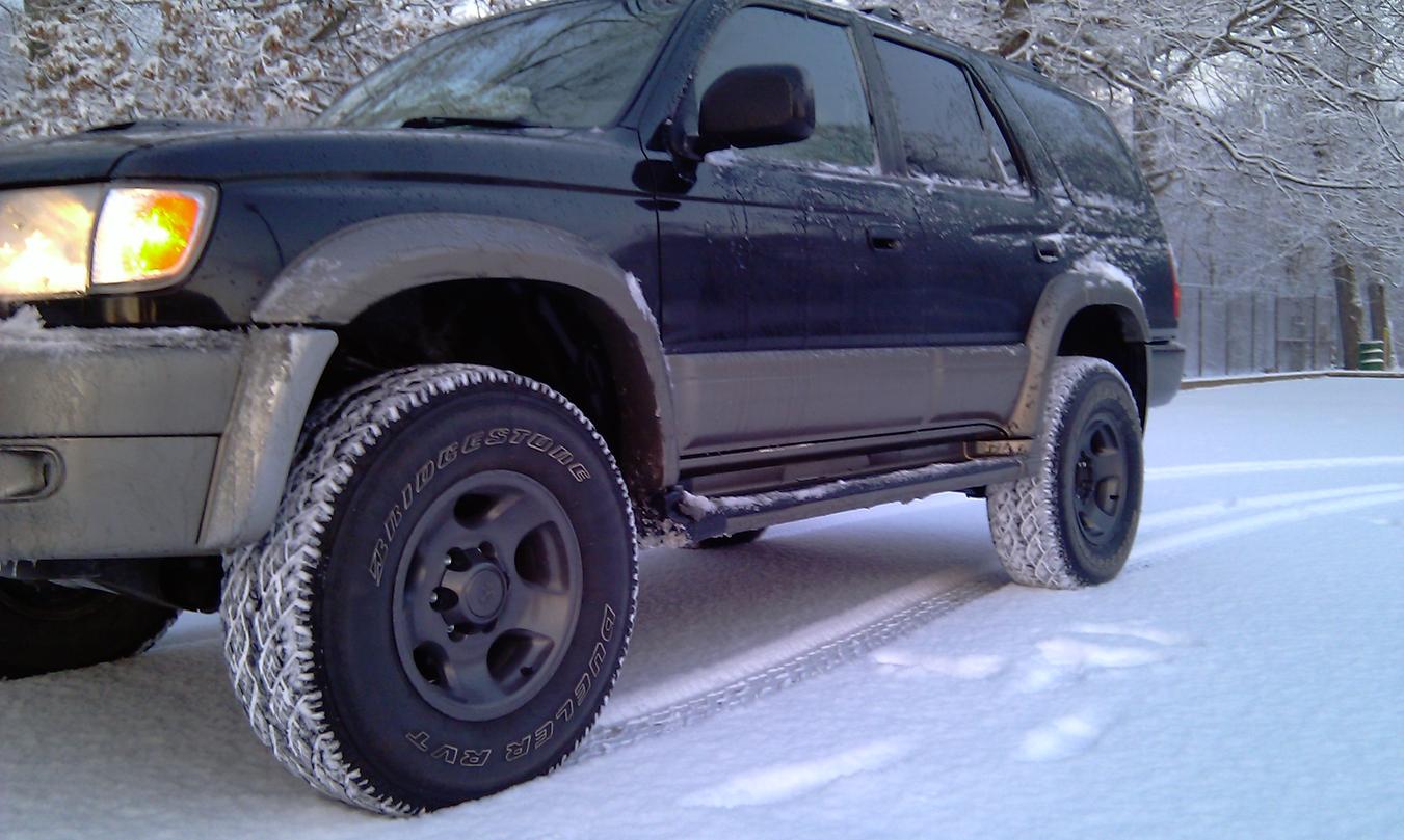

Will '93 Land Cruiser rims fit over the stock brakes and have similar backspacing to the Limited coke bottle rims? Also, will 285/75 Terra Grapplers fit? I'm about to pull the trigger on a sweet set of them online and just want to make sure. I've seen pictures of them on 3rd gens in the past but none recently and just want a bit of confirmation before doing anything silly.
I'm not sure about those rims buy they have a little less back spacing than the 5 stars. Also being a 8" wide rim those 285s will work fine and set out a bit futher from the a arms.
the LC wheels fit perfectly and as mentioned,will move the wheels a bit further from the A arms and would sit flush with the flares on the limited....it gives a perfect stance specially when you're lifted...
i'll be fitting the 285 75 16's terra grapplers too sometime in the future(running 265 75 16)...
bought these on craigslist around your neck of the woods(reston,va) for $200 recently and painted them dark smoke metallic.
btw: if you're going to do the tundra big brake upgrade(231 calipers) you'll have to grind some material off the backing part of the wheels-not too bad of a job and doesn't affect balance or strength.
also,you'll definitely need the acorn style wheels lugs.
gl
