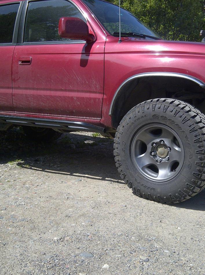

On stock suspension you can run 265/75-16 and the same will mount on an 8" wide wheel. Unless you lift before you install tires and wheels, 265/75-16 are it (unless you go smaller 265/70-16)
I am happy with my Duratraks 265-75-16's
For right now you could go with the 265/75-16s or the 70-16s like stated above... Just depends on what year you have. Some years sit higher while others sit lower.
After your lift I suggest 285/75-16's as they fit perfect with a 3" lift. I myself have 285s with the lc wheels and have no problem. Then again, I have a 2" body lift on top of the suspension but prior to the body lift they didn't rub at all.
I also have the LC wheels with 285/75/16 and a 3inch lift and think they look nice. If you plan on lifting it soon (within a year) I would try and wait for the bigger tires if that is what you are into. Post up some pics either ways.

Go with the 265-75-16 if it's going to be your DD, thats what I did and I love the outcome. Only on RARE occasions do I wish I had the 285's, plus the 265's save at the pump EVERY time.
Here are my LC80 wheels after I painted them and got my new tires:
265/75/16 on LC80 wheels, before lift:
