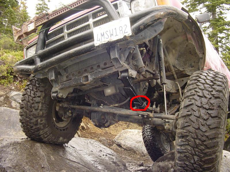

My rear springs have a bracket that locates the springs next to eachother, with a plastic roller on top. Sounds like you need a couple of those. If you don't know what I'm talking about, I'll snap a pic the next time I'm near my truck.
I think I might have something like that. It's like a piece of steel that is bent around the leaves. It is not tight around the leaves, there is some play.
Not my truck, but a random internet picture I just found.

Might be. The noise is in sync with that movement.
I think the rear one of those clamps is looser.
I have some of those metal tie downs for strapping stuff onto fork lift skids. I'm thinking as a test i can try to strap them in tight, and turn the steering and listen for a change.

If you mean the leafs are fanning out (pivoting around the center bolt), it happens if you don't have those clamps (bands) around the pack. Or if the center bolt isn't tight enough.
Mine fan out a small bit over time, and a whack with a hammer lines them back up.
If it keeps happening a lot, time to check the center bolt.
If you mean the entire pack is moving around as you turn, that's a problem, the u-bolts may be loose.
I will check the center bolt. The leaves do always move back into position.
Can that band be squeezed with a vice or something to make it tighter? I've seen similar bands for between 3.99 and 11.99 for sale online. Or even a ubolt with a flat plate onto.
Thanks everyone. Weekend is here I can check this stuff again.
You don't want the band completely tight around the pack, the leaves won't be able to expand properly when flexing.
If you look at the pic you posted, the band you circled is riveted to the top leaf, and it is open enough so there is plenty of room for the leaves to expand.
