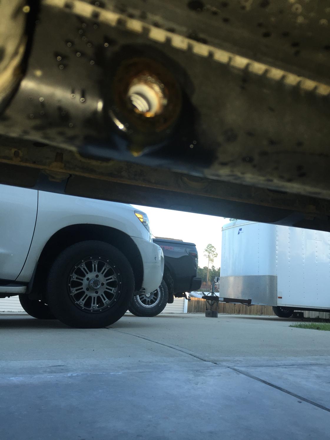

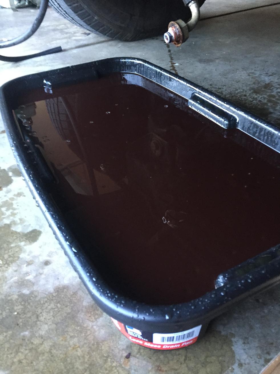

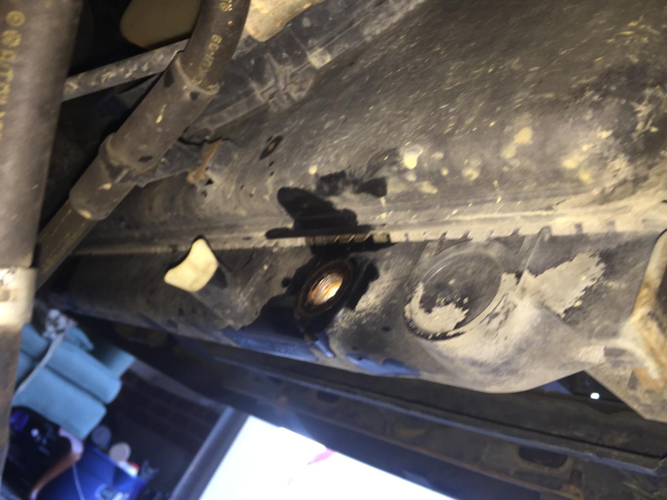

So I was making my way to get my B&M 70264 transmission cooler put in. Got it all mocked up, and mounted to satisfaction, ran the new lines down through the hole in the passenger side like many other people have done. From there I climbed under the truck, and tried to pull the passenger side line off. I couldn't get it to pull off, so I removed the fitting it was attached to, and out came cherry juice. Wasn't really surprised, and pretty much expected it. Tried removing the rubber hose from the metal line attached to the transmission and couldn't get it, so I figured I would move on and just remove the other hose and let the 1 quart of cherry juice that was going to run out do so. That way I could then just focus on dealing with getting the hoses off the metal transmission lines and getting the new hoses connected. Well as I pulled the other fitting off with the hose still attached, the fitting started pouring out cherry juice, again no surprise, but the radiator started pouring antifreeze out of the same hole. This is where I had started with concern. The first fitting had transmission fluid running out of the radiator and the fitting, the other had antifreeze coming from the radiator, and transmission fluid coming from the fitting.
I am really at a loss right now, not too sure what to do with it all, or what exactly to think. Transmission fluid looks normal on the dipstick too, not the milky ish color in the pan that is under the truck right now.

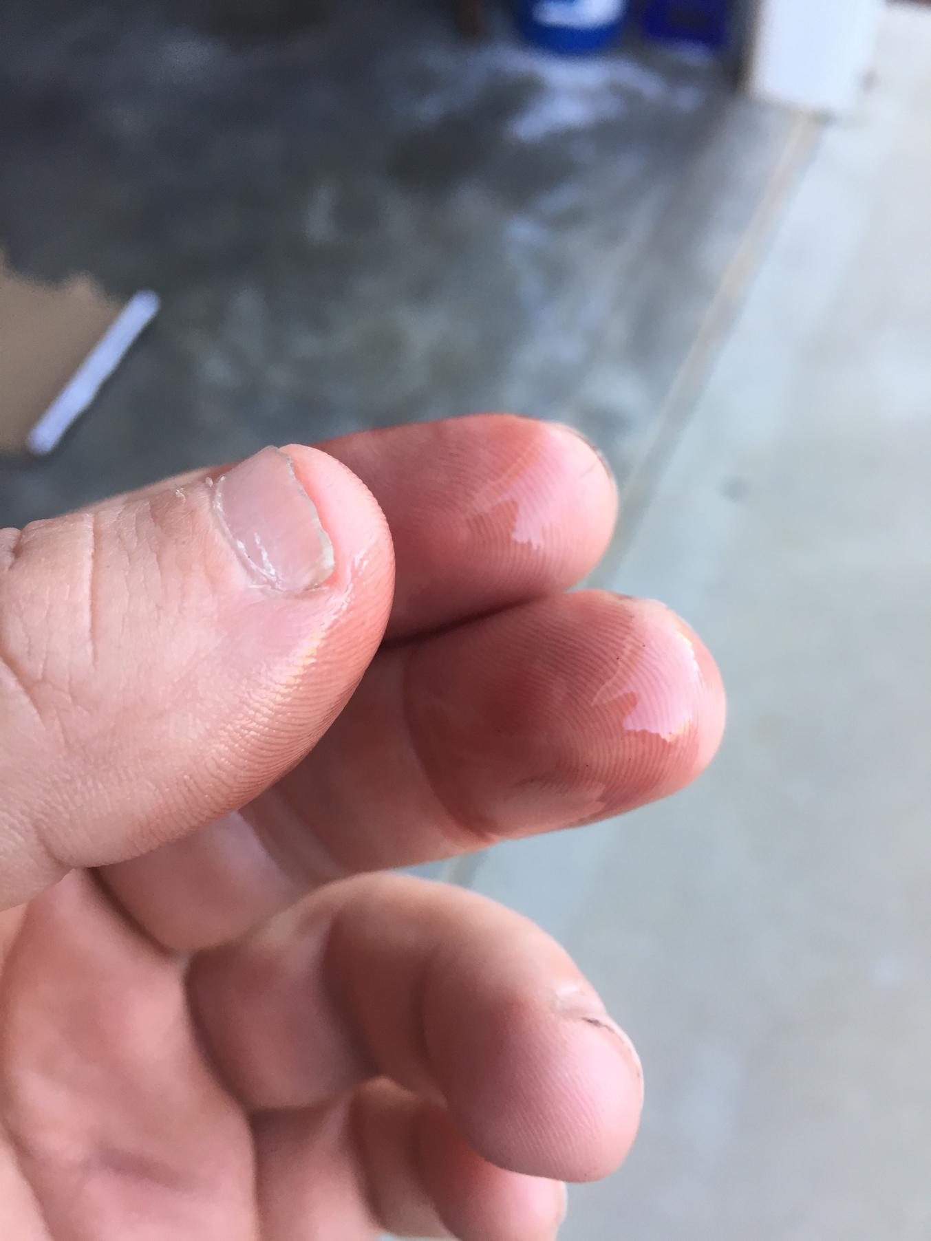

Pictures are in order of how I disconnected it too, and thats how clear the trans fluid on my fingers is. I am all ears for ideas and or anyone that wants to show me how to fix it.

Welp from what u have provided I don't think your grave is dug just yet, but maybe your part list may have grown instead, I would pickup a new radiator and have a trans flush done.
When you go to flush just get a 5 gallon bucket of fluid it will be cheaper. Just cycle new fluid and have the old go into an empty bucket. That should be enough fluid to clean it out.
You are one lucky guy. It looks like you broke the radiator when you removed the fitting. The ATF looks old but not contaminated. Buy a new radiator and flush the tranny fluid. Its due.

That's exactly what it sounds like. You did indeed get very lucky. I'm glad I bypassed my stock radiator and put my cooler in. It gives me peace of mind. It seems like this issue is becoming more common as the trucks get older, which should be expected.
I had a similar issue when when to put on my transmission cooler. As I was pulling the transmission hoses off of the bottom of the radiator and one of the fittings just popped completely out of the radiator due to the corrosion inside and coolant came pouring out. I was right on the verge of the Pink Milkshake and I probably just barely dodged that bullet. Per other posts put a new radiator in. I just bypassed the new radiator all together

That fluid looks pretty healthy.

This exact thing happened to me yesterday. Had a slow drip from the fitting where it connects at the rad. Saw the fitting was loose, gave it a light tug and the whole fitting just popped out like rockyMTN mentioned.
At first it drained a little bit of clean trans fluid out, tried to see if i could re-insert the fitting and it just started pouring out coolant mixed with the trans fluid in the cooler, same color as shown in jstim's pic.
What I find odd though is that after I let it all drain out from the fitting, I opened up the petcock valve to see if everything had drained and I got about 1/2 qt of perfectly clean coolant drain out into a separate container.
My dipstick for the trans is clean as well and so is the overflow tank. Like jstim said, I'm at a loss, especially after seeing clean coolant drain out afterwards.
