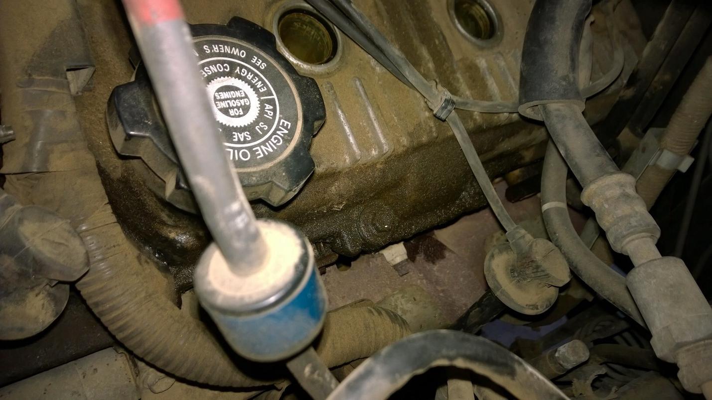

While changing the spark plugs on my 4Runner. I found what looks like leaks coming from my head gasket? Am I right in saying this is the head gasket. I've only been a armature mechanic thanks to things I've learned from this forum.
Thanks for your help

That's a leaky valve cover. You'll have one on either side. My passenger side looks like yours but my driver side is clean. Won't cause many problems but definitely not something you want to ignore.
Yep, that's the valve covers. I just ordered all the parts from Camelback Toyota to fix mine. It was $120 shipped for all of it.
Here are the all toyota parts list.
11213-62020 valve cover gaskets x2
11193-70010 spark plug grommets x6
12204-62010 PCV valve
90480-18001 PCV grommet
90210-05007 washer seals x16
17176-62040 plenum gasket x2
11188-62010 cam seals x2
The next part is not necessary because they are aluminum and reusable but here is the number if you wan new ones. I didn't order these
11183-62010 semicircular plug.
