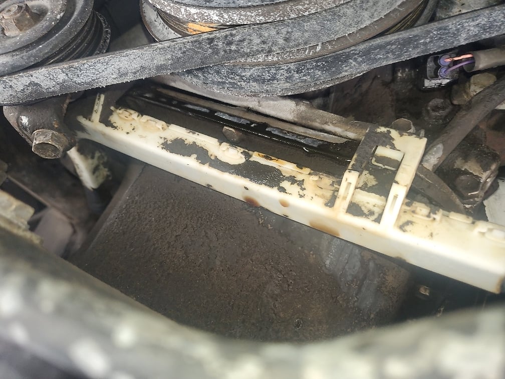

Here's a picture after cleaning it with degreaser a few times and spraying with a hose last night. It does look like the seam between the oil pan and block is a little wet still, don't know which is worse front main or oil pan gasket [emoji2363]
Sent from my SM-G970U1 using Tapatalk
Damn, that looks like oil pan leaking. Does the pan have fipg or does it look like a cork or rubber seal. Either way it should be fixed as if it leaking sitting there then it is quite bad.

I'm not sure what the gasket is, I'm really not stoked about dropping the diff. I'll probably take it to a local mechanic to verify that's the issue before I decide if I want to try to do it all myself or just bite the bullet and have a pro do it.

I would use a mirror and a flashlight to look under the crank pulley. You should be able to see if its leaking from the front main seal or if it is the pan.
Personally, I'd rather do a timing belt job and replace the seal than drop the front diff and screw with the oil pan. The seal is very easy to replace but you do have to take a bunch of crap off to get to it.
If it is the pan that is leaking, you could try re-torquing the pan bolts in that area. Maybe they are just a little loose.

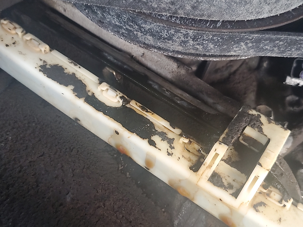

Update: seems like it's definitely the oil pan in the front. Can't really see any oil between the crank pulley and the lip of the pan but lots of oil below the lip.
Also, any tips on removing the wire loom holder so I can tighten those bolts?

There's a 10mm head bolt on each side above it. Not sure how easy it will be to get off there with all the accessories in the way...

im thinking its your pan...reason or question is why...was it broken loose for something...is this a common problem ?

Yeah I got both bolts out but there's not enough room to move it even when it's unbolted. I was able to tighten all but one on that side closest to the passenger. Hopefully that does the trick otherwise I have no idea. I'll have to bite the bullet and bring in a pro.
