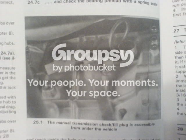

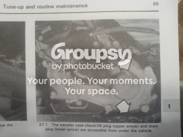

I'm going to see a friend tomorrow that is a mechanic, and I want to drive my truck out there, problem is that I think the transfer case has gotten low, as last time I drove it felt like the 4wd shifer was getting hot. I want to fill it just to be safe, and I need to know what to put in there, as well as where the filler cap is. I'd like to check the transmission too, as I know there are transmission problems, and I want to be sure I'm not just low on oil....
Where are the transmission and transfer case fill plugs, and what do I fill them with?
Once you get under there, you'll find them. The Tranny plug is on the driver's side of the case. (14-17 mm) It's the lone 'bolt' on the side, nearer the top than the bottom. There has to be a similar on on the case. (look at the 'front' of the case.)
Not sure what to fill it with, mine has no bookage.
Here you go..
