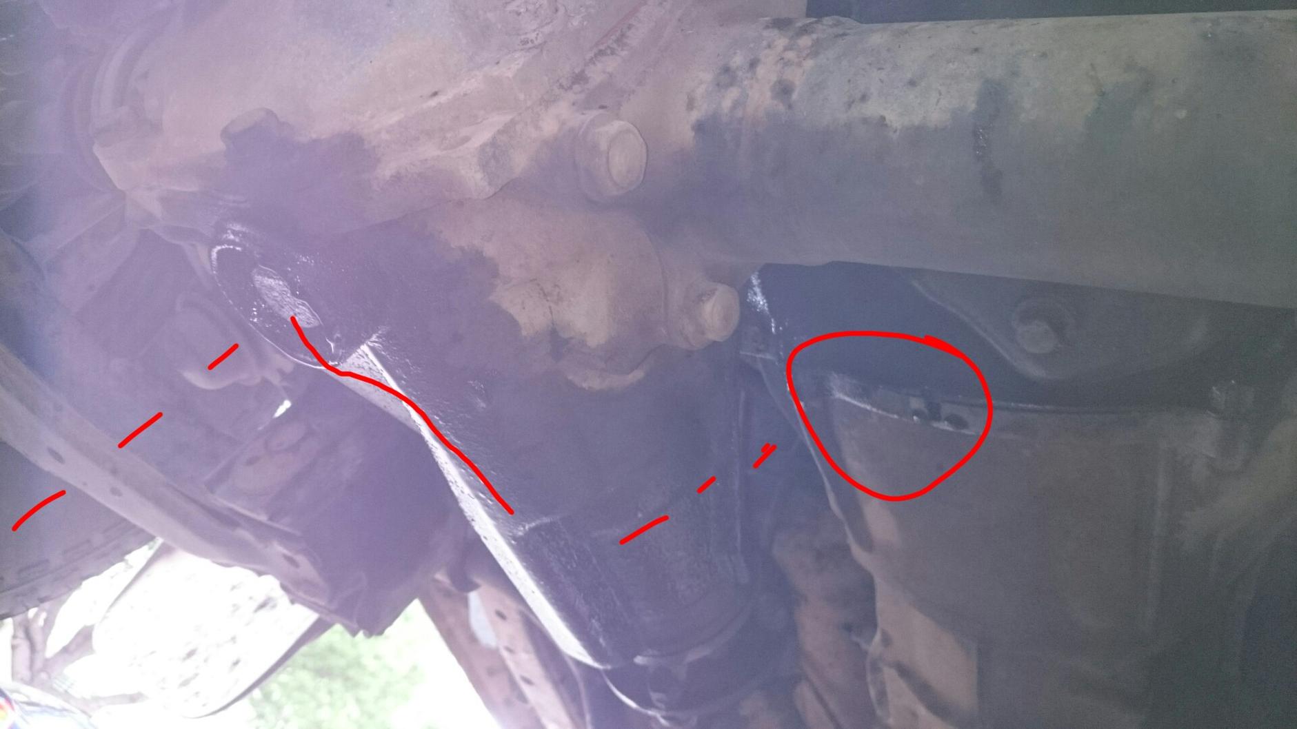

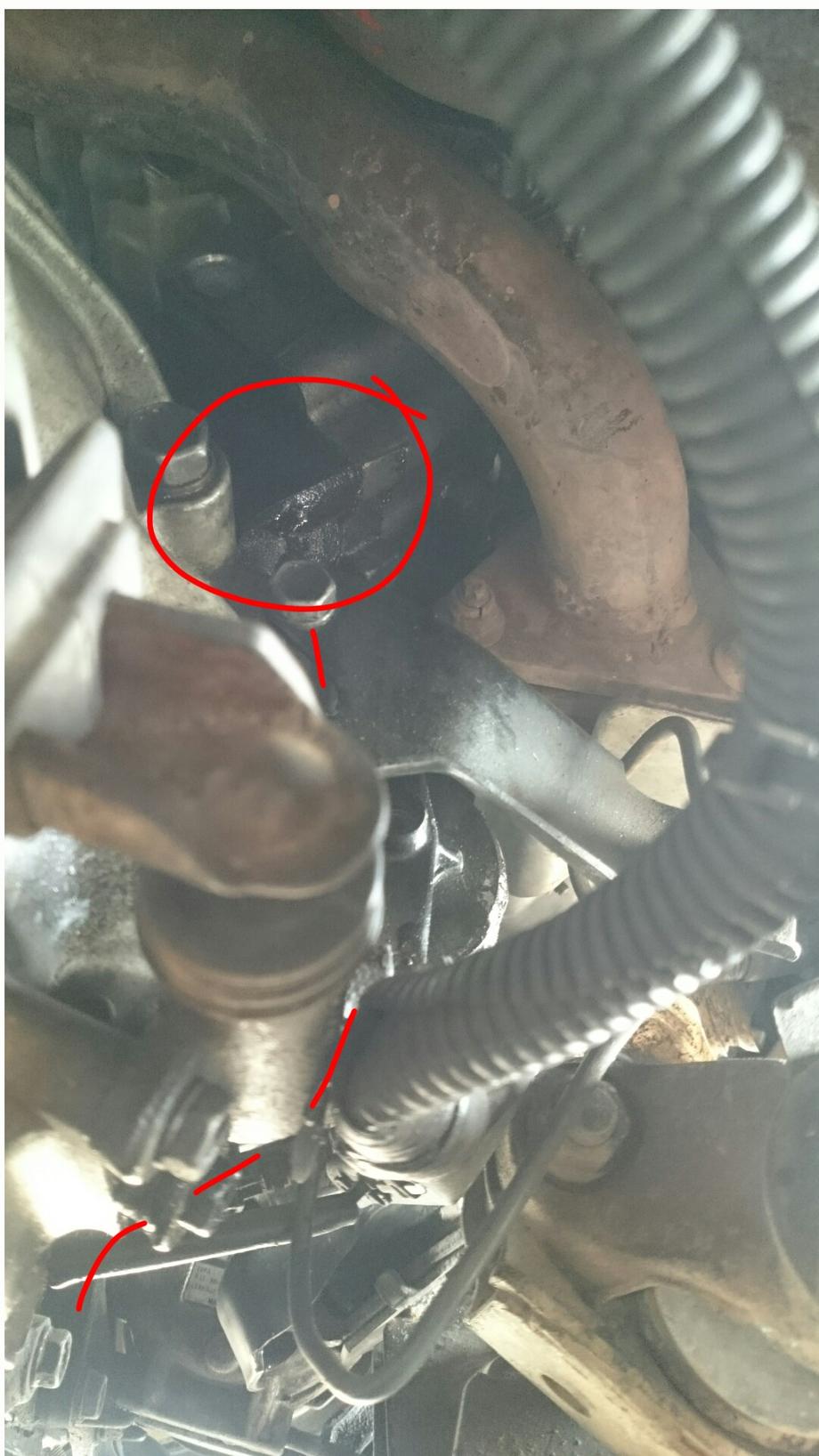

Hi guys.
Just came out of the shopping centre to my car and saw a few drops of oil.
Got under and had a look and got a few pics for you to have a look at.
I've circled where I think the oil is coming from and then dripping down and allong and then eventually to the floor.
Please let me know what you think it is.
Thanks

Valve cover or rear main, likely. Wait until the motor is cool then reach down between the valve cover(s) and the firewall. If there's oil on top of the bell housing and behind the motor, it's a leaky valve cover. If not you can start swearing and kicking things.

Assuming you don't run low on oil, you can keep driving it. If you just had that motor installed though, I'd take it right back to the shop and tell them to fix it.

If it is the rear main, you'll need to pull the motor or drop the transmission to fix it. There's no big tech involved, but it's not a small job.
Don't borrow trouble though, go find where the leak is first.

My 3.0 had a couple sources: Valve covers were one source. And if you do them, make sure to use some sealant in the corners. I made the mistake of trusting the gasket alone.
And the oil cooler. It's not a fun repair, but not too expensive. Be sure to get all three o-rings/gaskets if you do it.

Don't rule out a tranny seal either! That photo of yours looks very similar to what I had back in '06:
This is what caused the leak:
And the part that holds the seal at the front of the w56 manual transmission:
Honestly, it was much easier to fix than I thought it would be. Unbolt trans and driveshafts, slide back, pull plate out, replace seal, reverse the process, done.
I think it took me about 2 hours to do the whole thing.
And if its not that, but a rear main seal, check for a groove on the crank where the seal rides. If there is a groove, get a speedi-sleeve for the crank! It will never seal right if there's a groove (yet another issue I had a while back!).

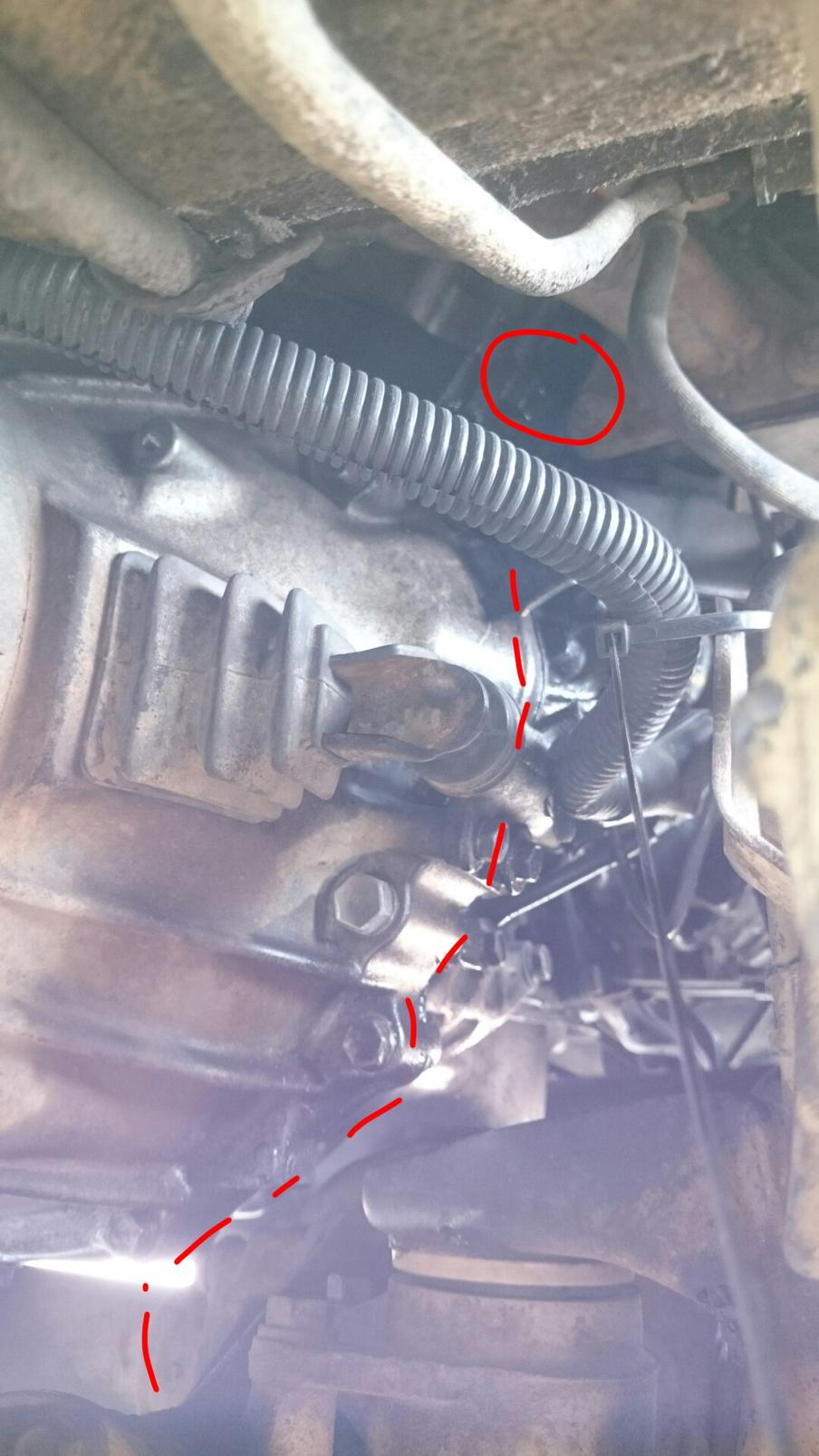

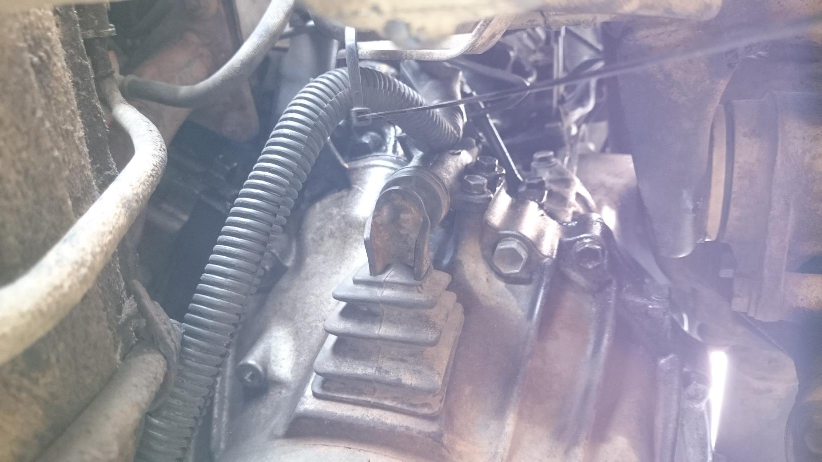

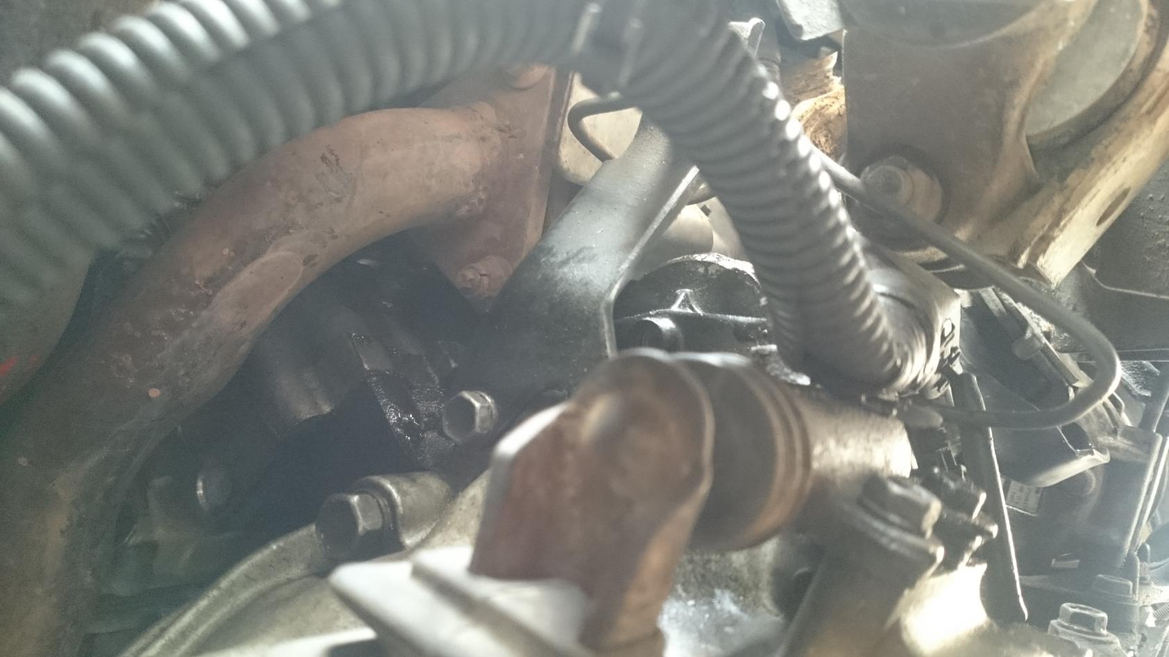

I've had another look in good daylight and I think it may be oil coming from the top of the engine somewhere.
When stood infront of the car looking at the engine the right hand side is dry and clean but on the left hand side there seems to be oil down the block and bell housing.
I've got a few pics to look at and have highlighted the areas again.
Looks like it's coming from somewhere behind the exhaust pipe you can see and then dripping down.

I think you can rule out the trans seal completely. Your rubber boot is dry and dusty, mine however, was coated in oil, along with that side of the trans!
