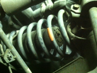

Single orange paint strip 2nd coil from bottom on rear both sides, paper wrapped around coil at top can't read as they are warn.

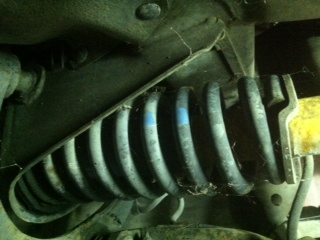

2 blue paint stripes 3&4 coil from bottom on front.

My Google-fu skills are falling short, that's not the same color that was on my springs either. If you can post a photo of the paint marks someone might recognize them and chime in.

After markets could but I just looked at the photo you posted of the front and rears. I also happen to have a box in my garage that has the stock springs from my 97. It's been a long time since I looked in that box so I just dug it out.
My rears have a single orange paint. My fronts have a double blue paint. You have the stock suspension. I also just measured the rears. Both are identical at 15 1/2" from floor to top of spring.
