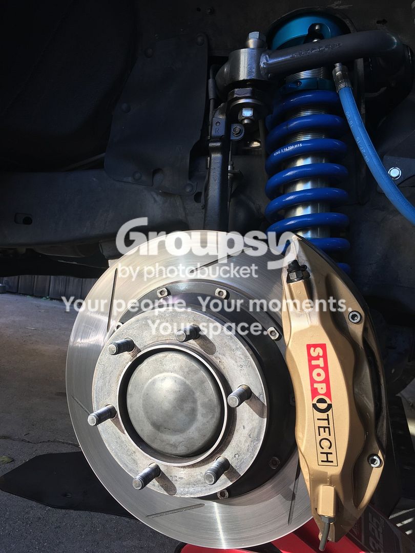

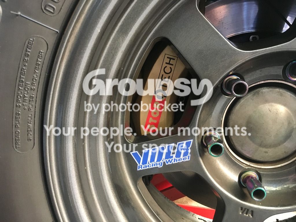

i run 12mm custom CNCed alcoa aluminum spacers that are hub and lug centric for the 4runner 106mm hub bore for the hubs and 111mm wheel hub bore on my wheels ( Non Oem) no issues and i run a stoptech Big Brake kit
734CE292-9FA7-4016-9AE7-99CA09E305B0.jpg~original
1203F675-68A3-4FF0-BEB2-C58C94F28D84.jpg~original
