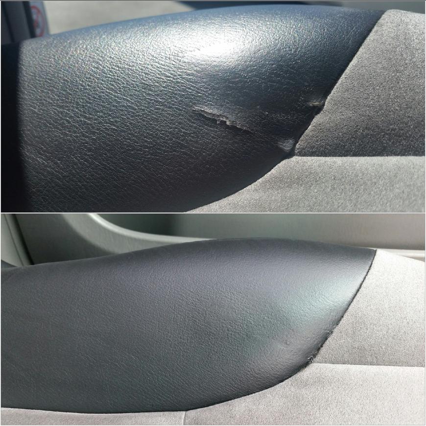

As part of the Urban Runner package, my rig came with pleather/Alcantara seats. I just had the driver side bottom pleather portion repaired by an mobile interior specialist. Here is a before and after.
