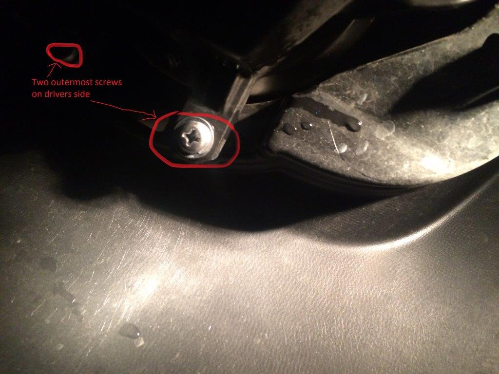

Be warned though, for the 2015 at least...removing the fog-lights; although you don't have to disassemble the front bumper and can reach from underneath; the housing used for adjusting the fog-light beam has a plastic tab that interferes with the twisting-out of the original factory bulb. It is a PIA but you have to remove two Phillips head screws that are paired on the outer-most edge of the housing (depending on whether driver or passenger side). The same inner-sided screw brackets are simply wedged into respective slots. Remove the whole bulb-reflector-adjuster assembly to be able to twist out the old bulb.

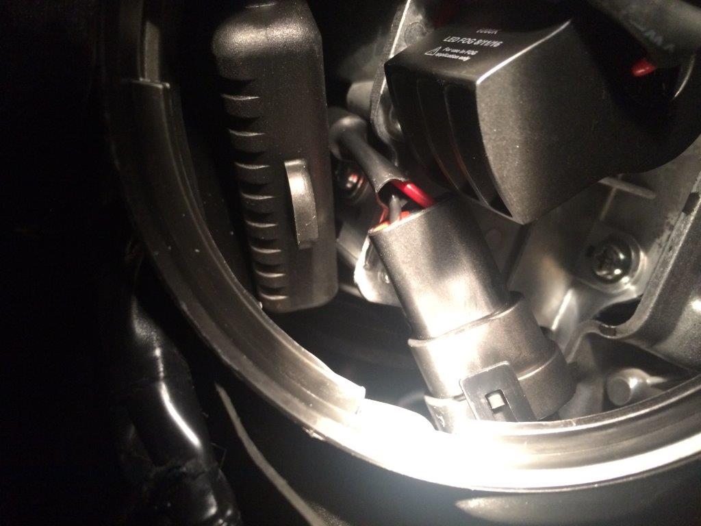

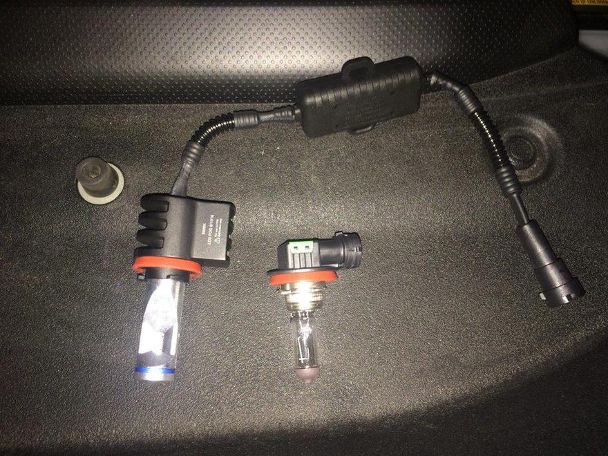

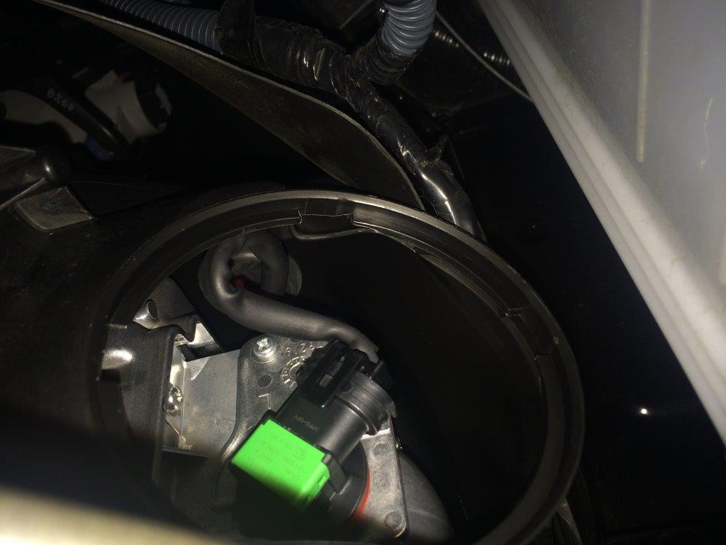

These pictures aren't the greatest but hope it helps:
First Picture is a side-by-side comparison of the factory and Phillips H11 bulb assembly
Second Picture is factory bulb in head-light housing
Third Picture is Phillips H11 LED light squeezed into head-light housing and yes the white cover that seals the headlights did fit back on correctly with no mods to it.

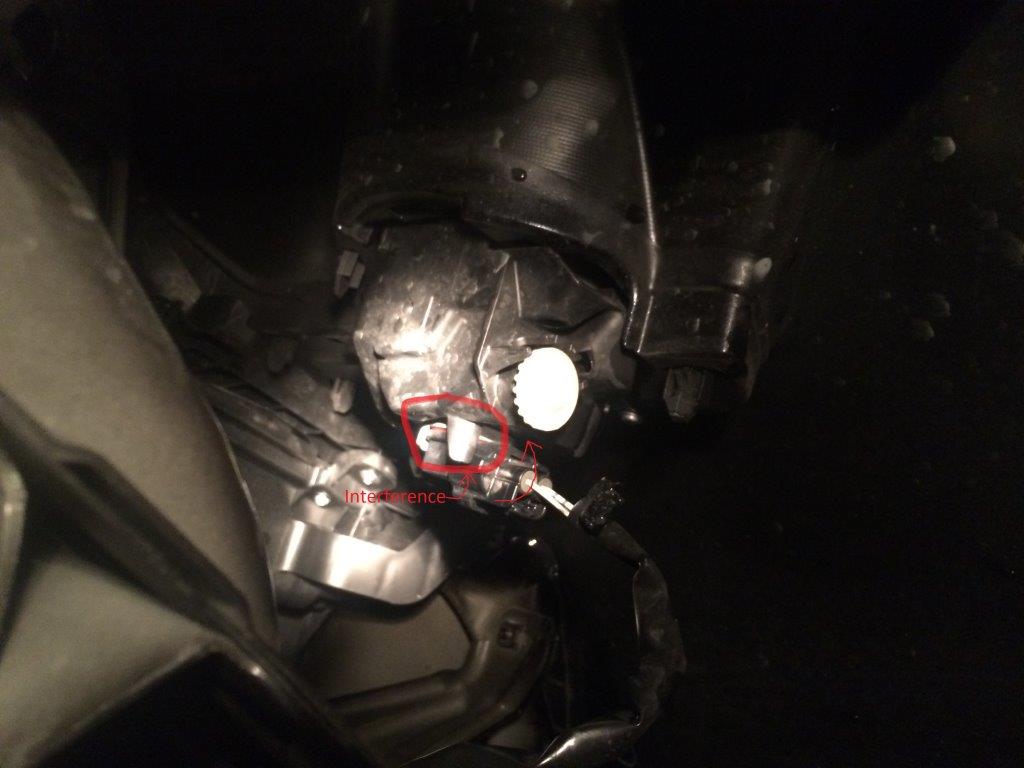

Fourth picture shows the interfering tab that keeps one from simply twisting out the factory fog-light bulb (maybe an anti-theft or tom-foolery feature?)
Fifth picture just shows the two phillips head screws one is dim like the dark-side of the moon.
WOAH WOAH WOAH!! All you have to do to remove the bulb is disconnect the plug for it and it twists right out! No need to remove anything at all! I installed mine in 15 minutes.
weird cus I didnt remove any screws on my fogs at all. the OEM bulbs came right out and the new ones went right in. that shield thing on the passengers side is there so there bulb/harness doesnt get wet since the passenger side fender well has slits in it and drivers does not
LOL! I guess I went too far and complicated things way too much all by myself!! I never thought to unplug the wire first! :redbrick::lol:
To believe I did it on the most humid night possible here in MD where I was upside down sweating into my own eyes trying to get those fog-lights out!
At least I'm glad I posted this so other could learn (including myself).
The new LED lights twist right out without having to unplug them! LOL!
