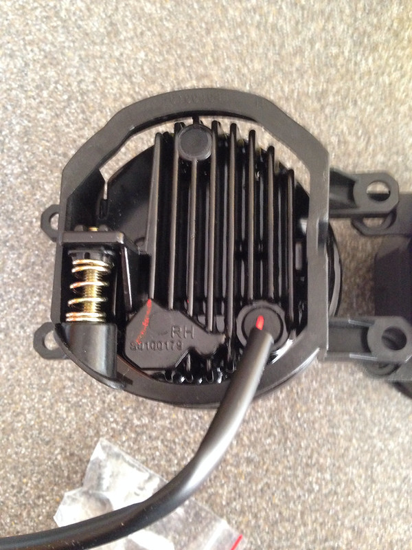

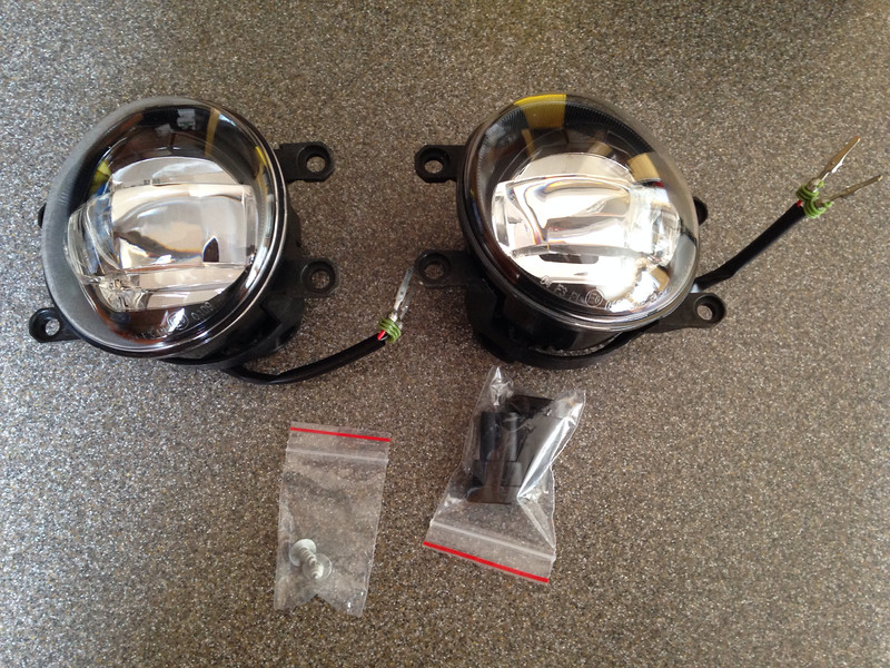

LED fogs arrived. Me likey
Got a few parts on the way, already put the N-Fab bars, wheels on the way.

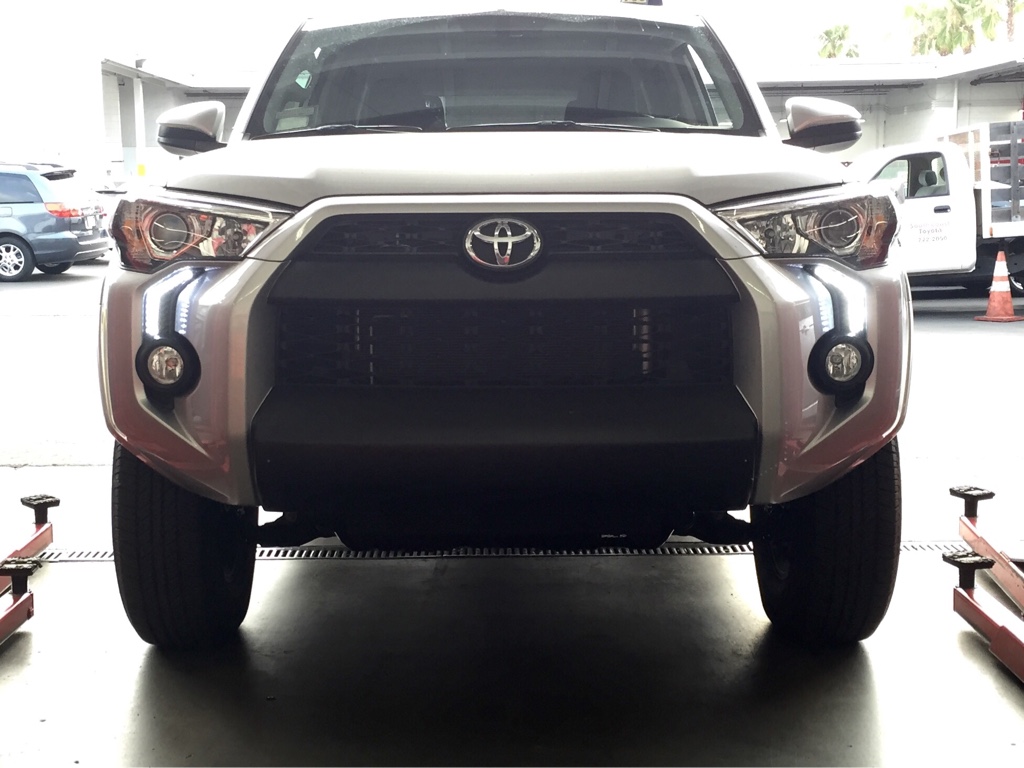

Really impressed by the Phillips LEDs. Also installed the reverse lights. Going to do the lows and high beams (with the capacitor to run the DRLs) in the next couple weeks. Perfect color temp, the low beams in the pic are sylvania ZXE for comparison. I didn't think those looked yellow till I installed these. Pricey, but worth it in my opinion.
Looks great! I know what lights I'm adding next. Will look great with the LED bezels I made.
looks great! I need to get a set when mine die... that price is a little steep at the moment for my budget... but added... No additional wiring for the leds?, jus tplug and play, and secure the little box?
