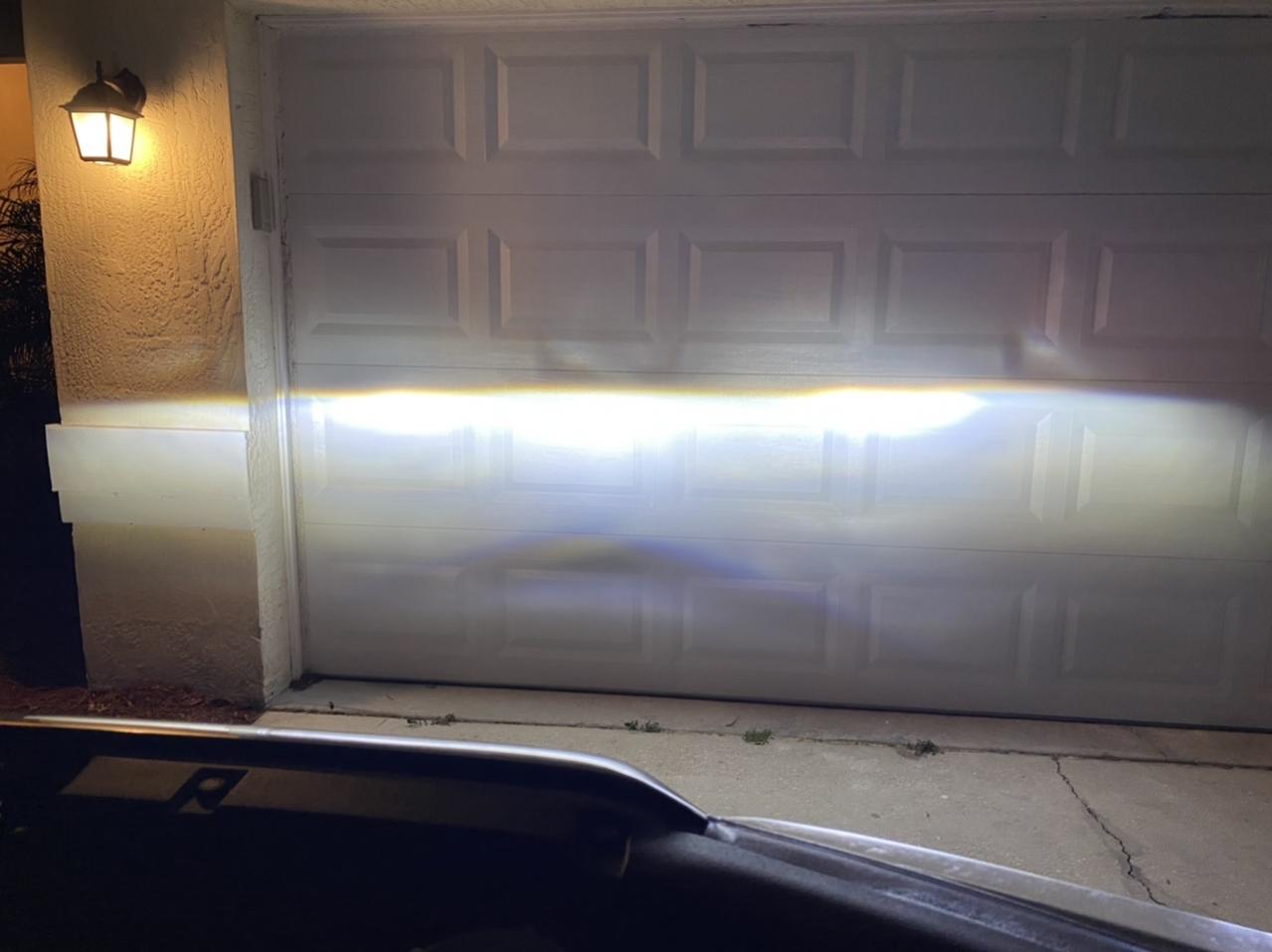

Can’t seem to get the drivers side to match passengers. Beam pattern looks the same, but the hot points in the 2 headlights are about 1.5-2inch different. Driver side is lower. Using Nineo II’s
It’s supposed to look like. The driver side beam will always be lower than the passenger’s so your not blinding incoming traffic...
