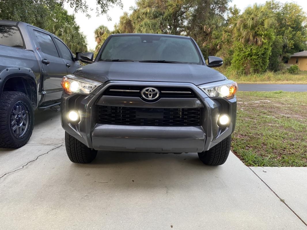

I tried a few LED kits but each would have dark spots or a broken beam pattern. I found the Katana works extremely well in my three 4Runner's. I get a really nice beam pattern, a good match to my OEM pattern with a much higher brightness and no dark spots. I agree with some other forum members - this bulb seem to match the Supernova V4's at a third of the price.
Installation in my 4Runner's was a bit tight, the cable and LED driver are a little larger than some other bulbs. I just took some time to try a few different ways of mounting and installing the LED driver behind the headlight housings dust cover. I found the best way to get everything to fit, was to connect the factory wiring to the LED driver and get it installed with the drivers base flat against the bulbs solid aluminum mounting block, then install the bulb and connect it to the driver.
I also decided to keep halogen's in the high beams because of the DRL flickering issue, I did replace the stock 9005's with 100W temperature matched bulbs that are super white and come close to the LED's.
Upgraded the fog lights with a inexpensive Alla Lighting 2800lm LED Fog Lights Bulbs set that seems to work well. I choose these because of the internal driver - time will tell if they hold up.
All in I am very happy with the results - far improvement over stock.

Yes, those are the LED fog light bulbs that I am running. Seem to be a nice match to the Katana low beams. Let me know how you like them after you get the installed.

I tried the Fahren bulbs also, I found the same as you not a great cut-off and a few dark spots, switching to the Katana bulbs was a very noticeable and positive change. Using the Alla fog bulbs with the Katana low beams, to me, provides a great coverage pattern, I think they work very well together.

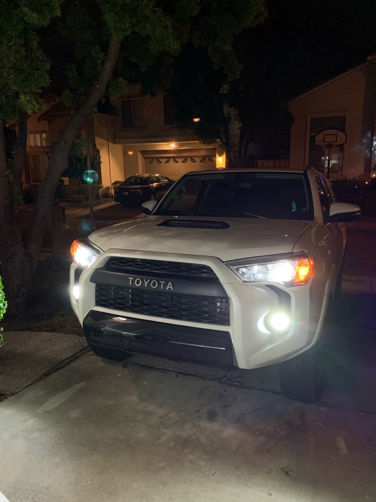

Here are the katana h11 I got. They are awesome. Very bright as drl and nice high beams. There’s some flicker as drl but barely noticeable.
