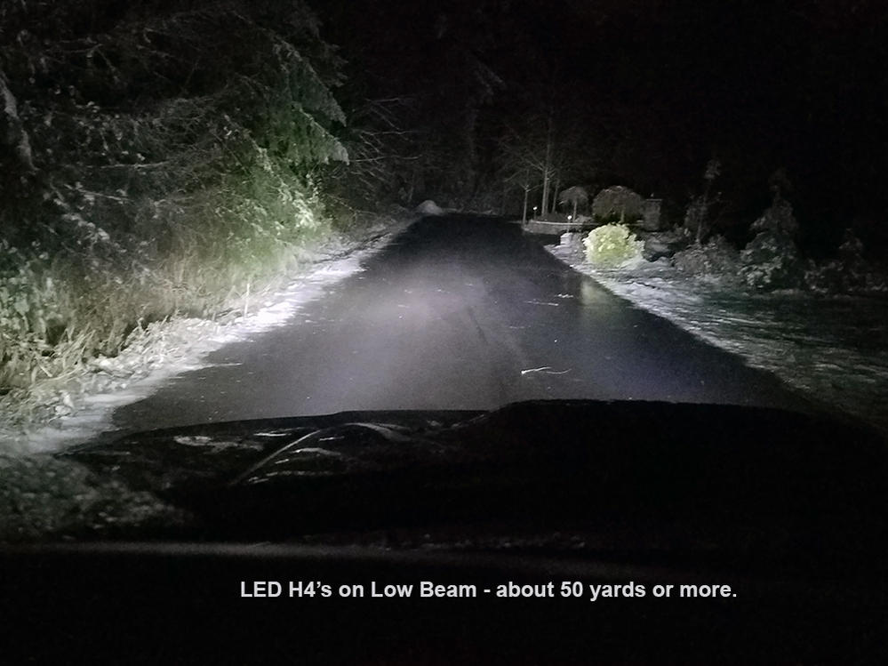

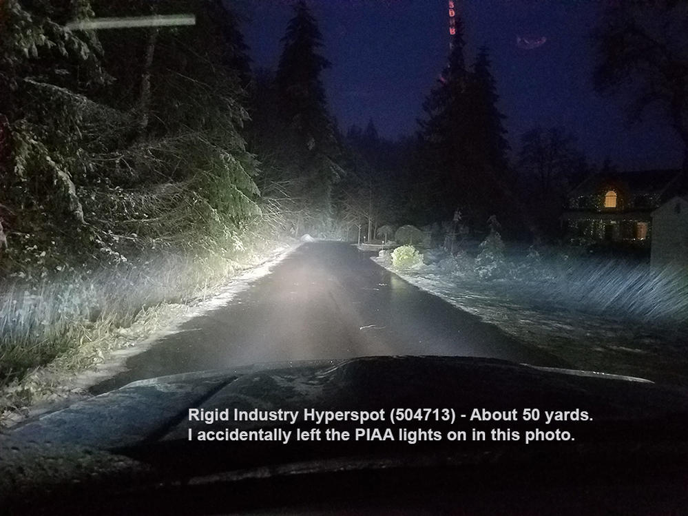

[MENTION=115347]gamefreakgc[/MENTION] I know you requested a photo. Here are two pics I took this morning. As you can see I still have the LED's in there but the swap is on the way this weekend.
My guess is I'm about 50 yards away. I did a comparison shot for you with the LED's and also the Rigid Industries Hyperspots. Ignore the PIAA lights that are on as they don't really add much to the light. They're regular H3 bulbs.
Good luck on your decision.
EDIT: the more I look at the bottom photo, the more inclined I am to believe I had all of my lights on, including the headlights.

I see what you mean about the beam patterns. They are bright but not always where you want them huh.

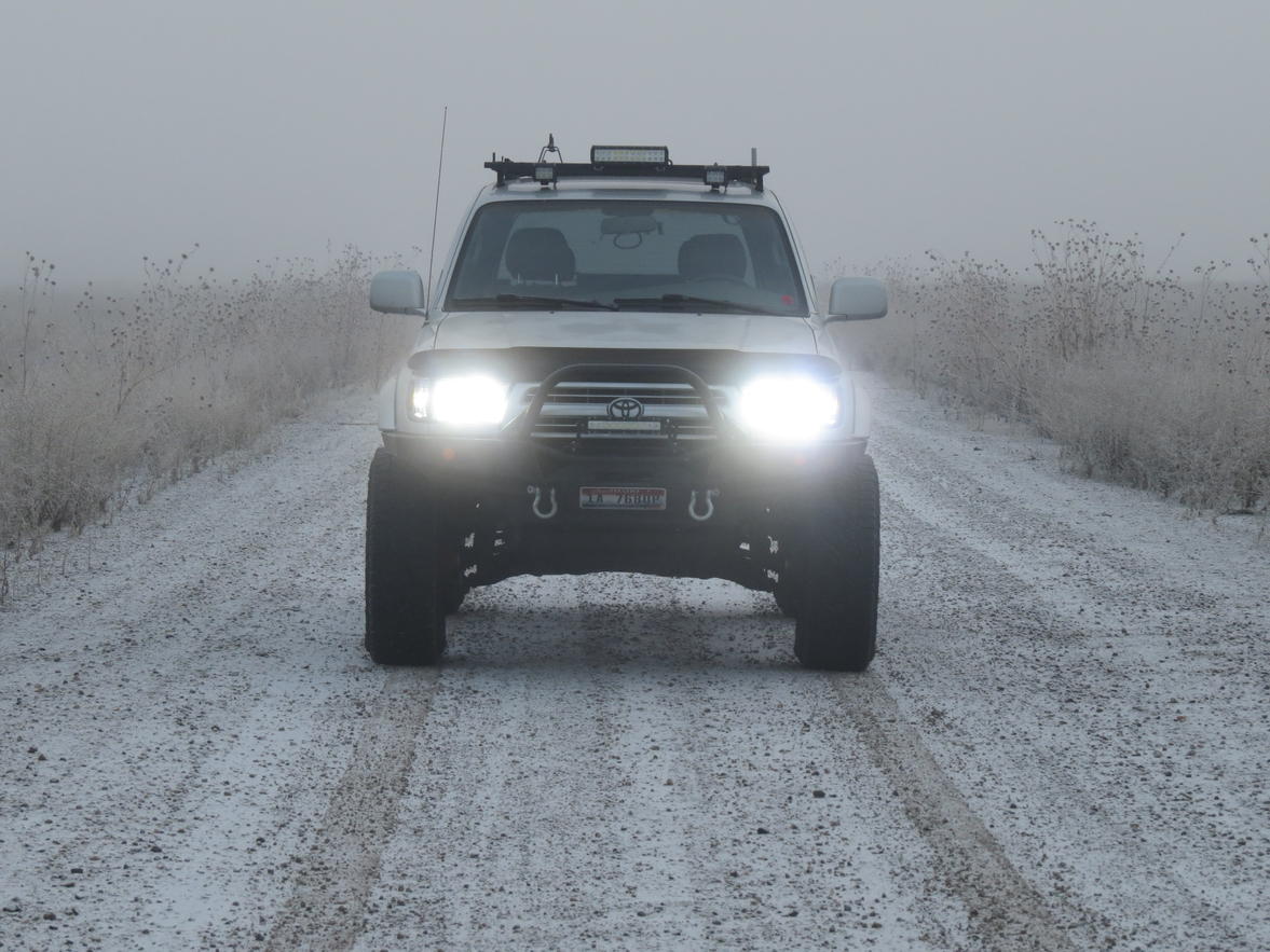

I live in Idaho and have been running the PIAA LED H4s for almost a year now. This is actually my first winter with them and I can’t really see that well when it snows or when we have inversions.You will definitely need to have some fog lights to see better in the fog and snow.
I just ordered Koito OEM dust boots and the OSRAM Night Breaker Unlimited to replace these for now. Maybe my eyes will see better in winter conditions with bulbs closer to 4000k instead of 6000k?
Pros:
Excellent customer service from Jason B and PIAA
Lights up anything with reflective properties really well
Material and build quality
Ease of installation
Cons:
Less effective in winter on 4Runners not equipped with fog lights (even more $$$)
Poor visibility in snow
Poor visibility during an inversion
Not DRL friendly
Cutting the dust boot
