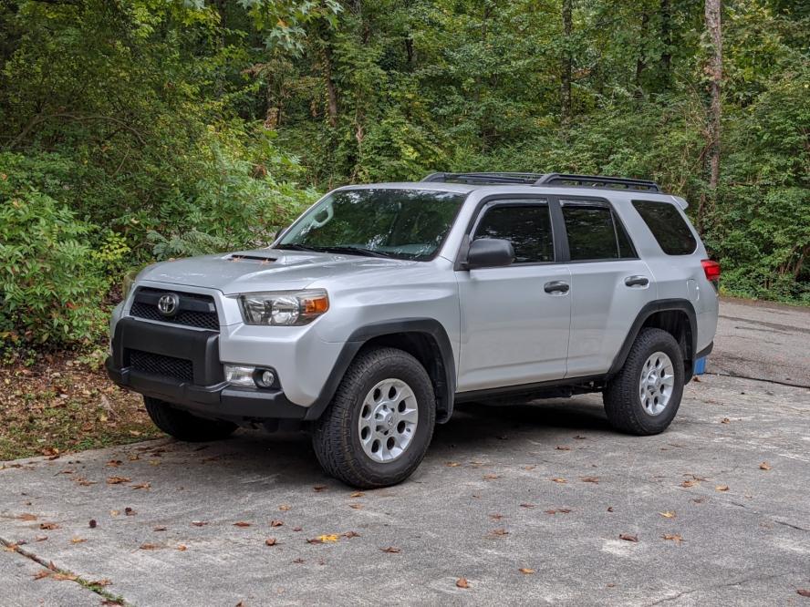

Good day eveyone. I have a new to me 2013 TE and I really like everything about the vehicle except the headlights. I would be interested in a retrofit or something similar but I am having trouble finding anything for the pre face lift 5th gens. Any help or guidance would be great!
Here is the old gal.
Your 13' low beams use the same H11 bulbs as all the newer 5th gens. If you ever need to find bulb part numbers the link below is super useful.
| SYLVANIA Automotive
For replacement options you can get any H11 bulb / kit in Halogen, LED, or HID. You can also convert to H9s which seams more trouble than its worth to me...
Im running H11 HIDs w/ Ballasts and like them so far. For the ballast you will have to drill through your dust covers and install the ballast in the engine bay.
