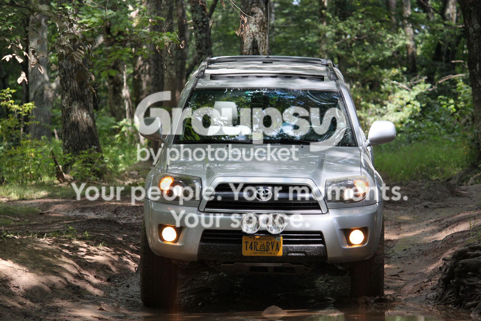

running hella 500ff driving lights and auxbeam 3" lights on the a pillar
20151206_125210_zpsciisibtt.jpg~original
IMG_20151206_125336_zpsn4qor7va.jpg~original
g0aVrLO_zpsmhgyhvjy.jpg~original
20151205_202445_zps48i95kjk.jpg~original
