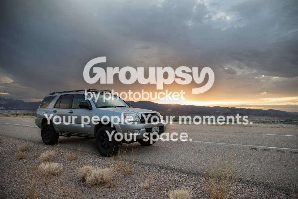

Here is what I did to mount my led light bar was make my own bracket off the roof rack.
I took some angle iron and drilled 2 holes in it. Then I took some bolts that fit inside the roof rack rail (I think 19mm head, or 13mm x 1.25) , and bolted it to that on both sides.
Then I took some 1" box steel and made a crossmember across the front. Then you have a perfect place to bolt your light bar onto, without drilling anything into the body of the car. And the best thing about this is that you can remove it, and slide it back and forth in the slot to help aim the light and reduce windshield glare from the light.
Here is a picture of my bar (If I can get it to work... haha)
M___2457_zpse4d03cd9.jpg~original
In that pic, you can kinda see the bar sticking out from the racks.
