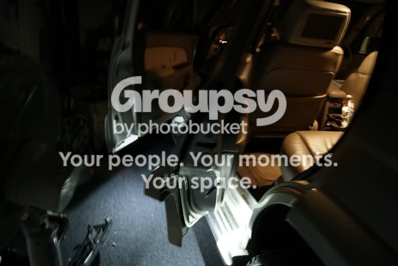

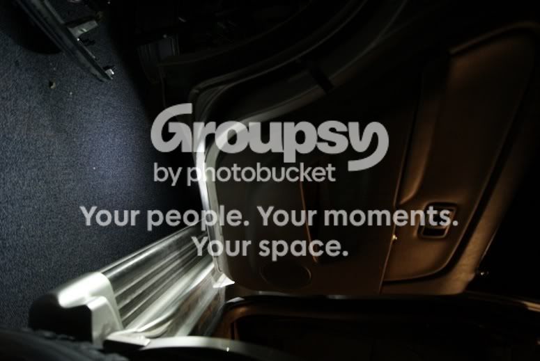

Just thought i would share my most recent mod...simple but it did take me longer than i thought.
Decided to do this after I saw how much it helped when getting out of other cars when you can't see whats on the ground.
Using 5 way led lights (one led points at ground and 4 others point sideways) that i had laying around after i changed the lights in my instrument cluster.
Basically im giving 12v always to the led and using the switched ground from the door switch to supply the ground to the led.
sorry pics look blurry.
_DSC2223small.jpg~original
_DSC2222small.jpg~original

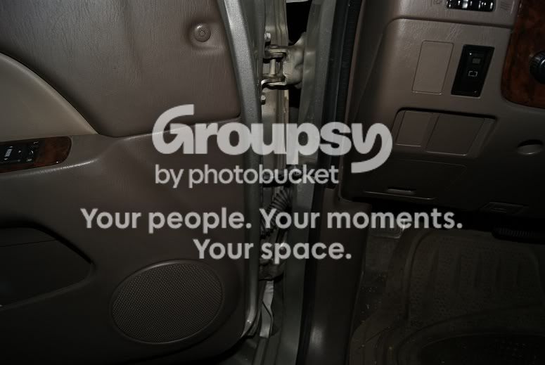

FRONT DOORS
Remove the door panels...I assume there is a write up for this somewhere.
Using a volt meter you should find that the blue wire in one of the connectors is “always on” 12v (this is true of both drivers and front passenger's door) use this for 12volts.
Snake a wire into the door through the umbilical cord ( I found it easier to unplug the two connectors that go to the door from behind the drivers door kick panel or passenger’s kick panel, straighten out the accordion part then shove the wire through). Use electrical tape or zip ties to route the wire along with the other wires. Connect the other end of the wire to the door switch.
_DSC2228small.jpg~original

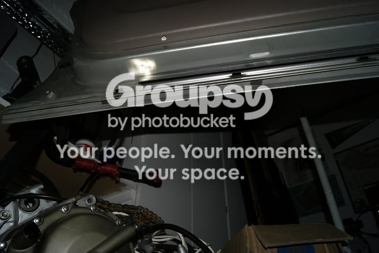

Drill a hole in the bottom of the door in one of the slight recesses (see the pic below) that are along the bottom of the door, this will give you slightly more clearance between the led and door frame. The hole should be large enough to allow you to insert the base of the led, I used 194/168 bulb called WLED-x5 from (Super Bright LEDs - Miniature Wedge Base Bulbs). Whatever led you choose make sure it will fit when you close the door. I am not sure how much clearance there is but I know these don't hit the door frame when the door is closed. If you use the same leds as I did then the hole should be 3/8”.
_DSC2226small.jpg~original
To keep the leds in place I epoxied them then put silicone around the bulb to waterproof it.
